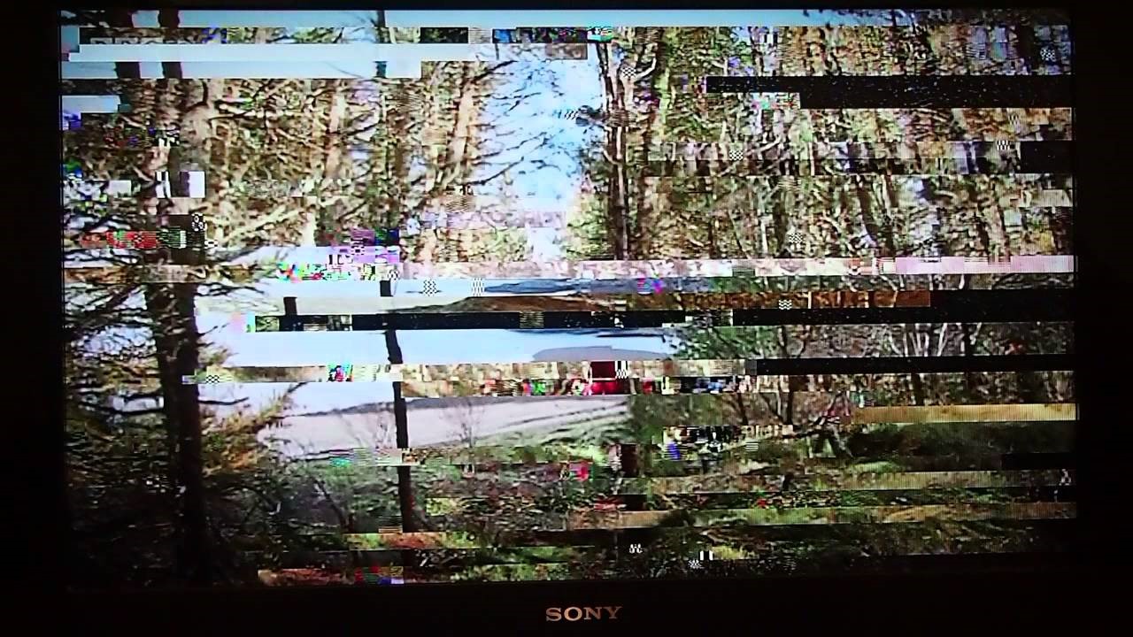

  • Pixelated Video
    Poor reception can cause a video to pixelate, glitch, break up or become blocky. This can happen on both live and recorded video.

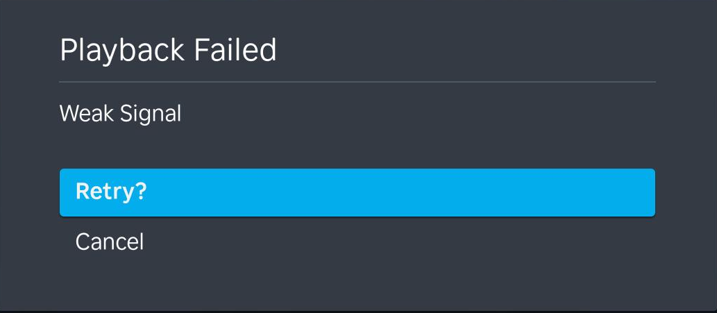

  • Failure to Play Live TV
    Poor reception can increase errors in the live video stream delivered from your antenna, through your Tablo, to your viewing device. When Tablo's player software encounters too many errors, a 'playback failed' error message will be shown. If the issue is temporary, selecting 'retry' may get you back to your show. If not, you may have to cancel and attempt some of the troubleshooting steps below.

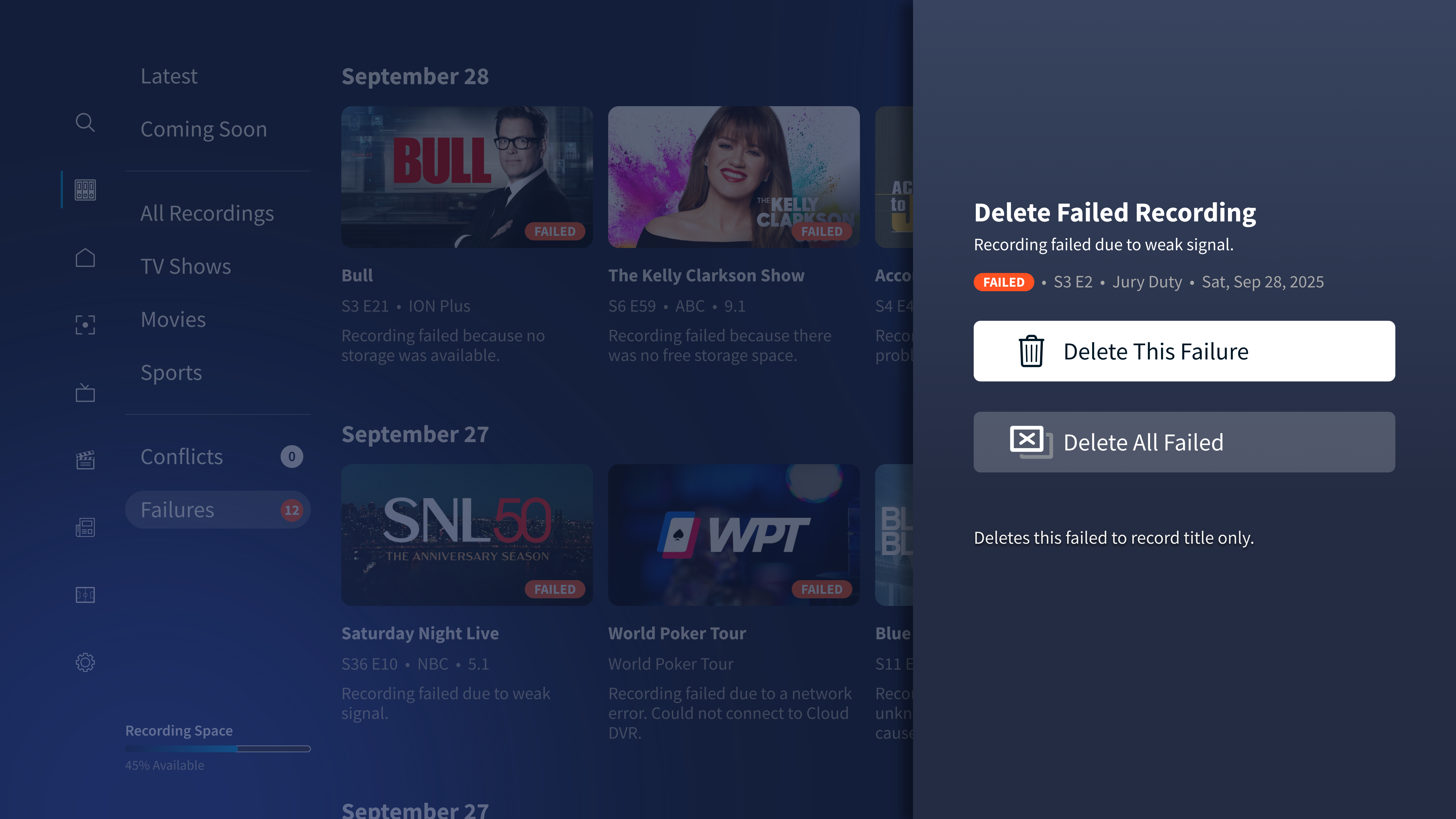

  • Partial or Failed Recordings
    If your Tablo is unable to get a signal lock when a recording is set to start, the recording will be marked as 'failed' in your library. If you find many of your OTA recordings are missing segments of video or are shorter than anticipated, this can also be a symptom of a reception issue.

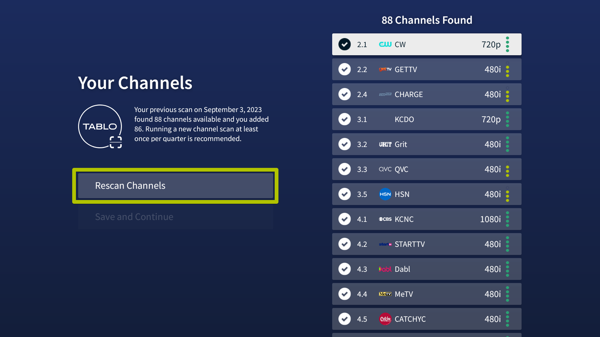

  • Antenna TV Channels Missing In a Channel Scan
    A channel with no or very poor reception during a channel scan will not be displayed in the scan results. If you are missing a local channel you expect to receive after a channel scan, look for clues to the source of the issue, make adjustments and scan again.

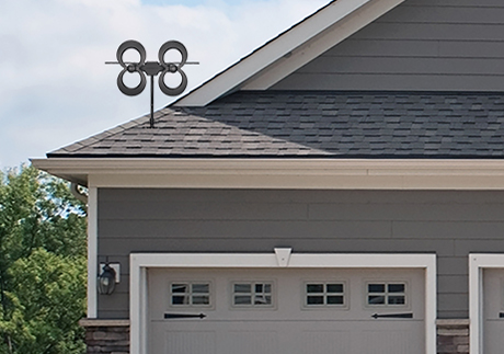

  • Adjust Your TV Antenna’s Location
    The best location for your TV antenna is as high up as possible, facing your local broadcast towers. (Not sure where yours are located? Click here.) For indoor TV antennas, a top-story window is ideal. For outdoor antennas, try your roof or balcony. Avoid obstructions like trees or brick walls.

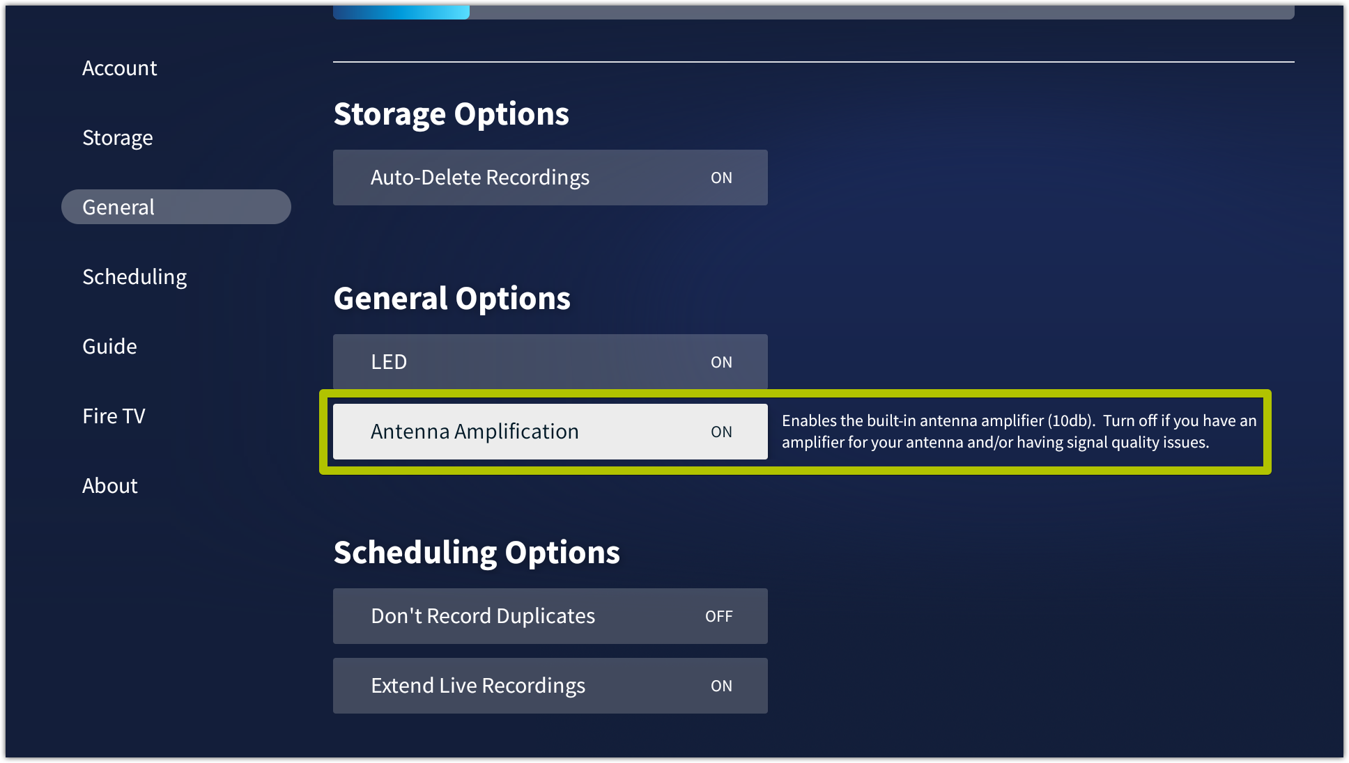

  • Disable Tablo’s In-Line Amplifier
    Your Tablo can actually get too strong of a signal from your TV antenna. If you live very close to the local broadcast towers or are already using an amplified TV antenna, turning off the 4th Generation Tablo's in-line amplifier can help.

  • Scan After Any Change
    If you change anything with your antenna setup, conduct a new channel scan. As the signal strength indicators on your Tablo are not dynamic, a rescan will reveal whether your tweaks were successful or not.
  • Plan to Scan Quarterly
    Run and save a new channel scan at least once every three months, even if your antenna reception is solid. This will allow your Tablo to discover new channels available in your area as well as any other changes that may have occurred.

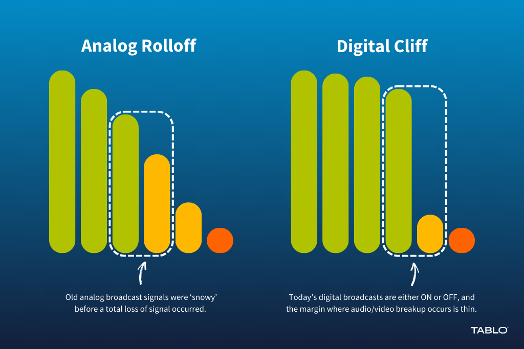

The Digital Cliff: The Science of Over-the-Air TV Reception
Unlike analog TV, there’s no middle ground with today’s digital OTA TV signals, where the picture is ‘fuzzy’ or ‘snowy’. As digital signals are either ON or OFF, there is very little margin between a good signal and no signal at all.
If a signal is too weak and falls off the 'digital cliff', your Tablo simply won’t receive it.
In rare cases, a channel’s signal can be strong enough to receive when the antenna is connected directly to your TV but not the Tablo because of the digital cliff effect.
Unlike your single-tuner television, your Tablo has multiple tuners (either two or four) so that you can watch and record multiple shows at the same time.
The downside is that the antenna’s signal strength is split between the tuners in the Tablo, leading to a small drop in strength. Tablo uses amplified splitting technology to mitigate this loss, but if the signal is on the edge of the digital cliff, it could be enough to push it over.
