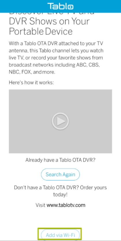

Select Add Via WI-FI.

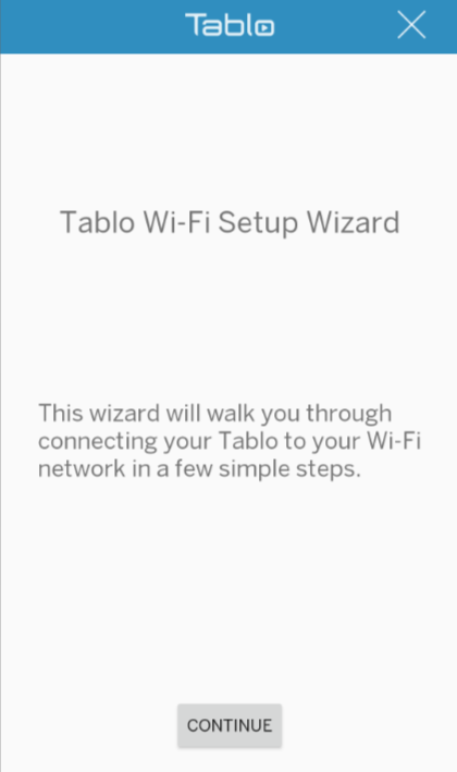

Hit CONTINUE to start the Wi-Fi setup.

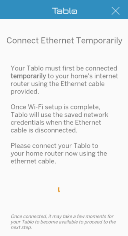

You will see the following screen, confirming the Tablo is connected to Ethernet.

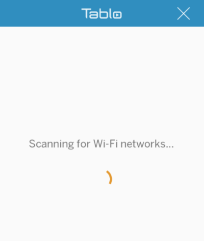

Your Tablo will search for nearby Wi-Fi networks. This may take up to 1-2 minutes.

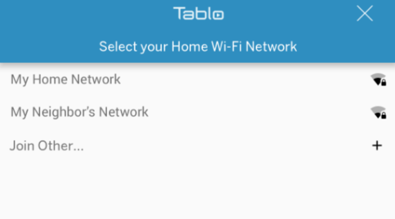

Select your home Wi-Fi network from the list. This is the network your Tablo will join.

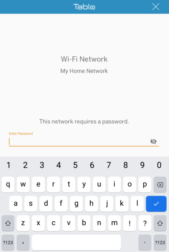

Once you have typed in your password, hit enter to continue.

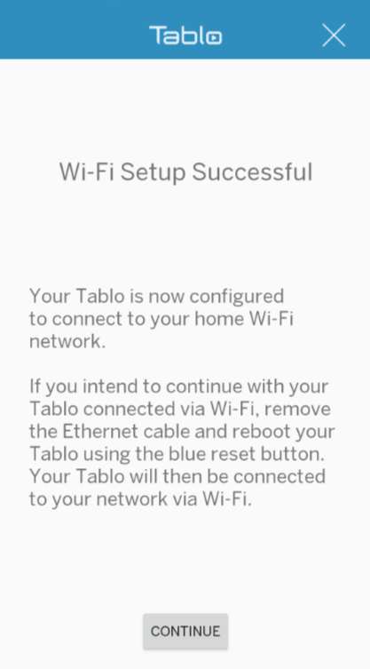

If the Tablo is successful in joining the Wi-Fi network, the screen below will be displayed. From here, remove the Ethernet cable from the Tablo and place the Tablo in its permanent location.
