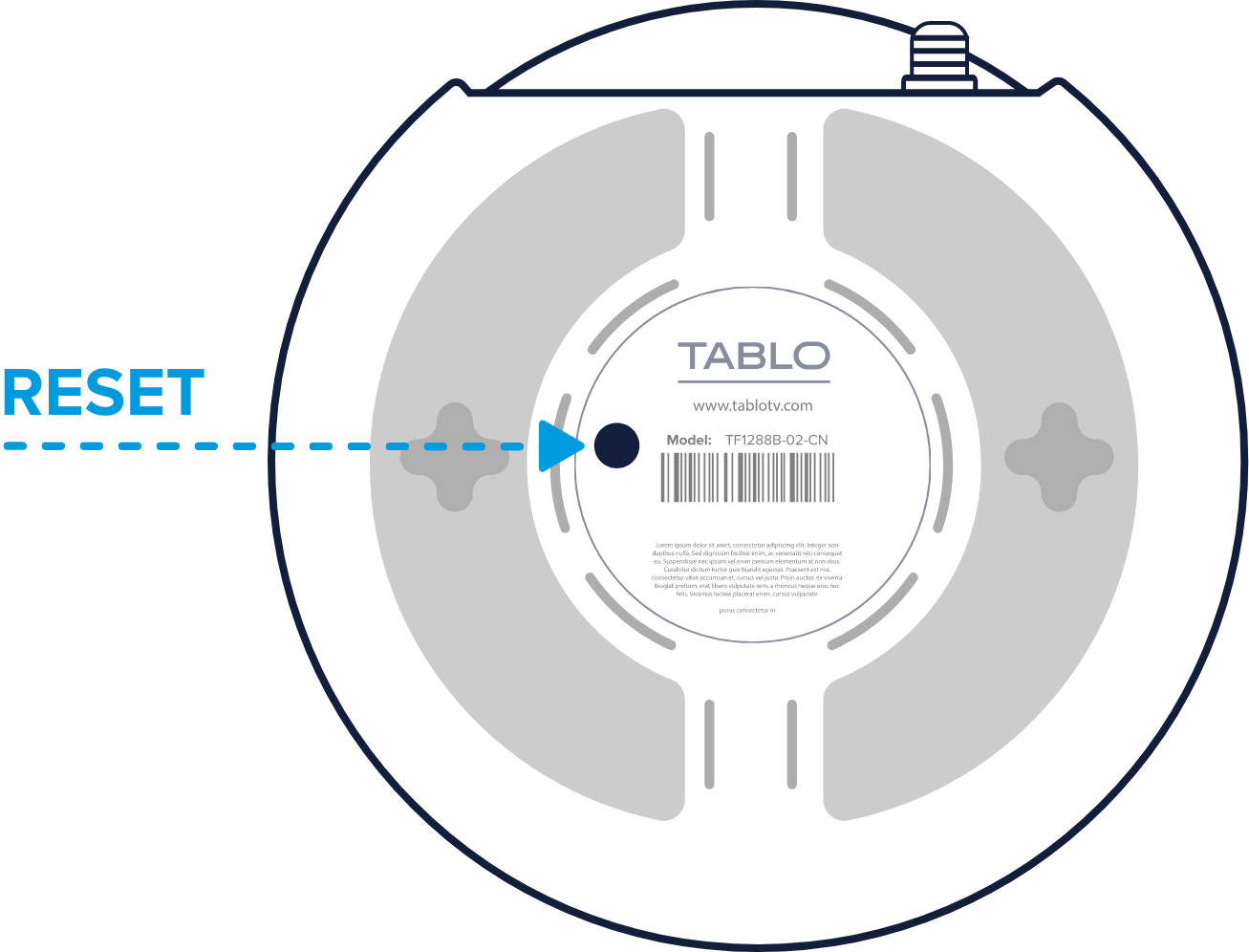

For legacy network-connected Tablo models, the blue reset button is on the back right of the device. Use this article for links on how to access Wi-Fi settings on other legacy Tablo devices.
If you want to switch from Ethernet to Wi-Fi, first remove the Ethernet cable from the 4th Generation Tablo and then reboot it by quickly tapping the reset button on the bottom.
The Tablo will then boot into Wi-Fi setup mode. Complete the Wi-Fi setup process on your iOS or Android tablet or phone.
If your Tablo has connected to a different Wi-Fi network in the past, it may be stuck with the old Wi-Fi settings. When this happens, your app won't be able to find your Tablo. If this is the case, let the Tablo sit idle for for 5 minutes. At this point, its blue LED should begin pulsing blue indicating it's ready to be added to your WiFi network. From here, you can launch the Tablo app.
If you want to switch from Wi-Fi to Ethernet, attach one end of the Ethernet cable to your home's Wi-Fi router and the other to your 4th Generation Tablo. Next, quickly tap the reset button on the bottom of the Tablo. Wait for the blue LED to stop flashing. Once the blue LED is solid, your Tablo is now online and using the Ethernet connection.
