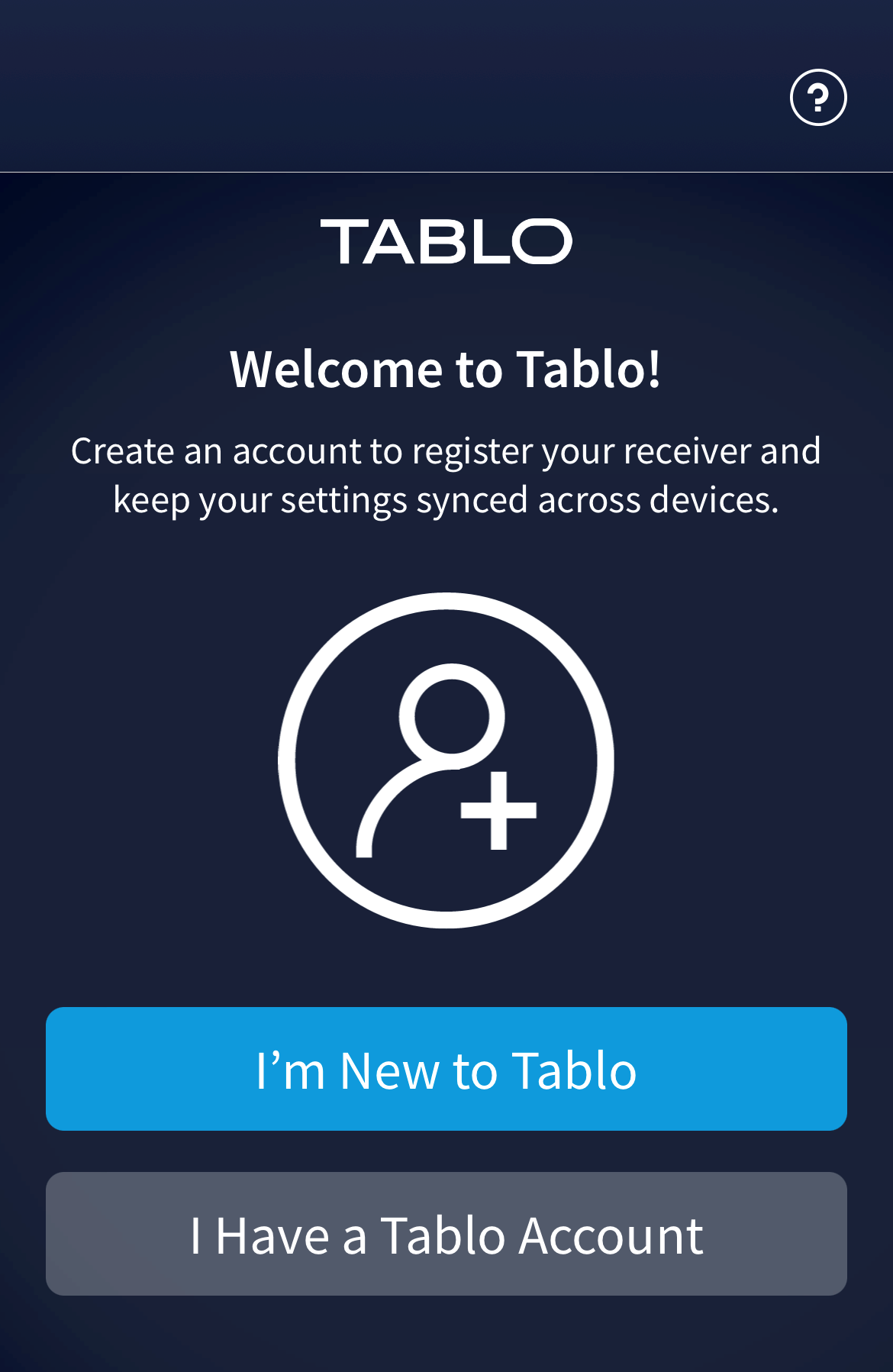

Set Up a Tablo Account
You'll need a free Tablo account to register your Tablo. This is not a paid subscription service.
The app will walk you through the process. For detailed instructions, go here.

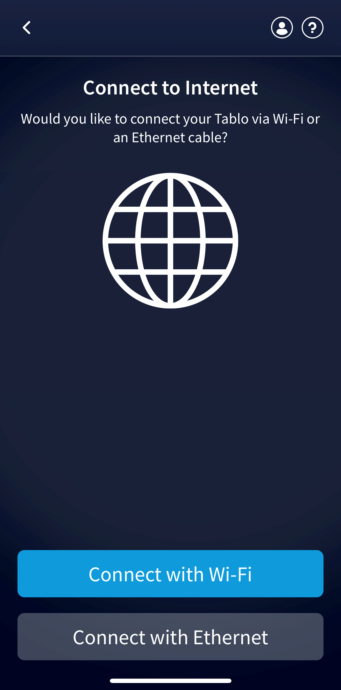

You'll be asked if you would like to connect your 4th Gen Tablo to the network using Wi-Fi or Ethernet.
In practice, an Ethernet connection is easier to set up, faster and offers more stability than Wi-Fi. If your router has a free Ethernet port and you have a cord long enough to connect your Tablo, we recommend hardwiring your Tablo to your router. Otherwise...
Select CONNECT WITH WI-FI.

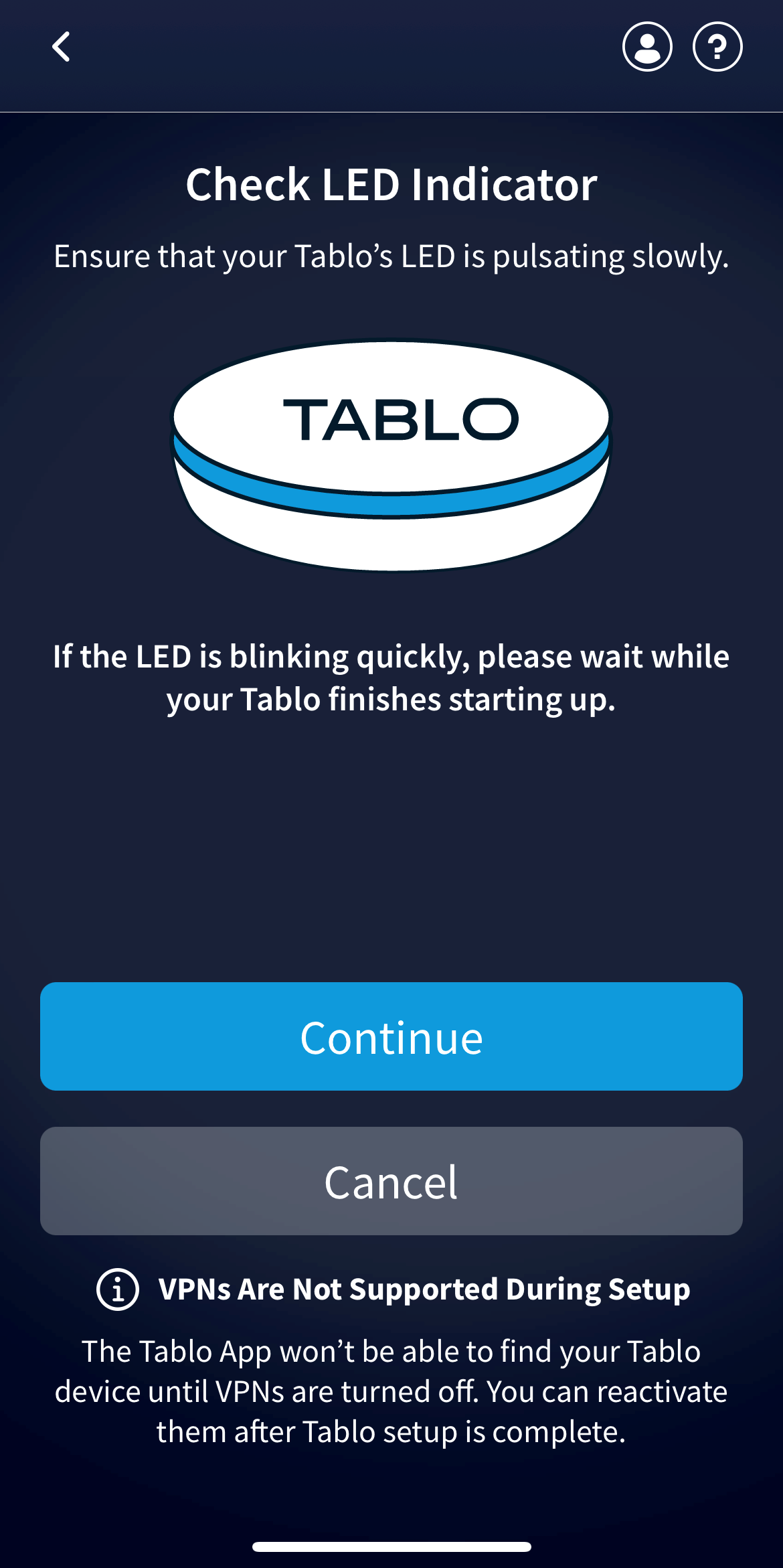

Check LED Indicator
As long as your Tablo does not have an Ethernet cord attached, its blue LED should pulse slowly. Look at your 4th Generation Tablo to verify this.
Once you have confirmed this, select CONTINUE.
You'll see a warning that your iPhone, iPad or home network should not be connected to a VPN. If it is, you'll need to disable the VPN until the setup is complete. You also should disable your VPN whenever you're using your Tablo.
If you don't use a VPN, or you've disabled it, you can select CONTINUE.

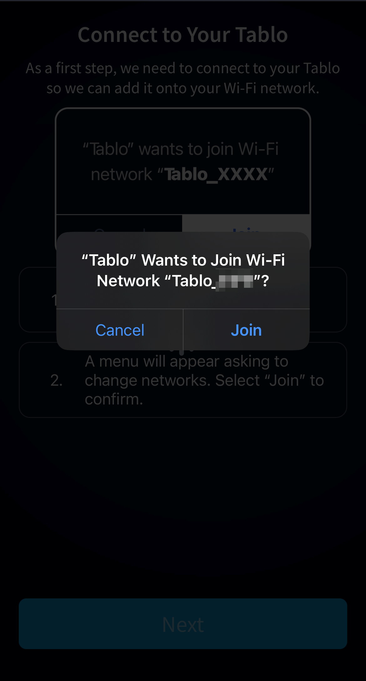

Connect to Your Tablo
The app will search for your Tablo. It will show up with a name like Tablo_XXXX. This can take a few minutes. When the Tablo appears, select JOIN.

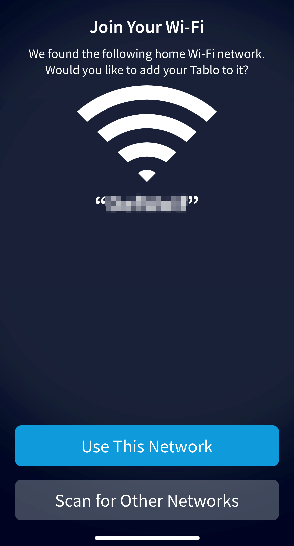

Join Your Wi-Fi
Once your iOS device has connected to your Tablo, you should see your home network’s name listed on the screen. Select it and wait for the password prompt.
If you don't see it, your network name might be hidden.

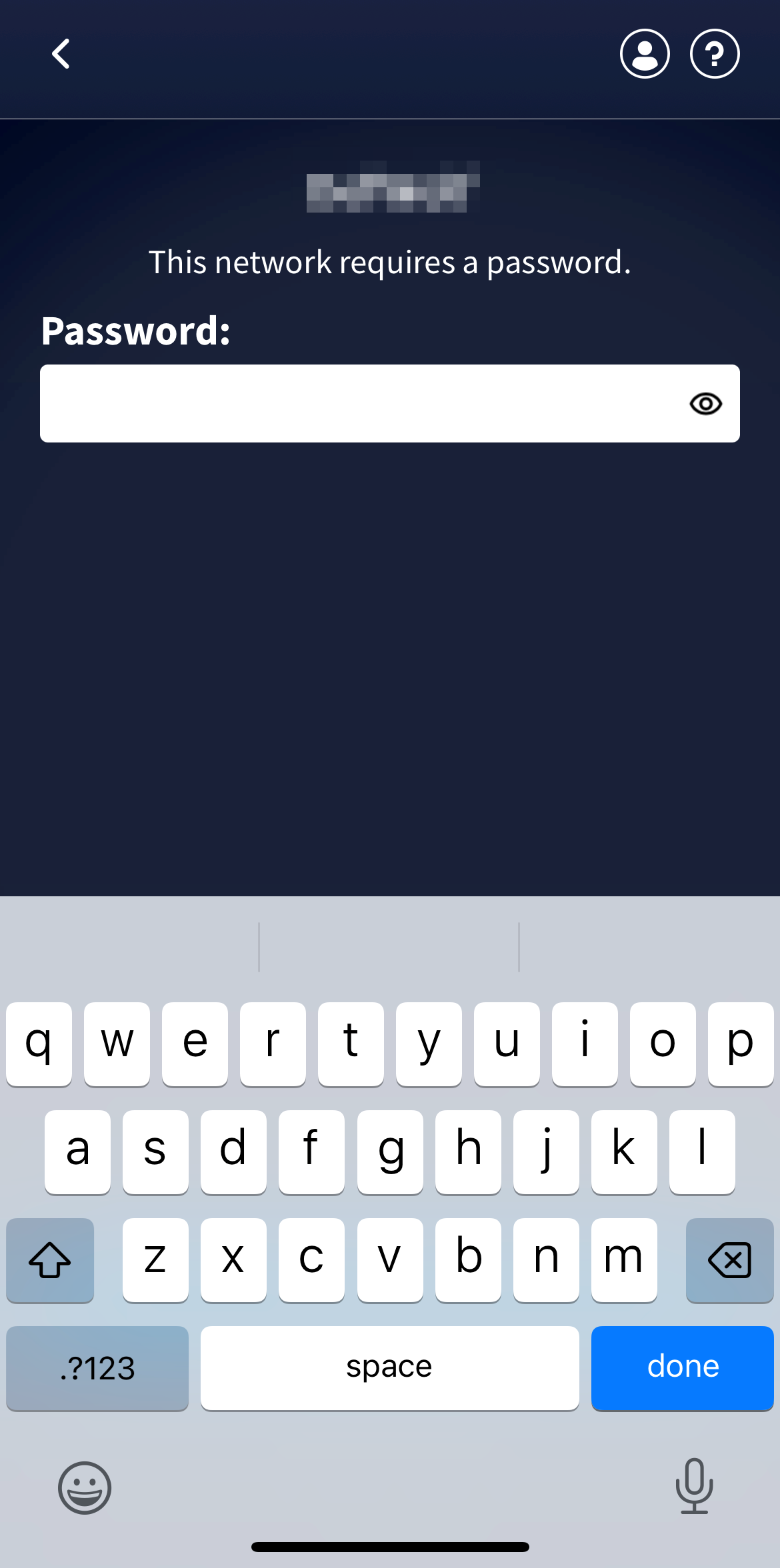

Enter your password and select SUBMIT

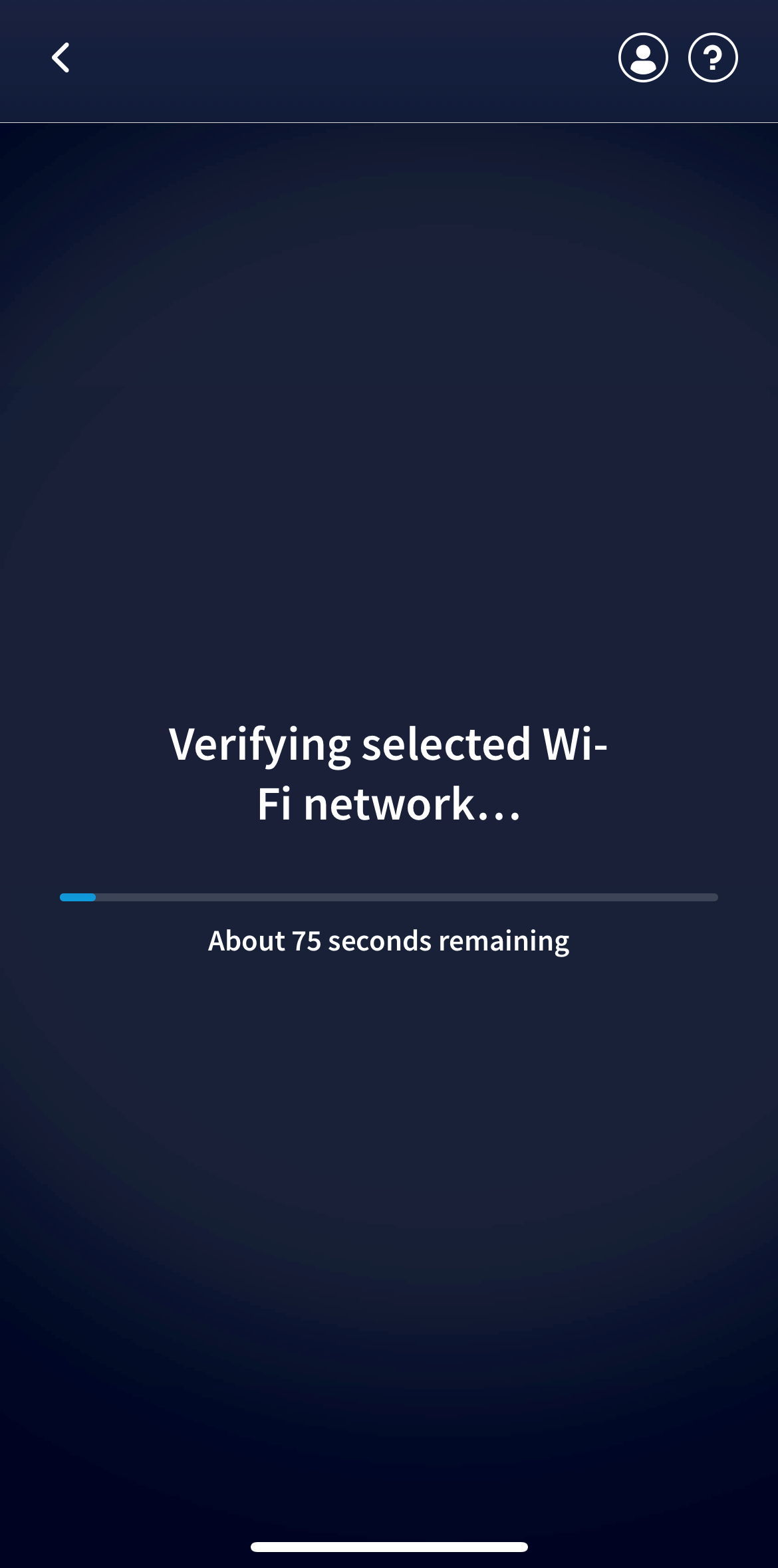

The Tablo will now attempt to connect to your home Wi-Fi.
Once your Tablo has successfully connected to your Wi-Fi network, its blue LED will stop pulsing and turn solid. At this point, the Tablo application will guide you through the rest of the setup process. Follow along here.

    When you enter the Wi-Fi password in the Tablo app, click the eye icon on the right side of the text box to reveal what you're typing. This will allow you to ensure your password was entered correctly.

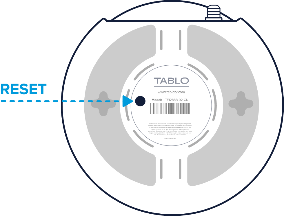

    Try rebooting your Tablo. Quickly press and release your Tablo's reset button on the bottom of the unit. The LED will pulse very quickly. Once the blinks slow, you'll be ready to try setting up your Wi-Fi connection again.
    DO NOT hold down the reset button for more than a second or two. Holding it for too long will force the Tablo to Factory Reset. Only Factory Reset if you're comfortable starting from scratch with no recordings.
