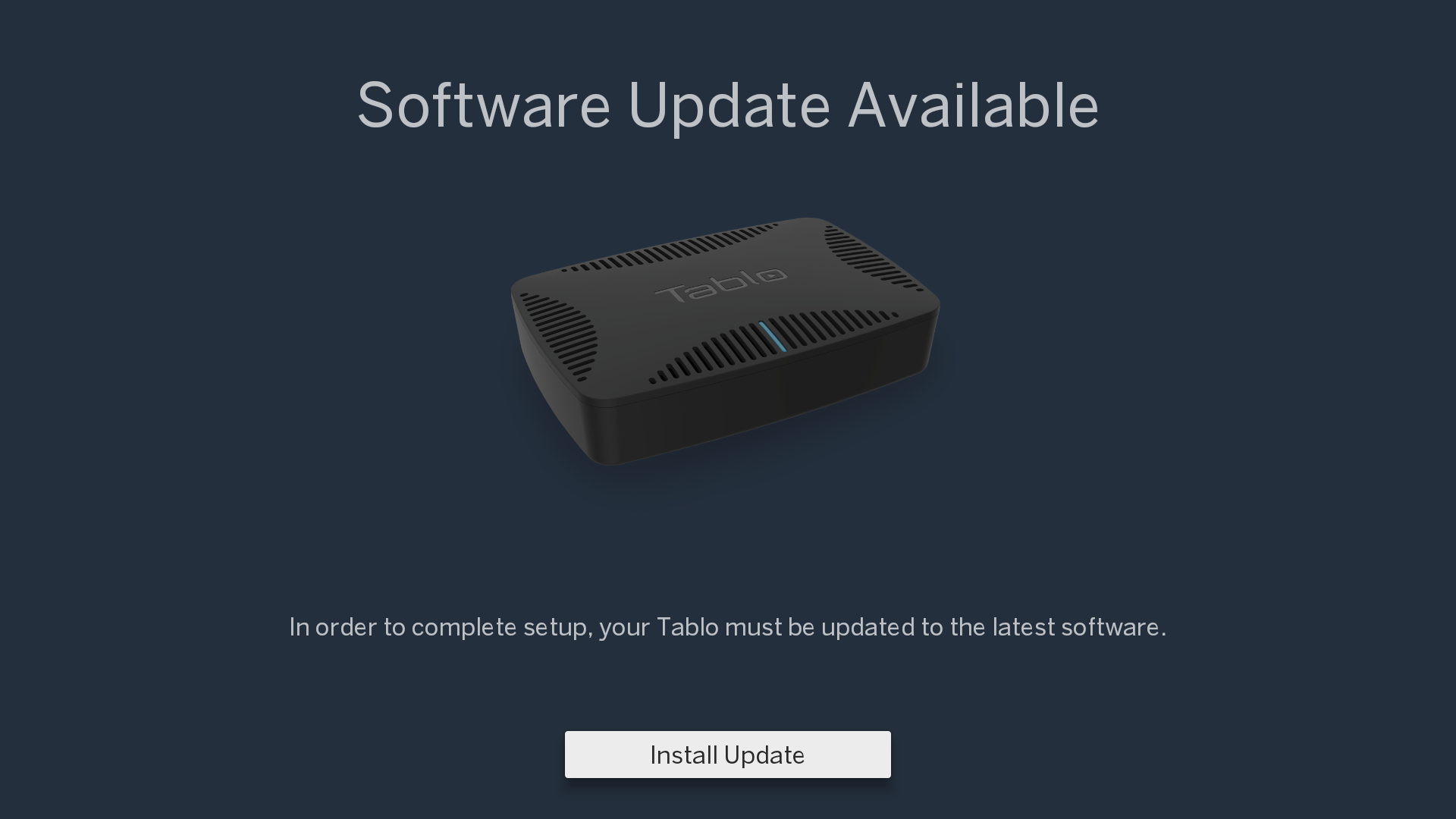

2. Process Firmware Updates if Required
This will ensure your Tablo is running the latest and greatest firmware version.

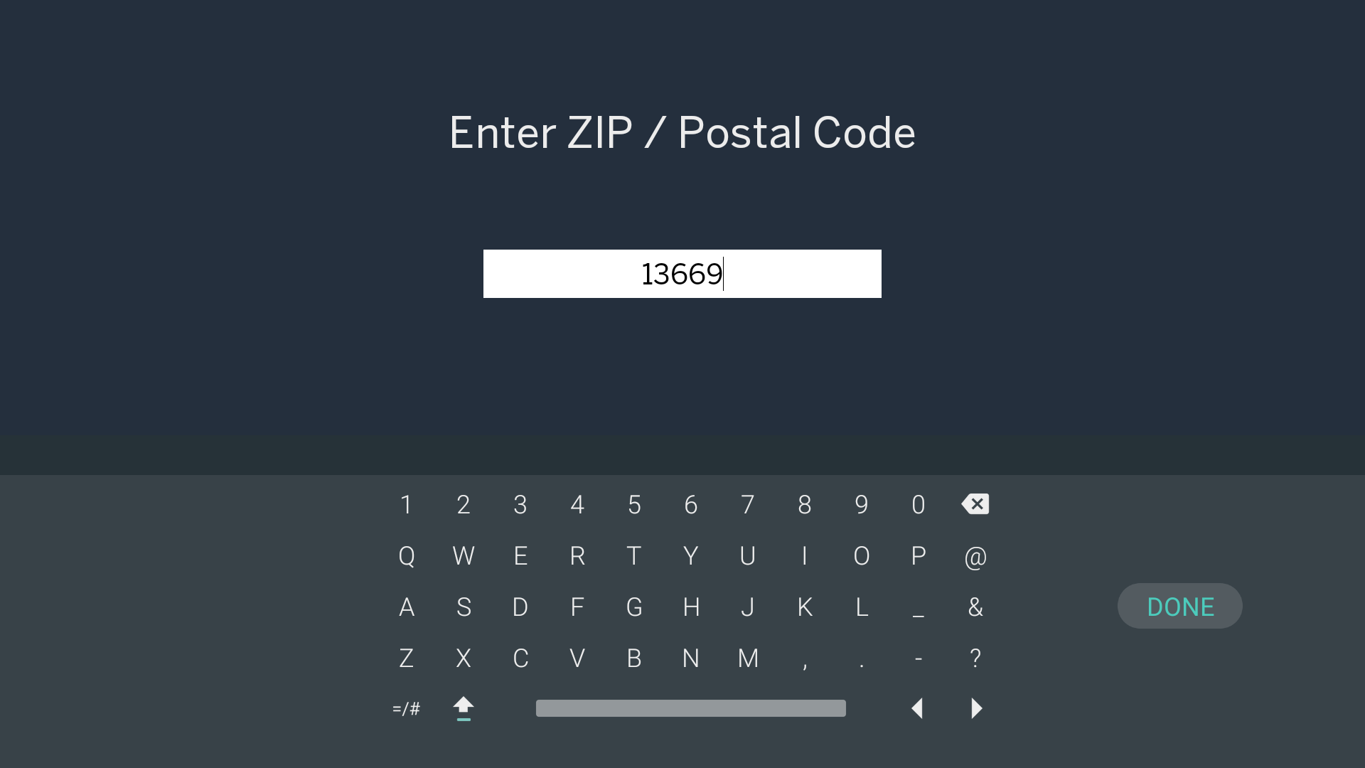

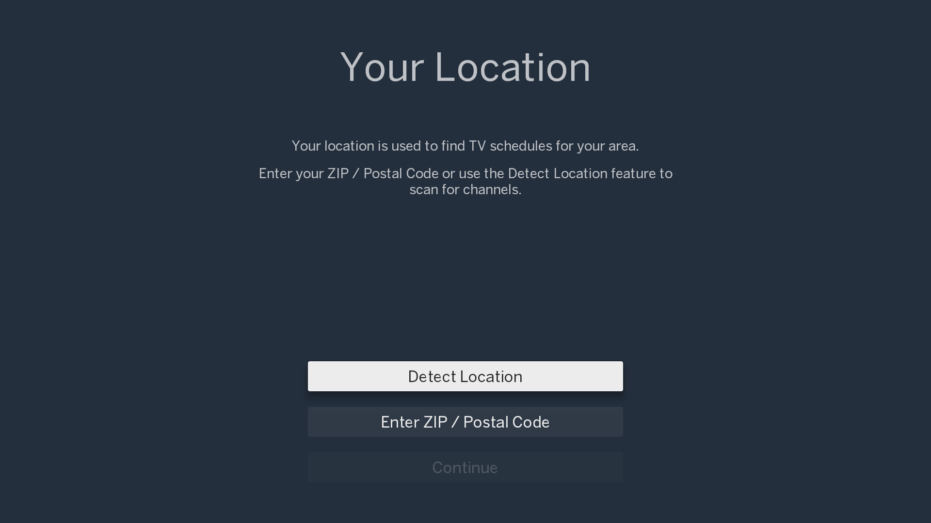

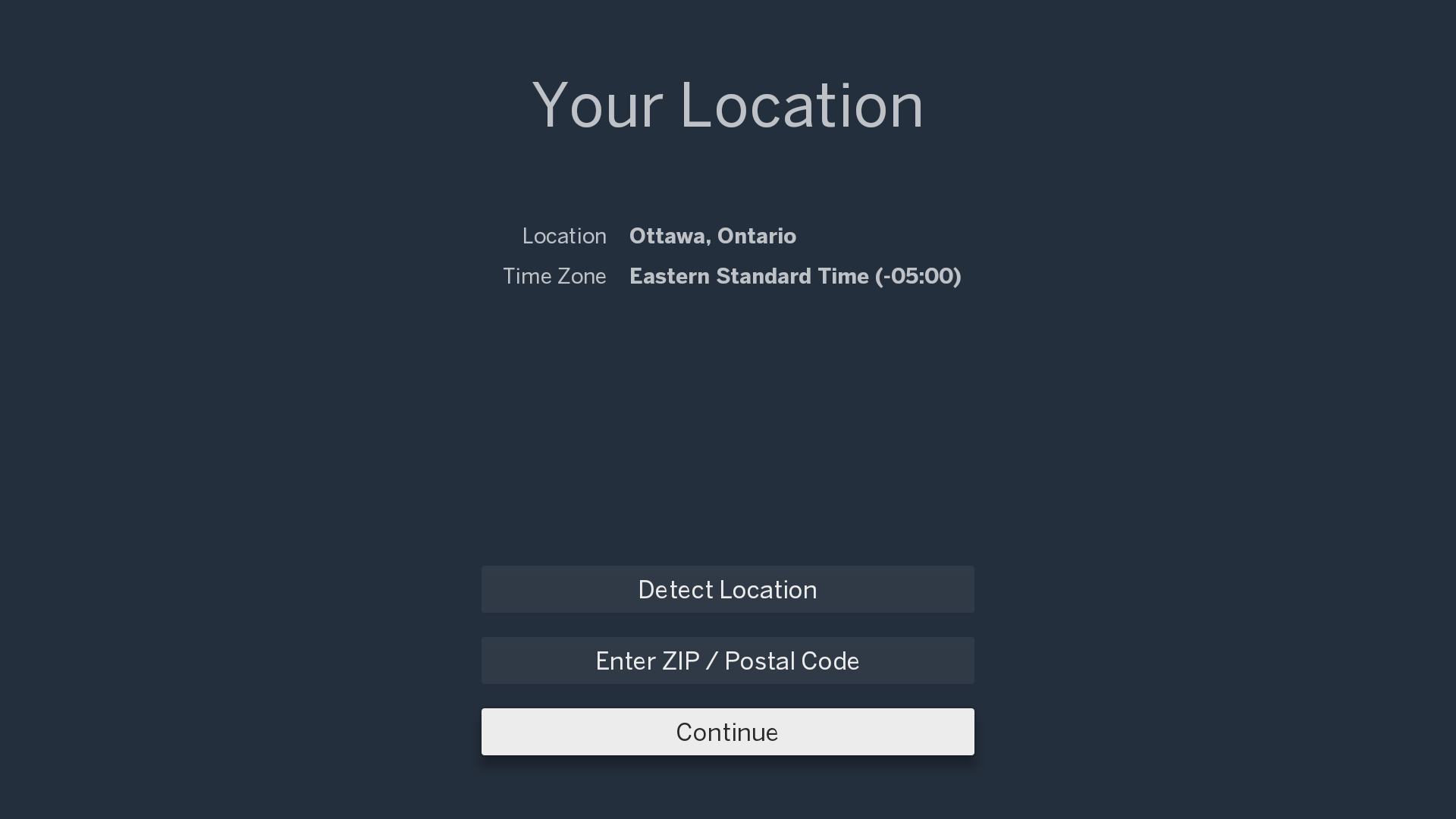

4. Select & Confirm Your Location
Location data is used to provide the correct TV Guide Data for your area.
Depending on your location, you'll be asked to enter a ZIP or POSTAL CODE.

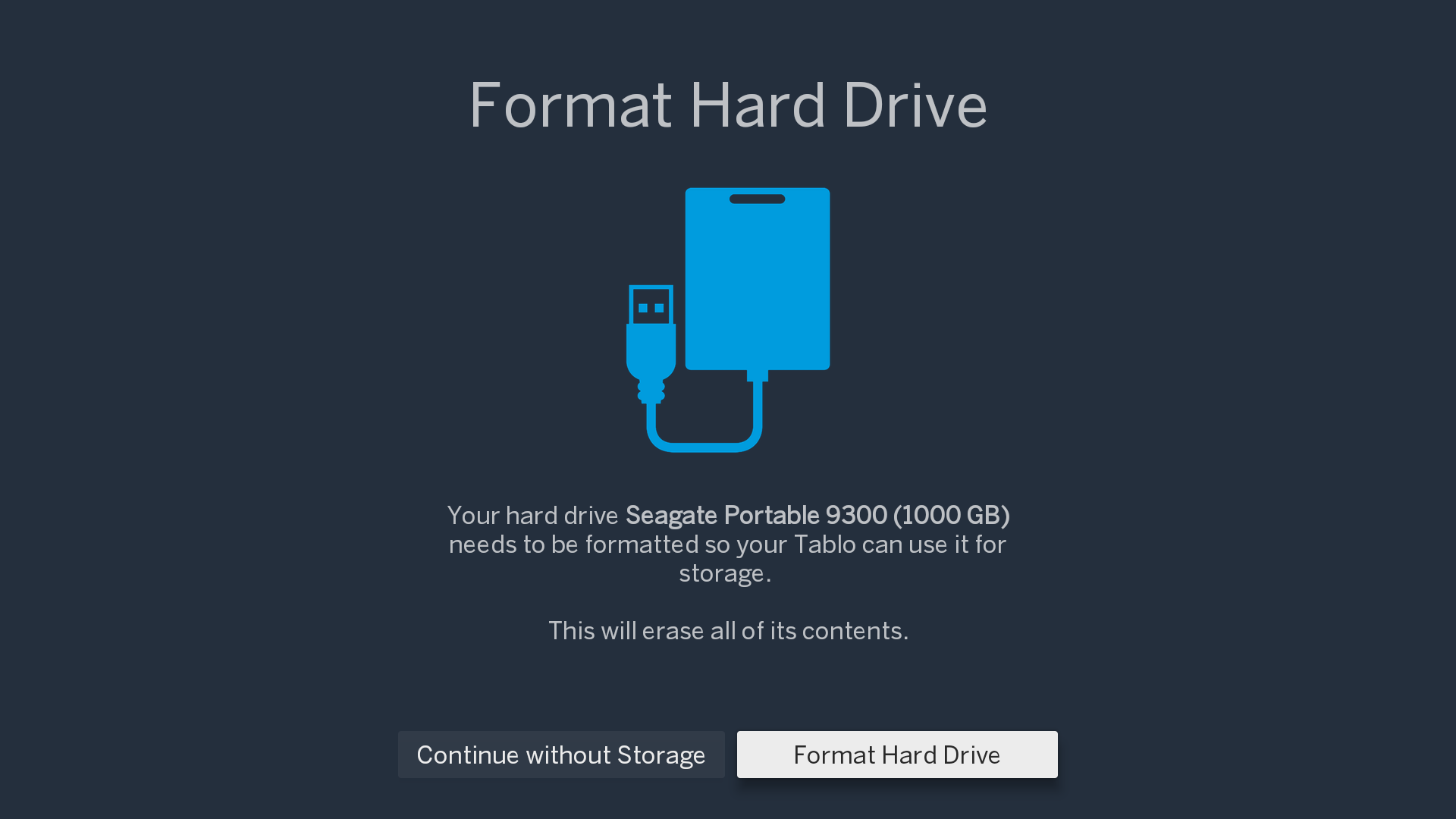

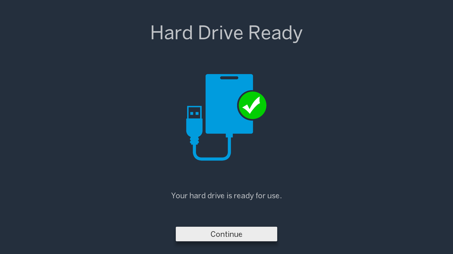

5. Ensure You've Connected a Supported Recording Storage Device
If your Tablo does not come with onboard storage, a supported form of recording storage must be connected. For required storage specs and recommendations for your Tablo, go here.
6. Format Your Recording Storage
Tablo will then format your recording storage for use with Tablo. This will erase all data on the drive, including partitions.
Formatting a brand new drive should only take a few seconds. Formatting a previously used drive will take a bit longer (between 30-90 seconds depending on the size).

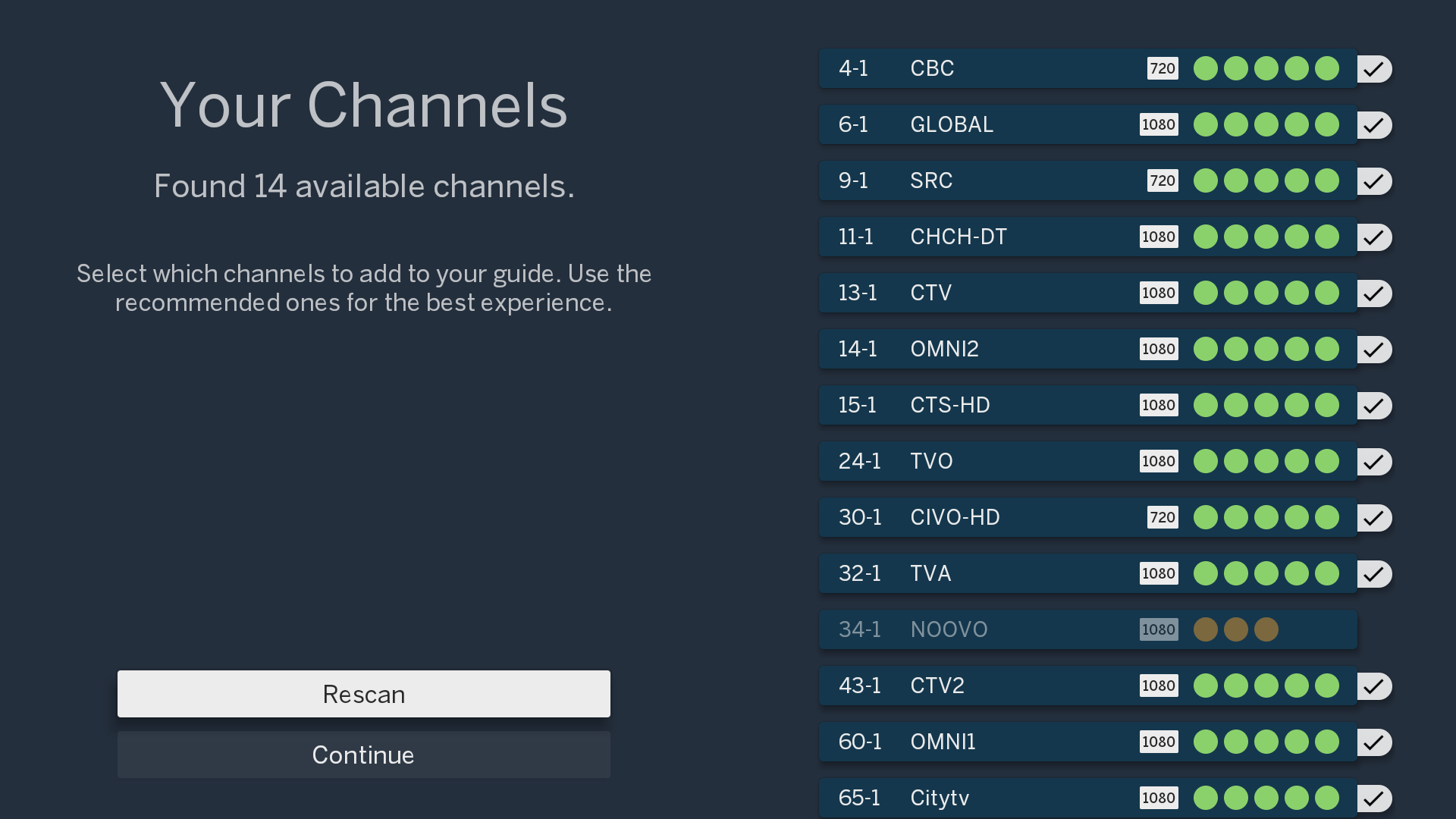

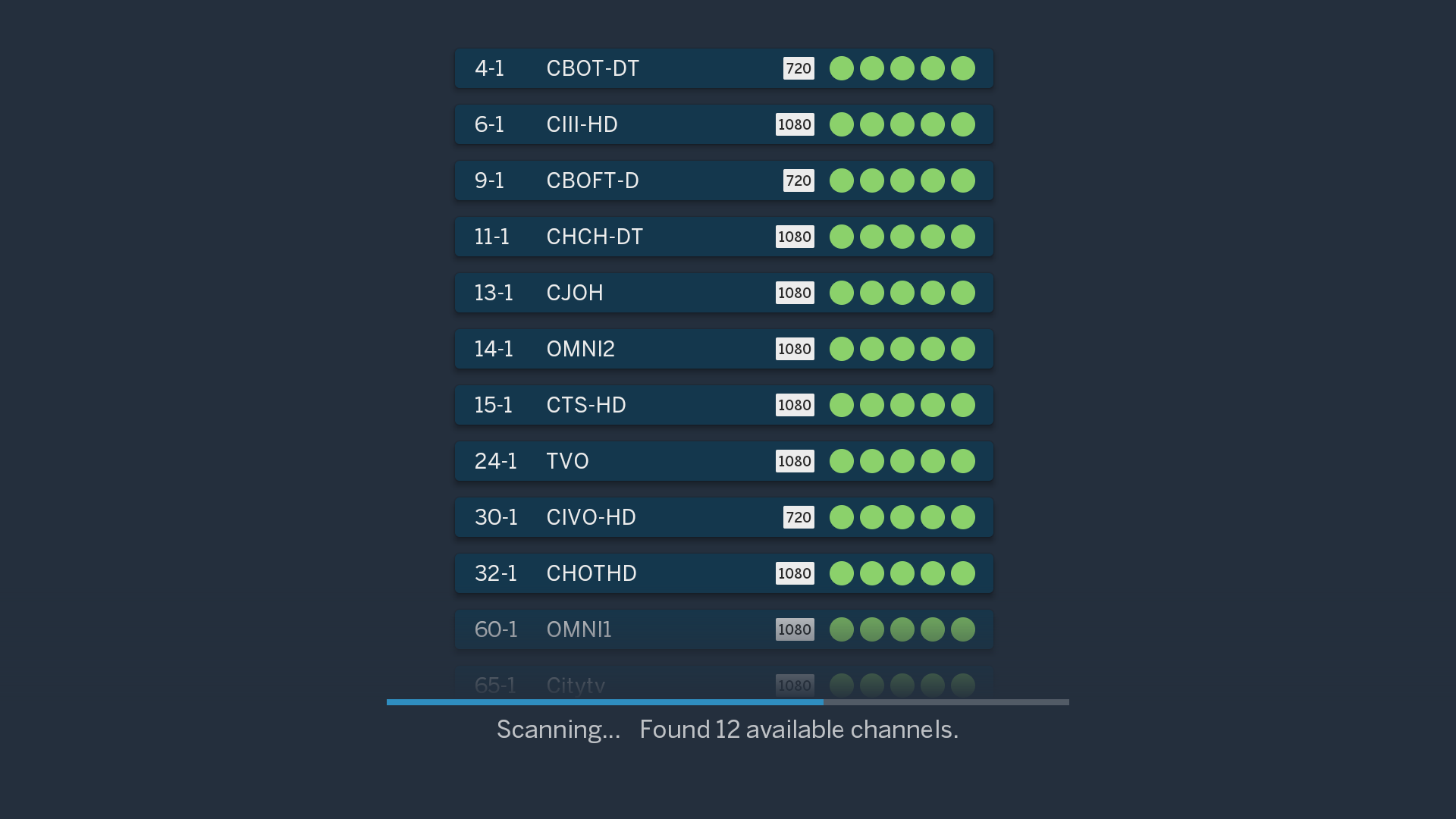

7. Channel Scan
Your Tablo will immediately begin scanning for over-the-air TV channels available in your area.
Recommended channels (those broadcast in HD quality with five green dots indicating excellent signal strength) will be pre-selected with checkmarks.
You may select other channels (those in SD quality) but we do not recommend selecting channels with marginal or poor signal strength (yellow or red dots).
You can also choose to deselect channels that you do not plan to watch, like home shopping or foreign language networks.
Are some channels you wish to receive showing marginal reception? You may wish to reposition your antenna and select RESCAN in order to improve signal reception before selecting CONTINUE.
