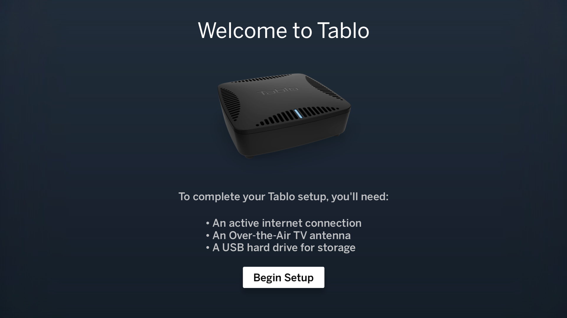

1. Ensure You Have What You Need to Complete Setup
You will need an active internet connection, an over-the-air TV antenna and a supported form of recording storage (if your Tablo does not come with onboard storage).

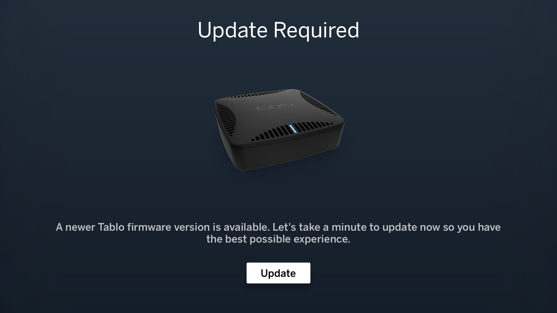

2. Process Firmware Updates If Required
This will ensure your Tablo is running the latest and greatest firmware version.

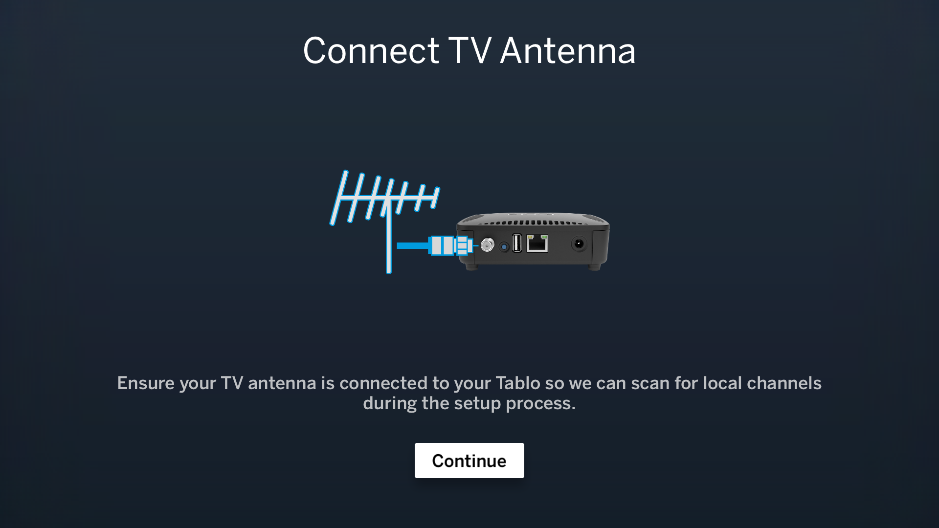

3. Ensure Your TV Antenna Is Connected
Make sure the coaxial cable is securely attached to the coaxial port on the rear of your Tablo.

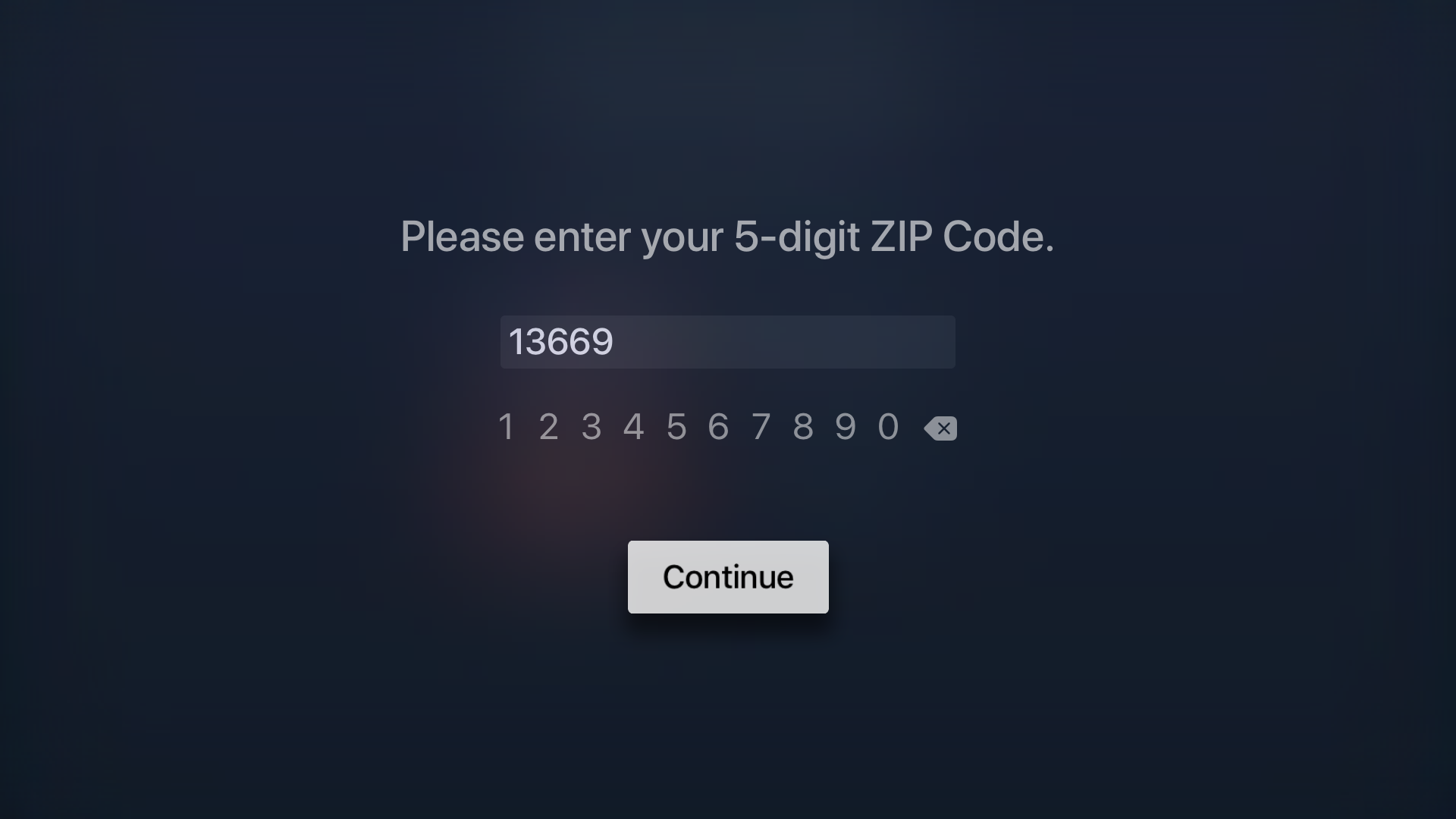

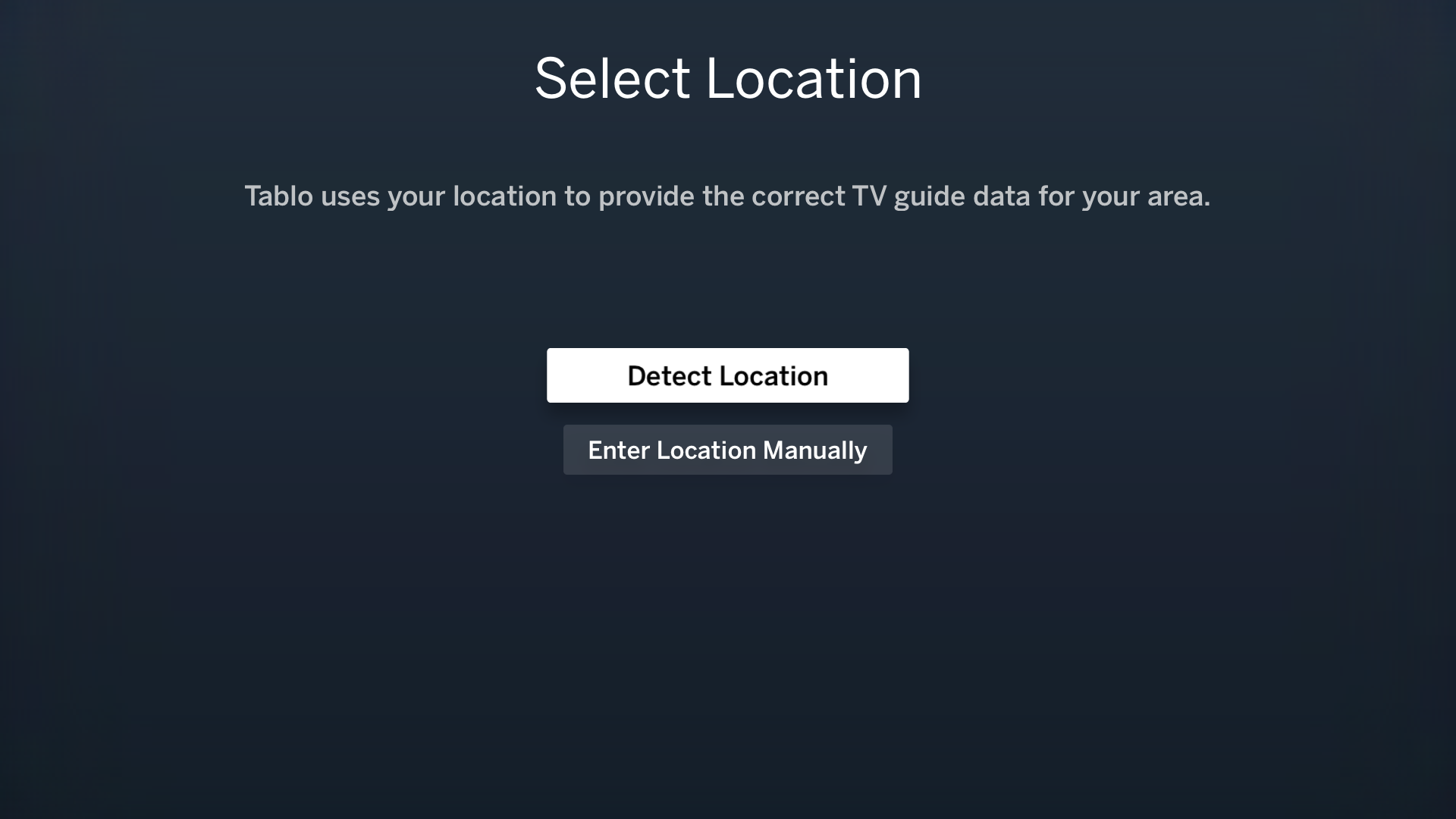

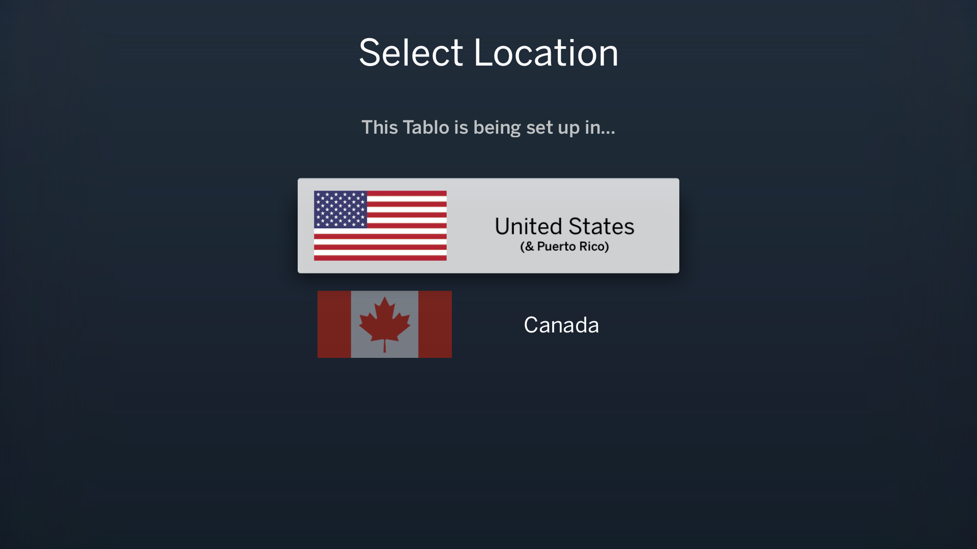

4. Detect or Enter Your Location
Choose to allow your Apple TV to detect your location or enter your location manually. Location data is used to provide the correct TV Guide Data for your area.
If entering your location manually, you'll be asked to select a country...
and then enter a ZIP or POSTAL CODE.

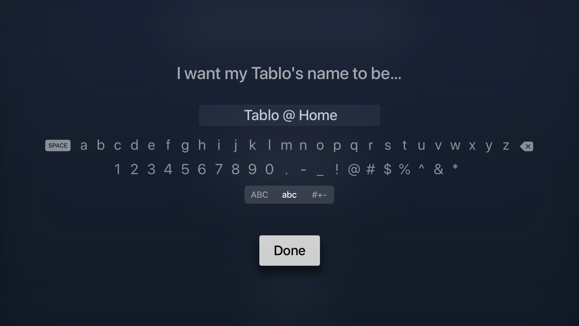

5. Give Your Tablo a Name
This will make it easy for you to identify your Tablo, especially if you have multiple Tablo DVRs in your household or are upgrading from a previous model. This can be changed at any time in the future.

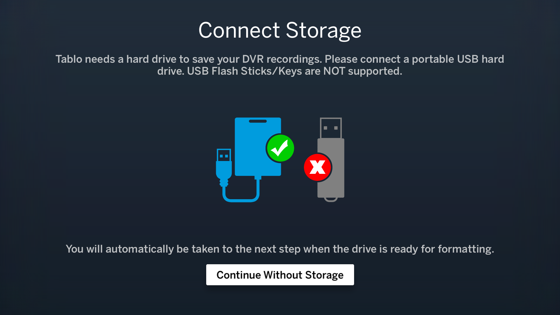

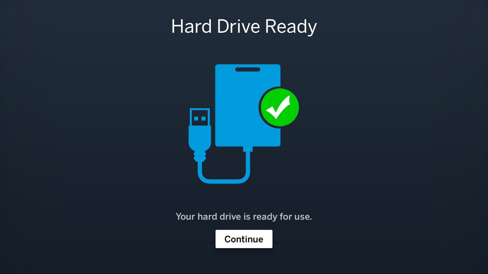

6. Ensure You've Connected a Supported Recording Storage Device
If your Tablo does not come with onboard storage, a supported form of recording storage must be connected. For required storage specs and recommendations for your Tablo, go here.

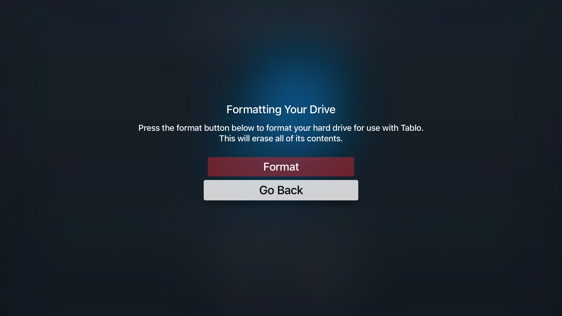

7. Format Your Recording Storage
Tablo will then format your recording storage. This will erase all data on the drive, including partitions.
Select the button marked FORMAT to proceed.
Formatting a brand new drive should only take a few seconds. Formatting a previously used drive will take a bit longer (between 30-90 seconds depending on the size).

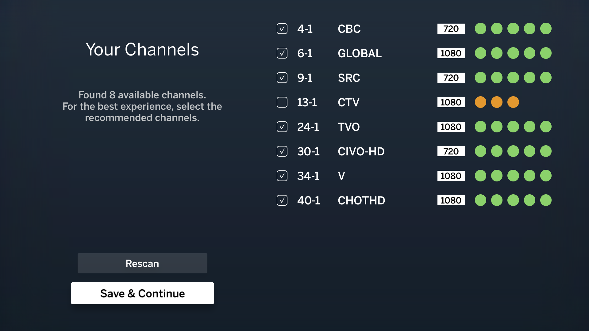

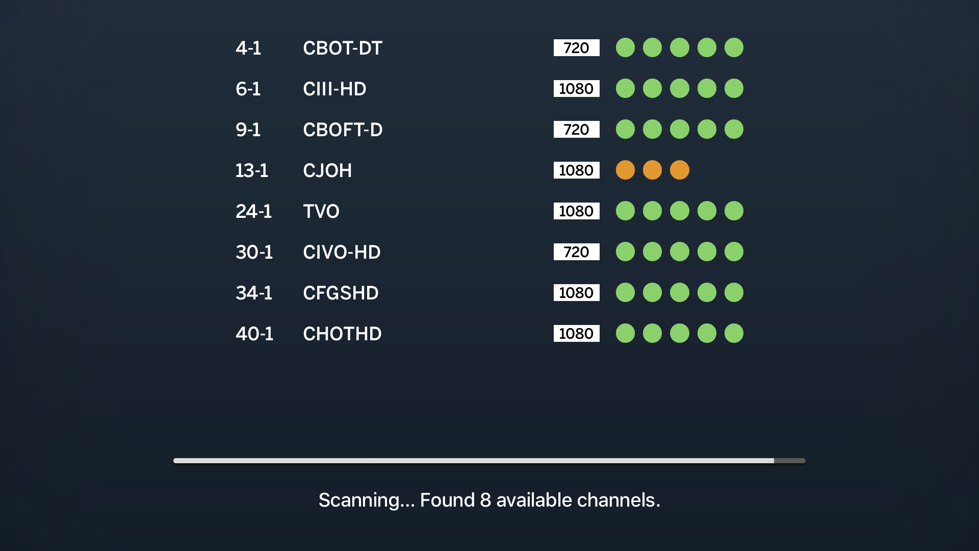

8. Channel Scan
Your Tablo will immediately begin scanning for over-the-air TV channels available in your area.
Recommended channels (those broadcast in HD quality with five green dots indicating excellent signal strength) will be preselected with checkmarks.
You may select other channels (those in SD quality) but we do not recommend selecting channels with marginal or poor signal strength (yellow or red dots).
You can also choose to deselect channels that you do not plan to watch, like home shopping or foreign language networks, at this time.
Are some channels you wish to receive showing marginal reception? You may wish to re-position your antenna and select RESCAN in order to improve signal reception before selecting SAVE & CONTINUE

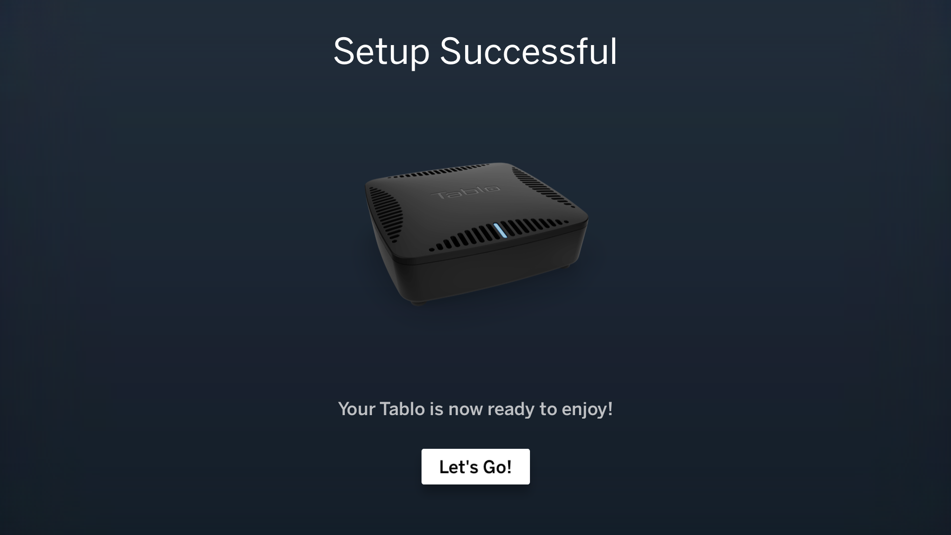

9. Final Preparations
Once your Tablo has downloaded the first 24 hours of TV Guide Data, it will be ready to enjoy!
10. Your Tablo Is Ready
We hope you enjoy your Tablo experience!
