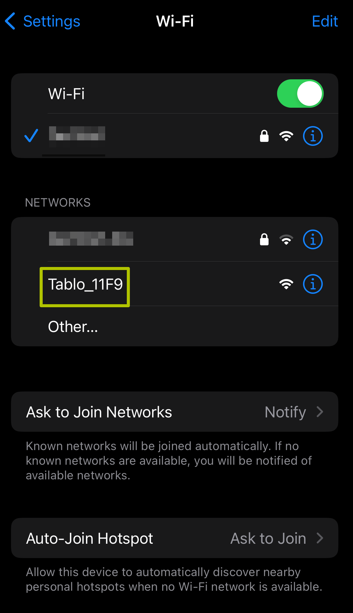

If that fails, close your app. Then go to your Wi-Fi settings on your phone or tablet and look for the Tablo access point, Tablo_XXXX, and connect to it. You will not need a username or password.
If your Tablo's blue LED is pulsing, and you don’t see the Tablo_XXXX network, restart your Tablo by pressing the reset button on the bottom of your Tablo and quickly releasing it. Wait for the blue LED to start pulsing and try to find the Tablo network again.

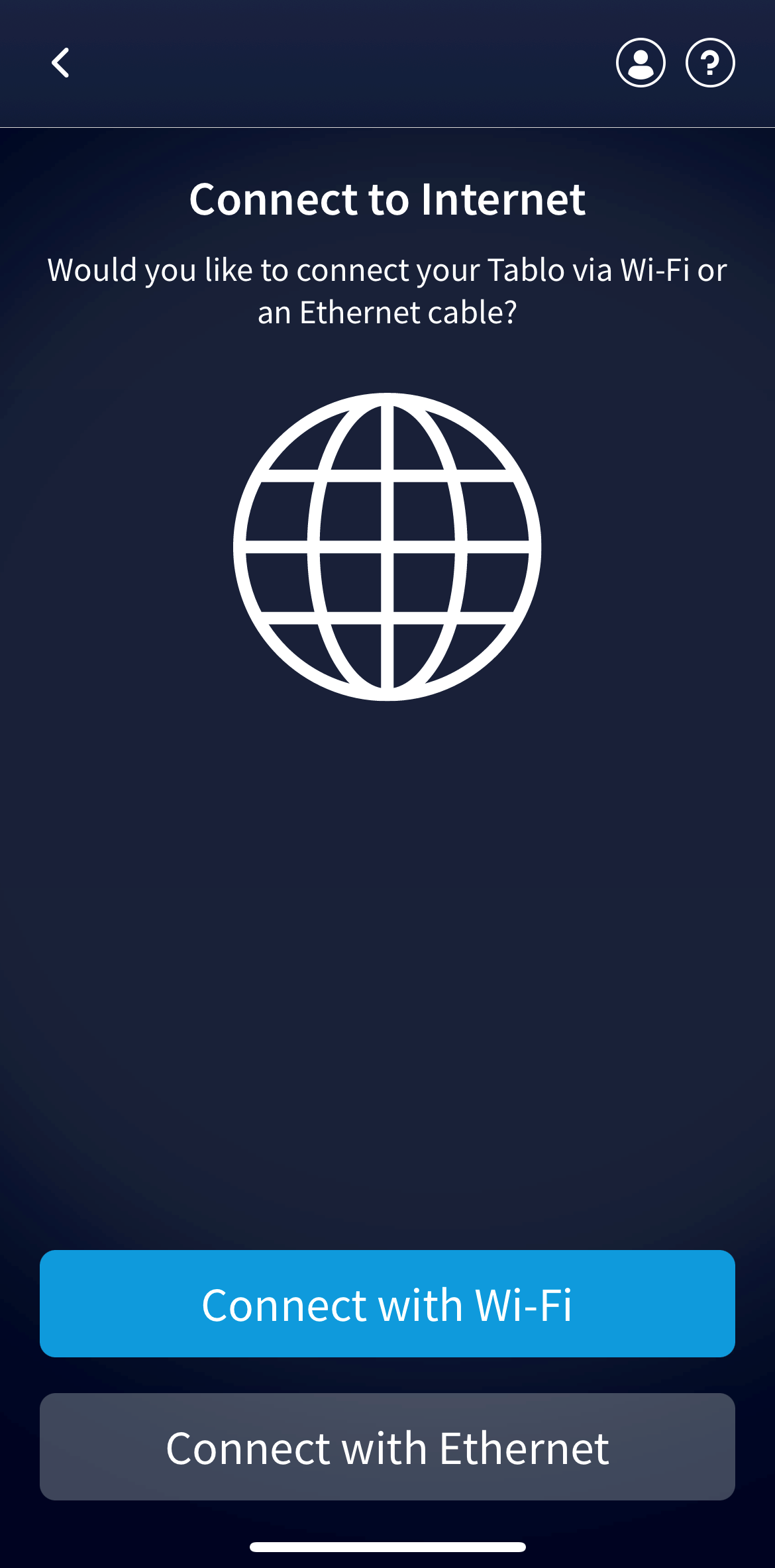

Once you're connected to your Tablo, launch the Tablo app and, on the CONNECT TO INTERNET screen, click CONNECT WITH WI-FI.

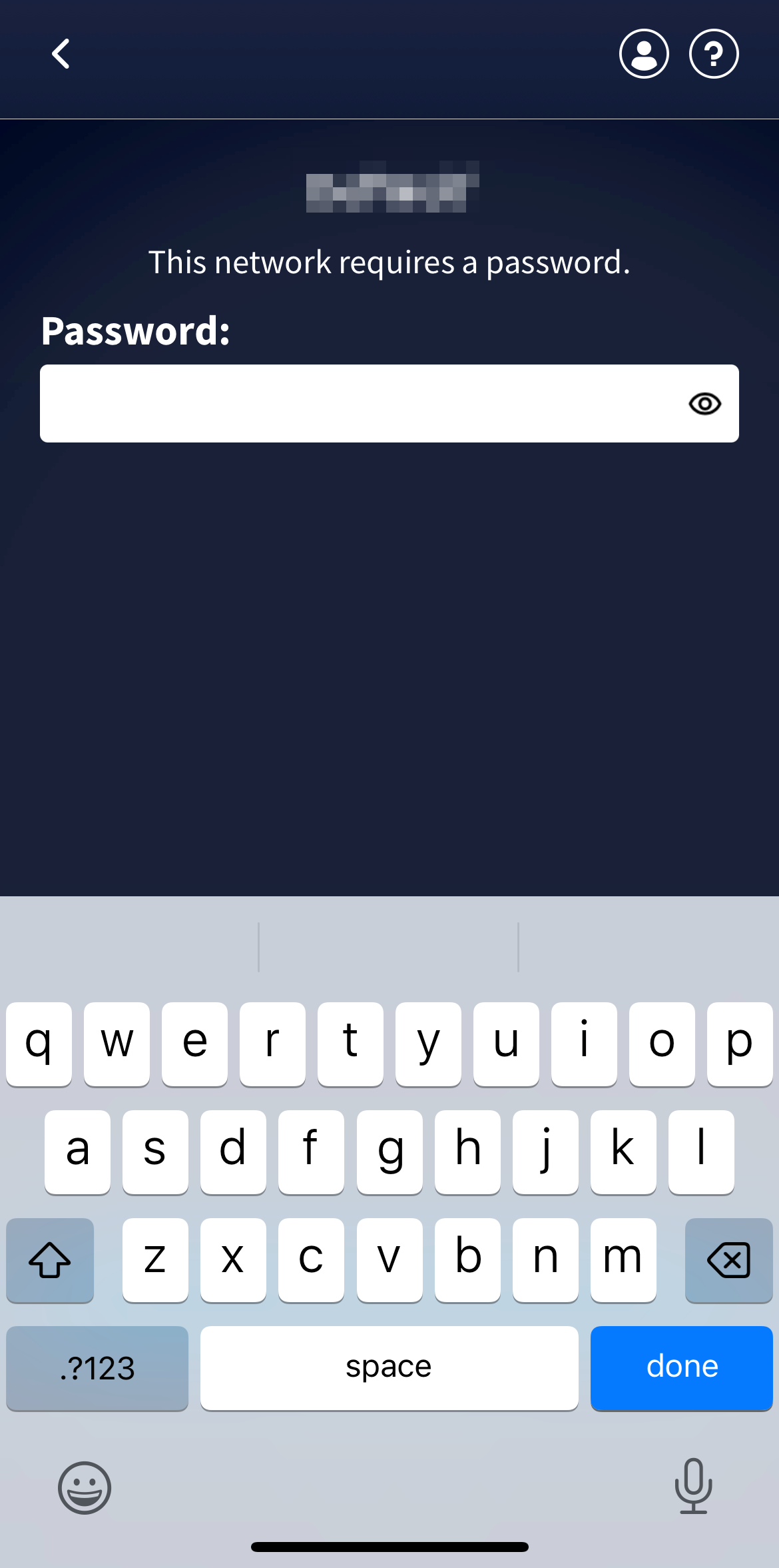

After you've chosen your network, you'll be asked for your network's password. Make sure the password field does not auto-capitalize the first character and that no unwanted spaces have been added.

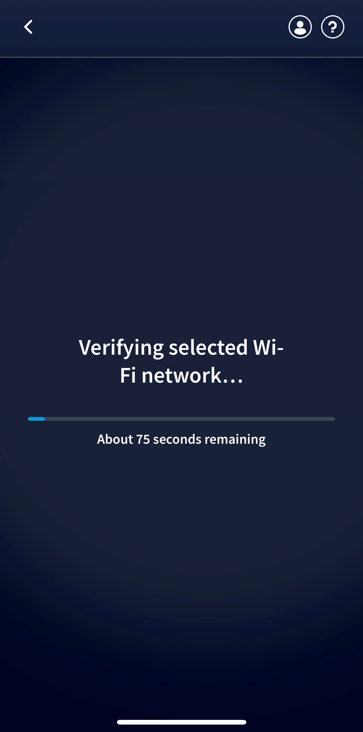

Once you have confirmed your home Wi-Fi network and entered the password, Tablo will attempt to join the network. This process can take a couple of minutes.
Once your Tablo has successfully connected to your Wi-Fi network, its blue LED will stop pulsing and remain solid.
