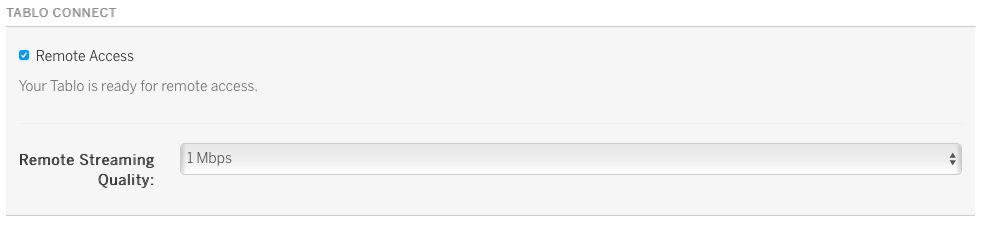

Tablo Connect:
When enabled, this feature allows you to connect to your Tablo with a paired device from outside of the network. For more information on Tablo Connect view this article.
