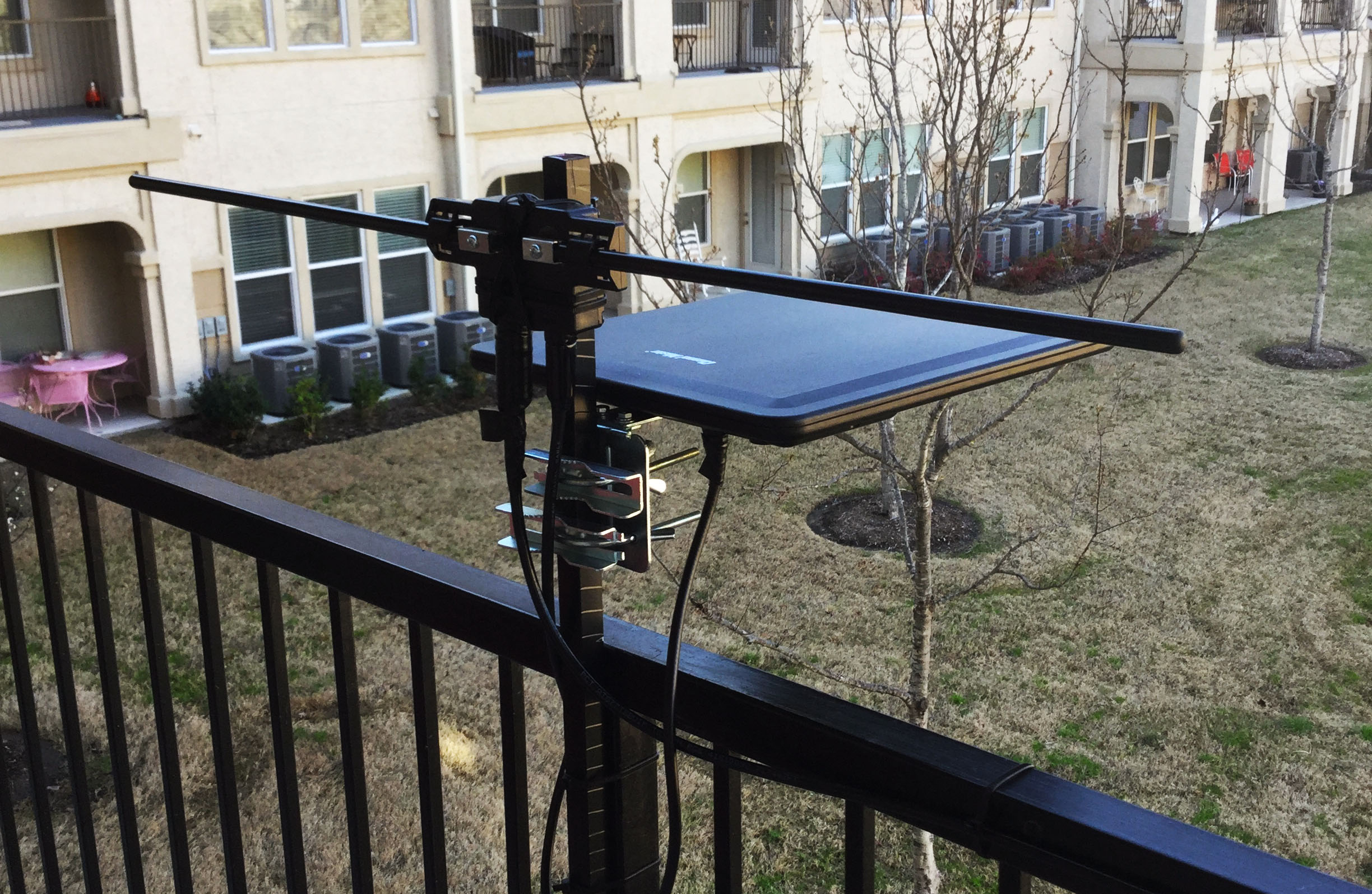

For outdoor TV antennas, the best locations are on your roof or garage. If your attic is accessible, and you don’t have a radiant heat barrier or metal roof, you can try installing an outdoor TV antenna within your attic.
Alternatively, a balcony or other outdoor space can be a great location to install your TV antenna, especially for those living in condos or apartments.
If you don’t feel comfortable installing an outdoor antenna yourself, do not do so. A quick online search can connect you with a local TV antenna installation expert.

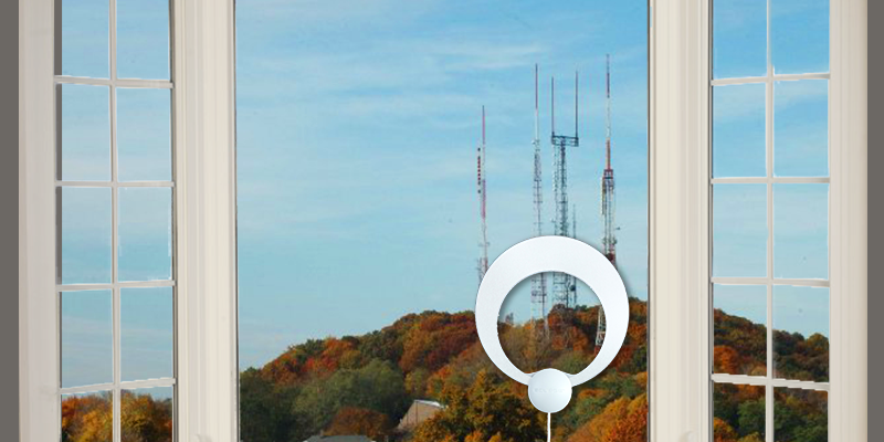

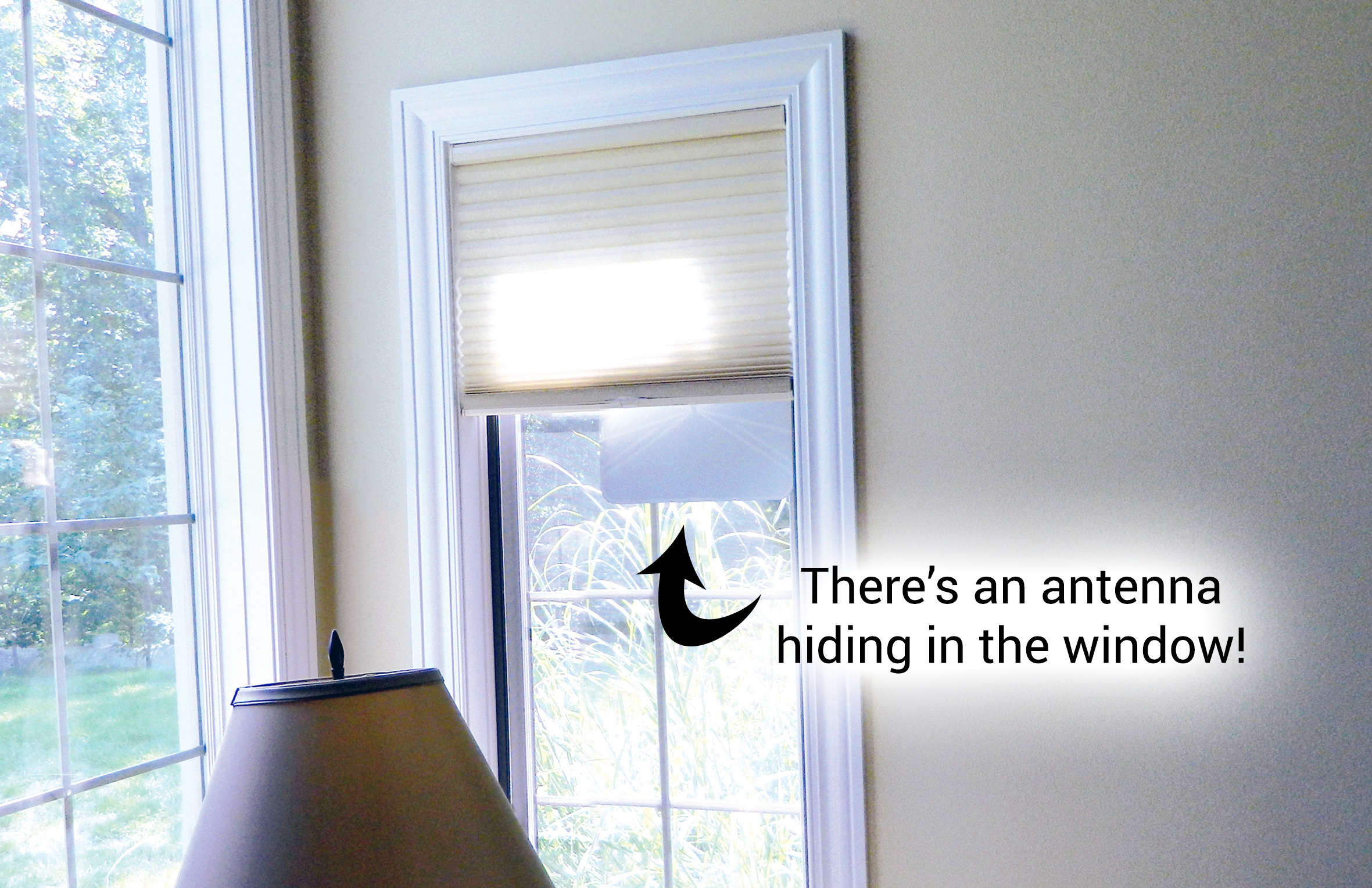

Indoor TV antennas are easier to position and install and are designed to blend into your decor, such as near a window or patio door. If your home has multiple stories, an upstairs window is preferable. However, be sure to avoid windows or doors with metallic mesh coverings or reflective coatings as these can block the TV signals.
Antenna Direction
Over-the-Air TV antennas perform best when they face the source of the signals - your local broadcast towers.
Choose a window or outdoor location with a view towards the towers, free from obstructions.
Omni-directional or flat-panel TV antennas don’t necessarily need to be precisely aimed, but you may see slight improvements by playing with the positioning by a few inches or a few feet. Using a compass can be helpful when pointing directional TV antennas.

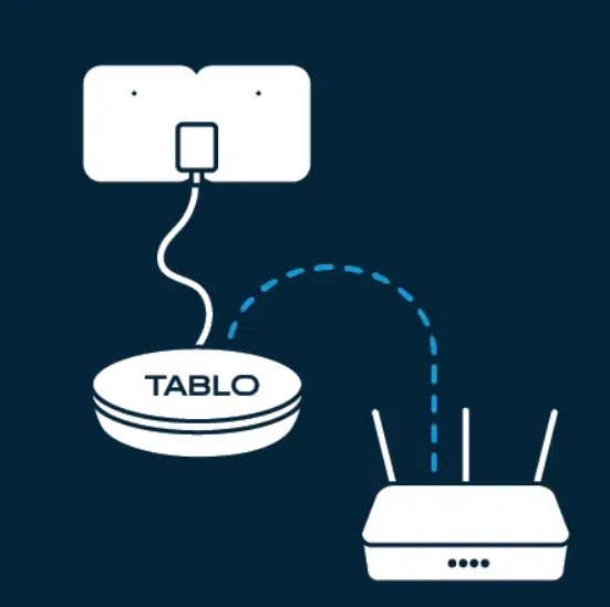

Option C – Distribute TV Signals Over Your Wi-Fi Network
With the 4th Generation Tablo DVR, you can put your TV antenna virtually anywhere in your home and use your home Wi-Fi network to distribute the OTA TV signals.
Network-based distribution enables a single antenna to deliver video and audio to every screen in your home while avoiding running a coax cable everywhere. It also provides the option to add services like an on-screen TV guide and DVR, replicating a cable or satellite TV experience without the hefty monthly costs.
