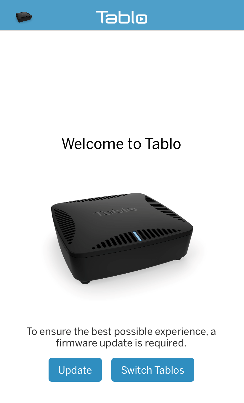

If there are any firmware updates available for your Tablo at this time, the Tablo app will give you the option to process them. We recommend selecting the Update button, if it is present, and then proceeding to the next step.

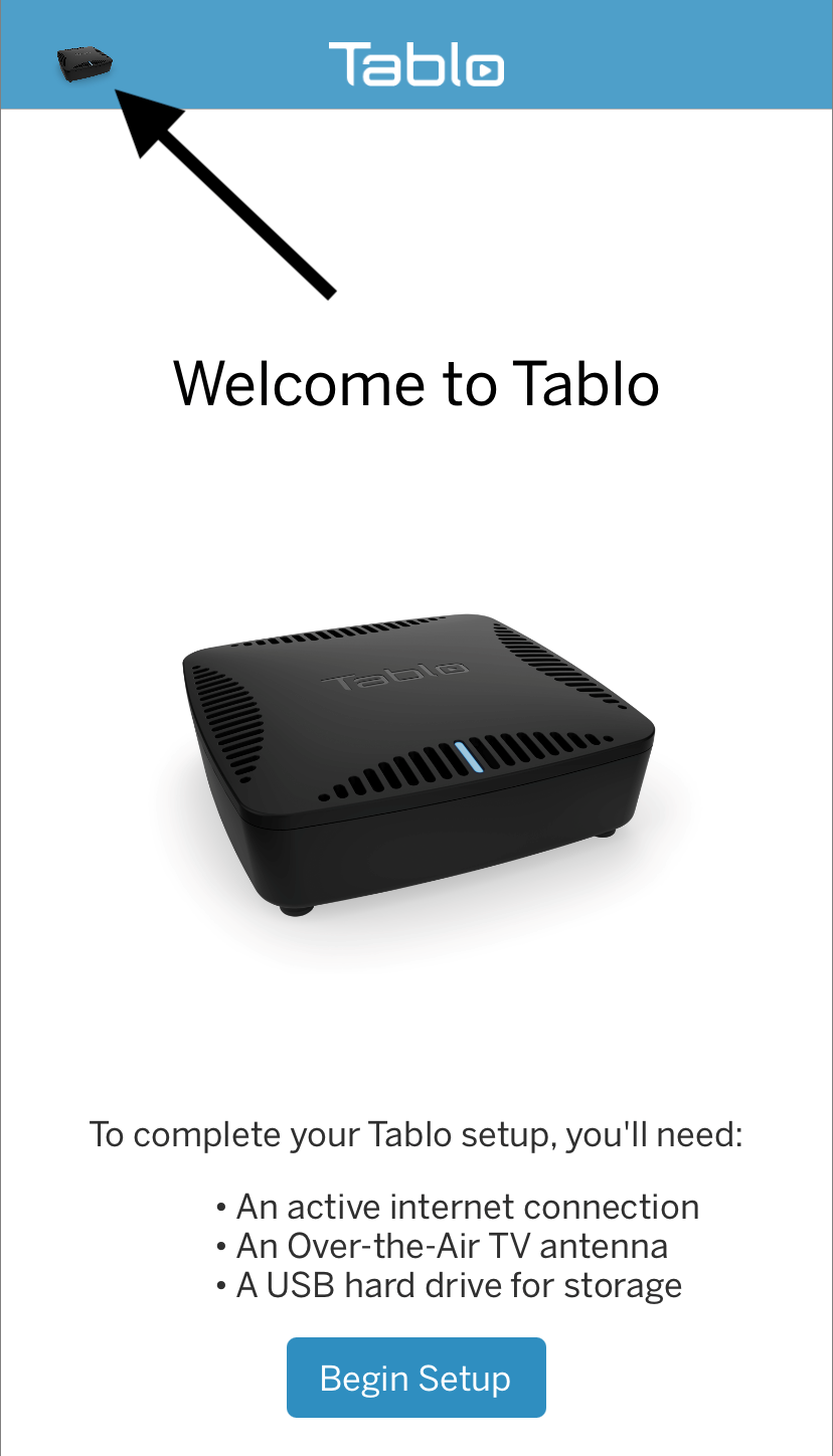

Next, you will be shown the Begin Setup button. Instead of selecting this button, select the image of the Tablo on the top left corner of the screen, as shown in the image below.
This button is also present on most screens of the Tablo app and can be selected to be brought to the Your Tablos screen, as shown in the next step.

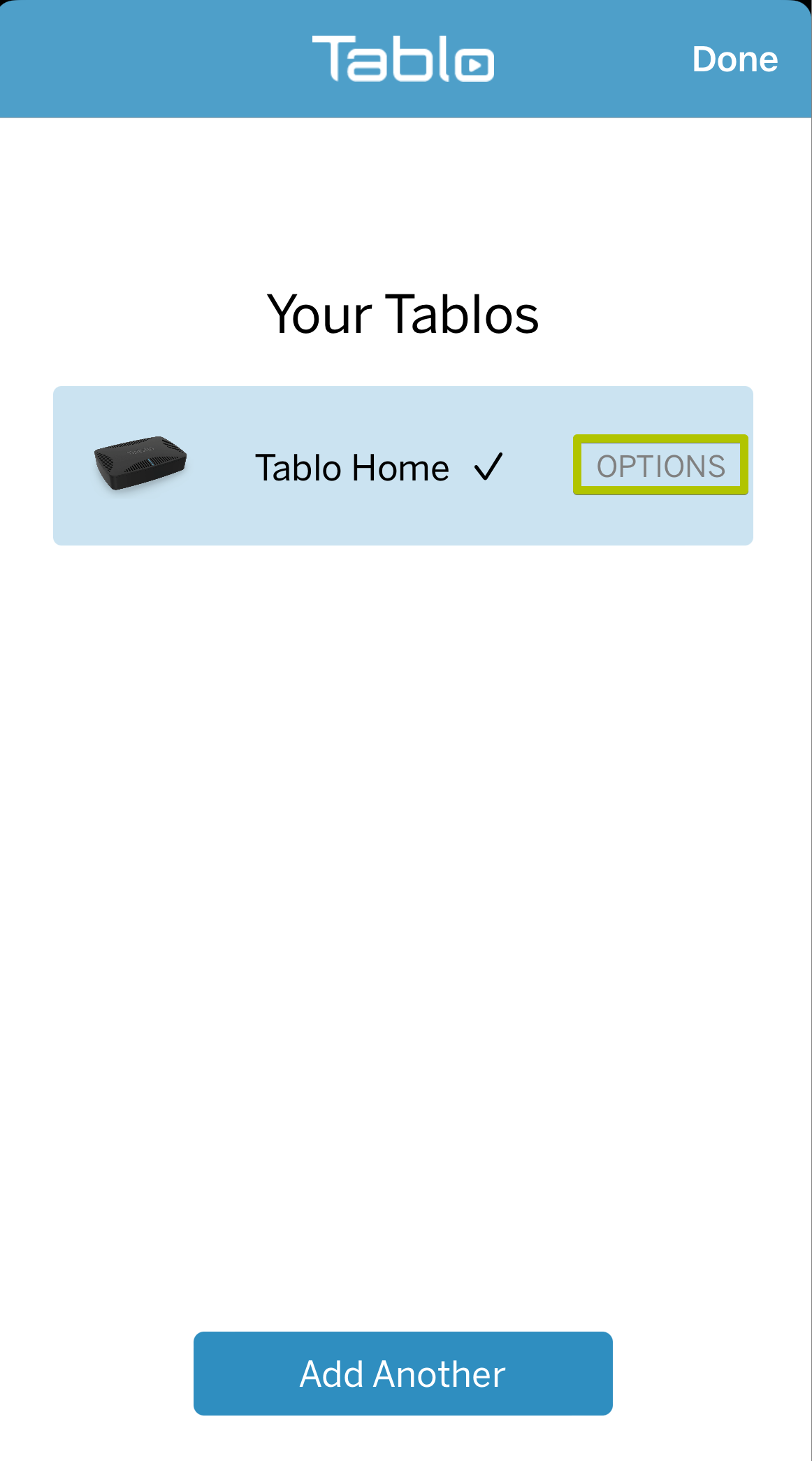

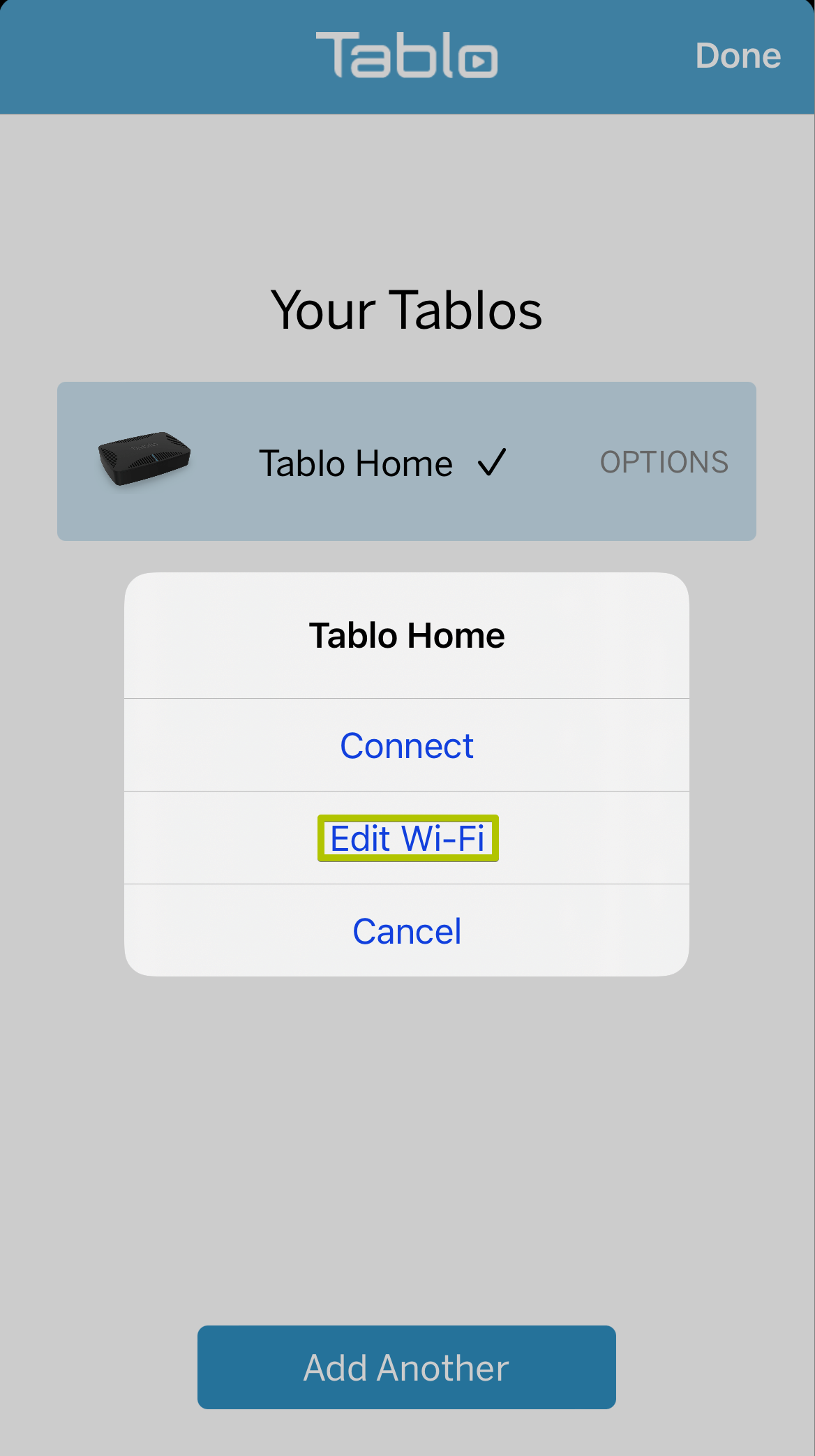

You will be taken to the  Your Tablos screen. Select the OPTIONS link.
Next, select the Edit Wi-Fi link.

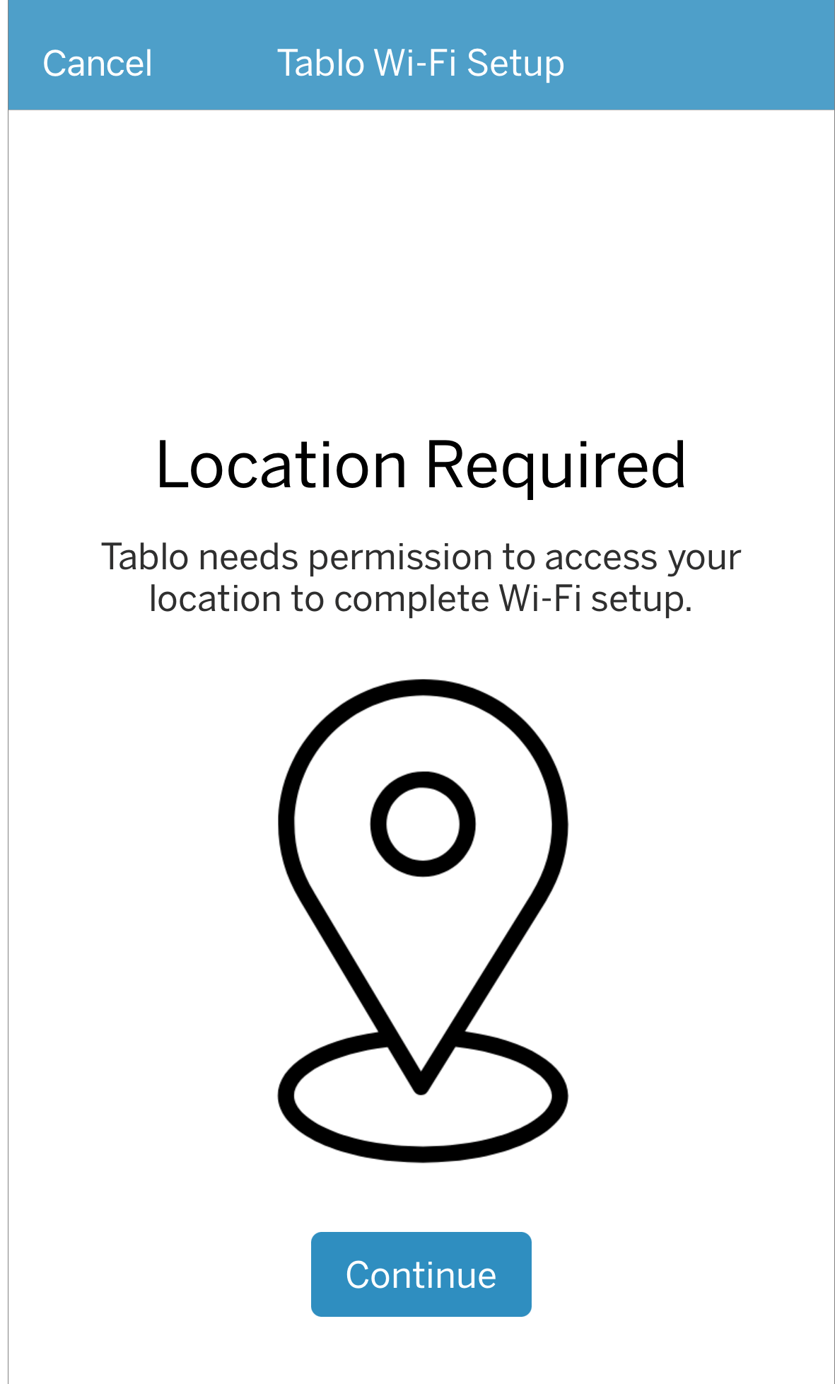

The Tablo app will display the screen below, indicating that it requires location permissions to complete the Wi-Fi setup process. Select Continue.

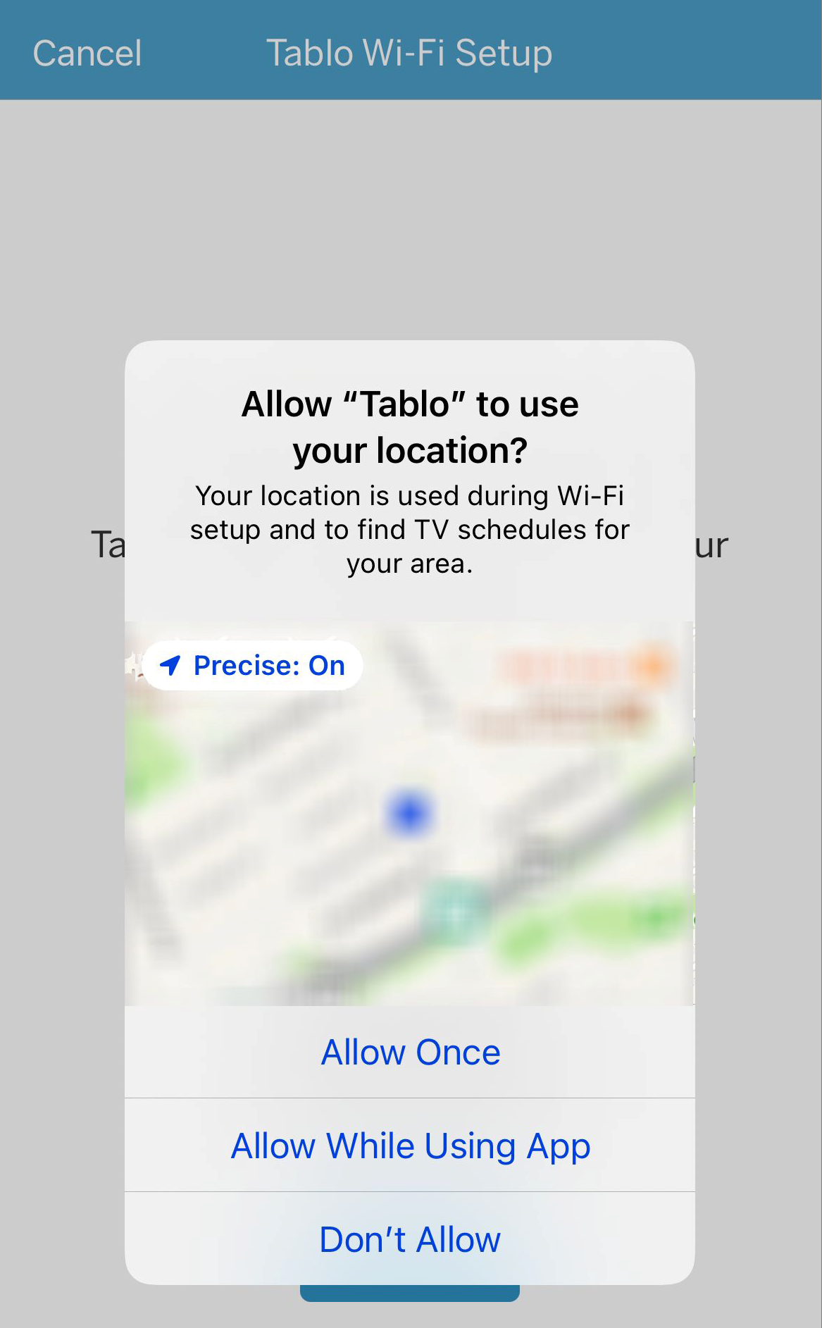

Select either of the Allow links shown below to proceed.

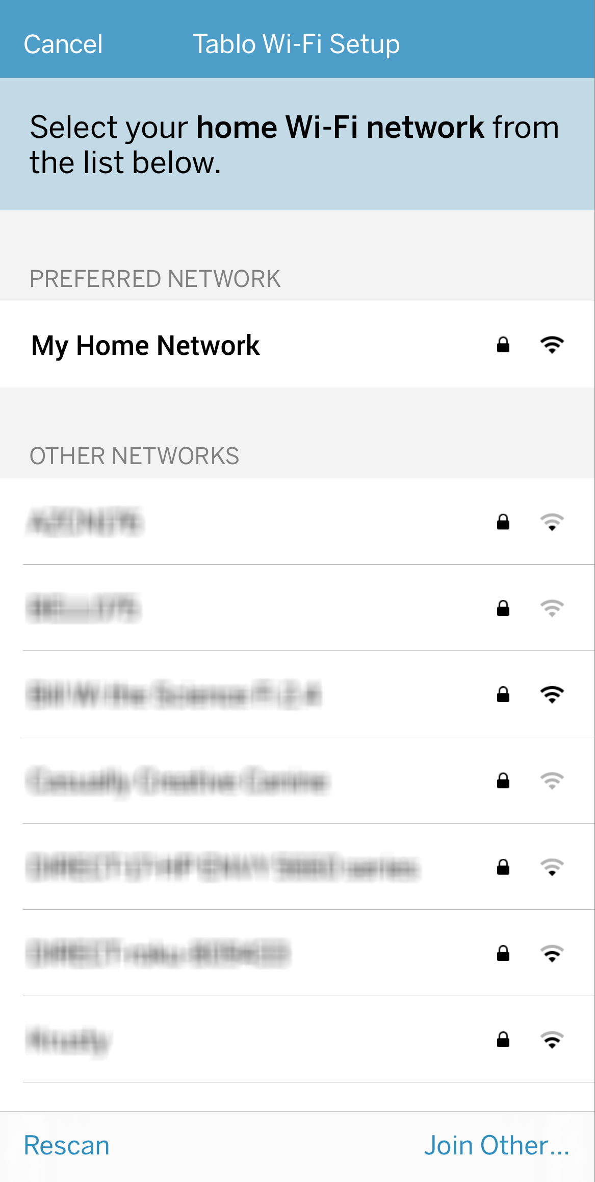

The Tablo app will scan for and display nearby Wi-Fi networks.

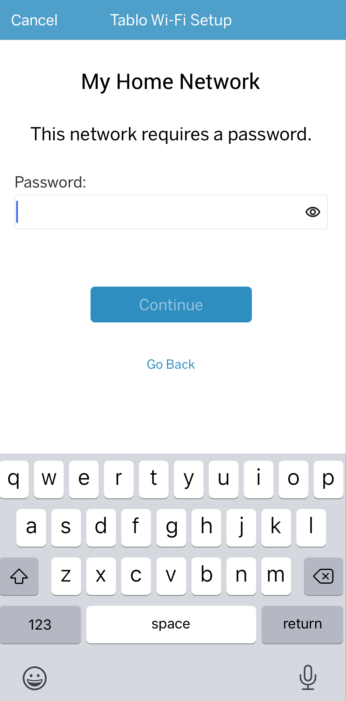

Select your home network and enter the password.
Once you have typed in your password (which is case-sensitive), select Continue.
Your Tablo will attempt to join the network using the password you have entered. If the password you've entered is incorrect or the network rejects the Tablo’s attempt to join for any reason (incorrect password, poor Wi-Fi signal, latency issues, etc.), the Tablo app will prompt you to restart the Add via Wi-Fi process. Once you return to typing in your password, select the Eye Icon first to verify what you're typing in is correct.

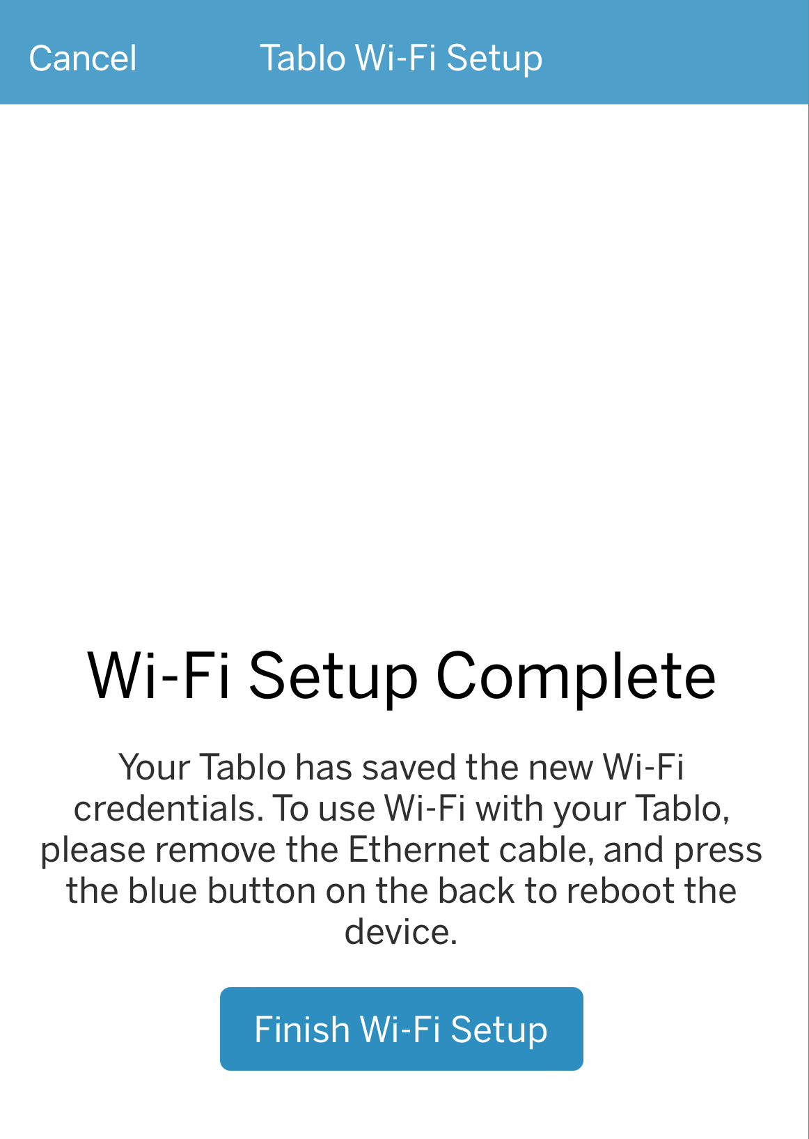

If you're able to log in to your Wi-Fi, the app will tell you that your Wi-Fi setup is complete.
At this stage, remove the Ethernet cable from the Tablo and place it wherever you'd like.
