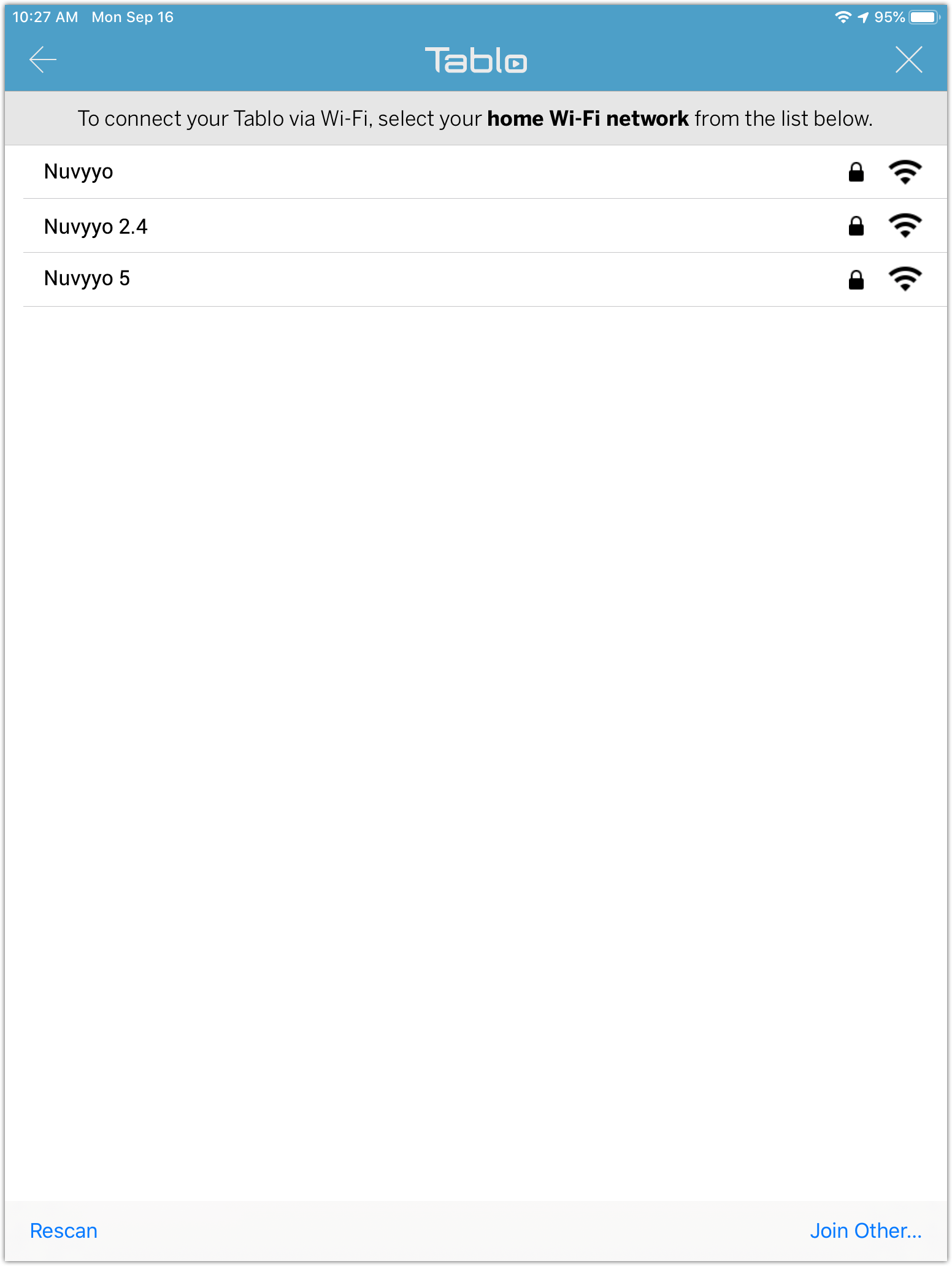

Once you have connected to your Tablo’s Wi-Fi network, return to the Tablo app. It will prompt you to select your home network and enter the password.
Once you have typed in your password, select JOIN.
The Tablo will attempt to join the network with the password you have entered. If the password you've entered is incorrect or if the network rejects the Tablo’s attempt to join for any reason (bad password, poor Wi-Fi signal, latency issues, etc.) the Tablo app will prompt you to restart the Add via Wi-Fi process.

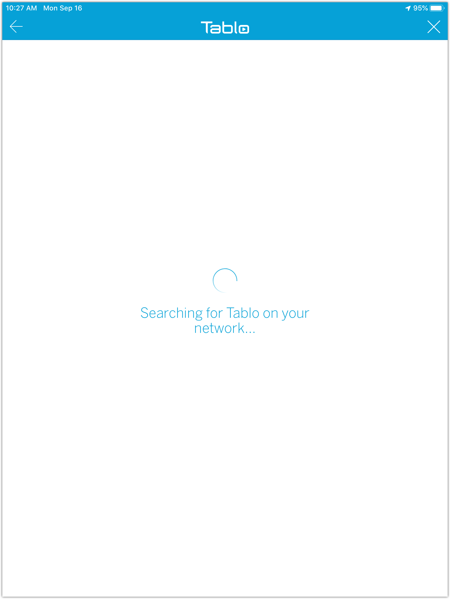

If the Tablo is successful in joining the Wi-Fi network, its blue LED will turn solid blue and stop pulsing. The Tablo app will begin searching for your Tablo on the network.
Once the Tablo has joined the network and been found by the Tablo app, you will be greeted by the screen below. From here, you can begin formatting your hard drive, scanning for channels and using your Tablo!
