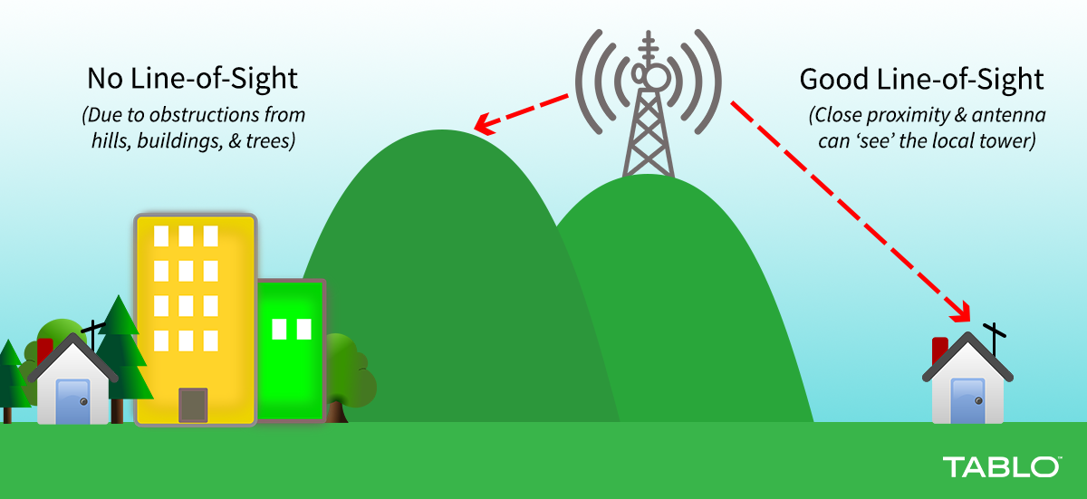

Line-of-Sight & Proximity to Local Broadcast TV Towers
OTA TV signals are distributed via the concept of line-of-sight. Ideal TV reception occurs when your TV antenna is in close proximity to the local broadcast towers and can see them with minimal or no obstructions.
This means ideal reception areas for antenna TV are on flat land, within 35 miles of local broadcast towers. However, under normal atmospheric conditions and depending on your antenna equipment, placement and other factors, TV signals can be received up to 70 miles away.
The further away from your local TV towers, the more likely that interference and obstructions like hills, buildings and trees will impact your ability to receive OTA TV signals. Beyond 70 miles, signals are blocked by the curvature of the earth and cannot reach any TV antenna.

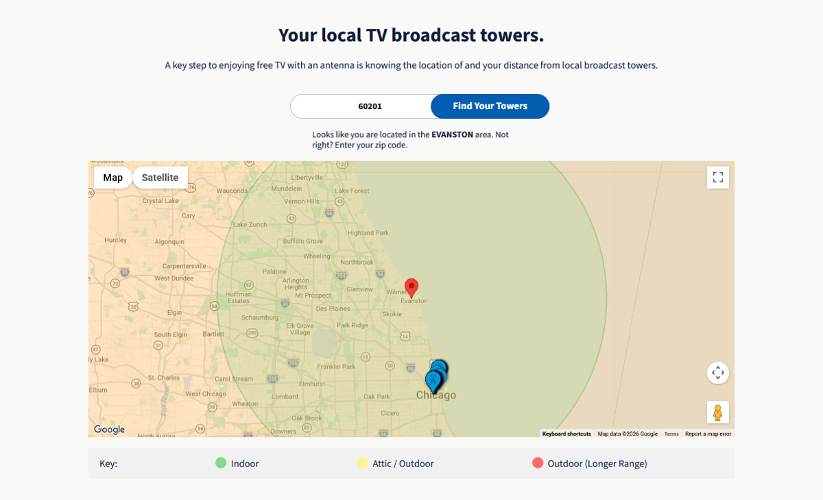

In the example above, which is an address in the Chicago suburb of Evanston, IL, you’ll see that most local channels are broadcast from Chicago, about 19 miles away. This is close enough for indoor antennas to be effective.

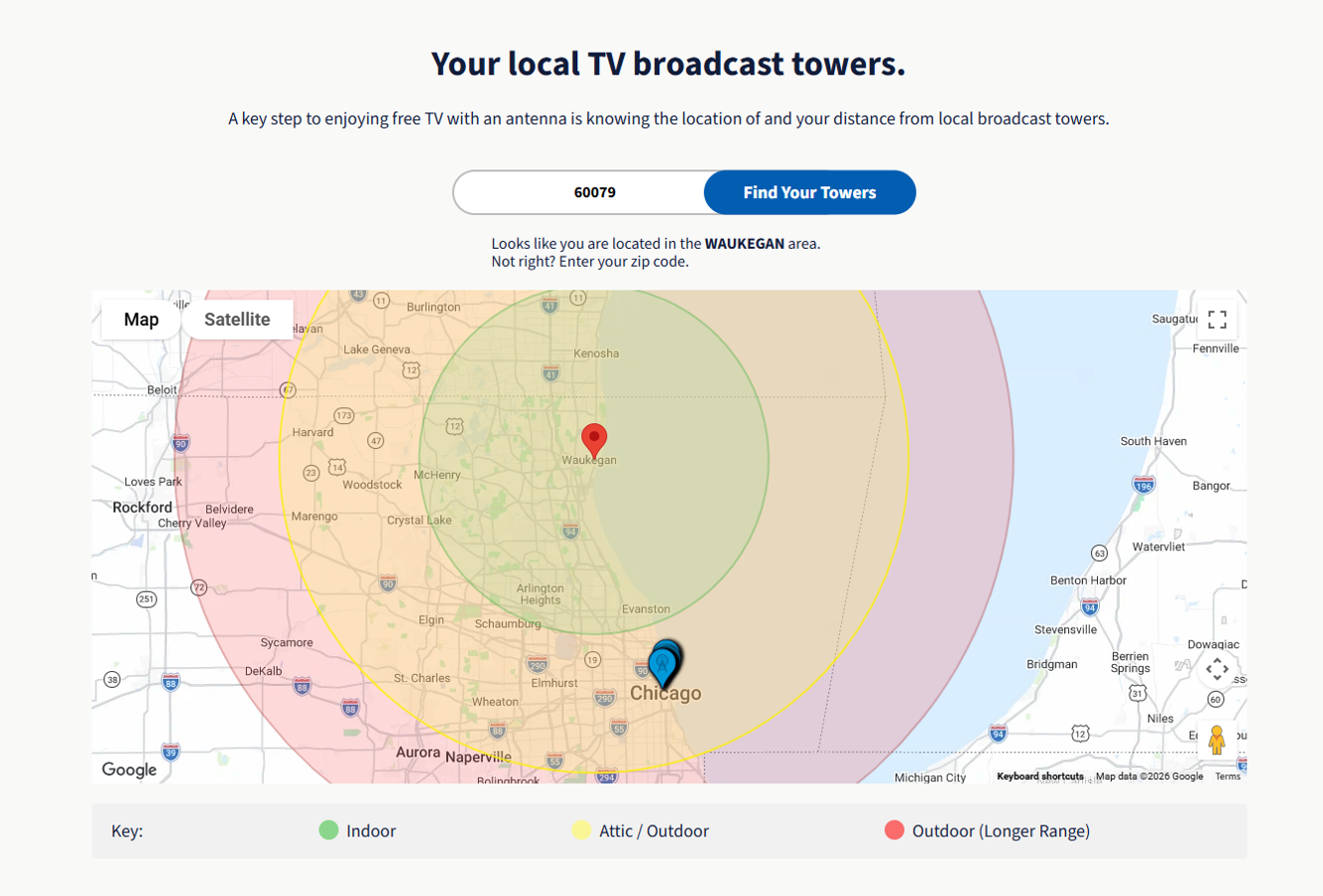

But if you live in Waukegan, 45 miles from downtown Chicago, you may need a larger TV antenna placed in your attic or outdoors to enjoy solid reception.

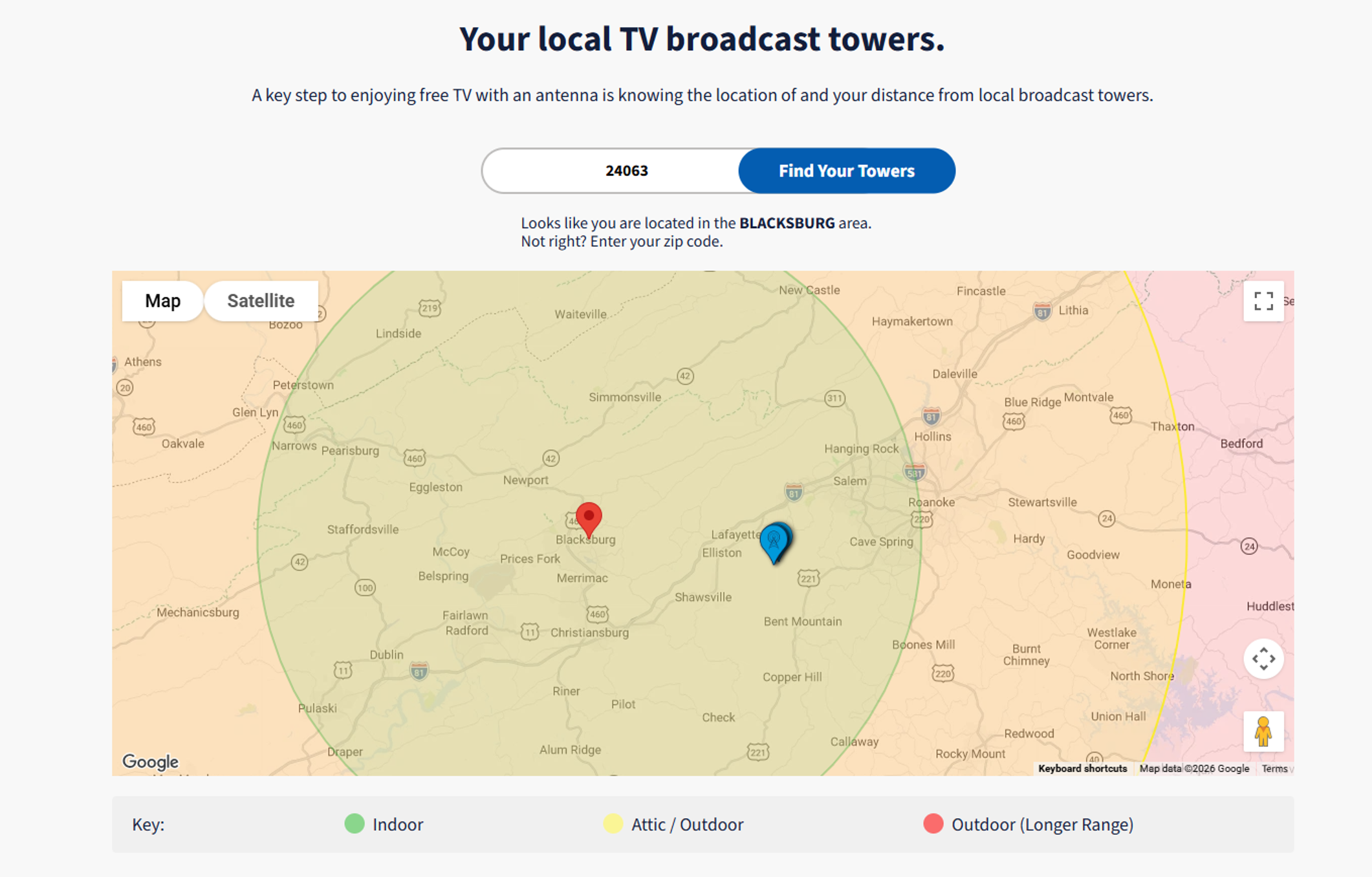

But distance isn’t the only factor to consider. In Virginia, Blacksburg is only 15 miles as the crow flies from the local broadcast towers. However, depending on your exact location and antenna placement, the topography of the Blue Ridge Mountains can block signals.
