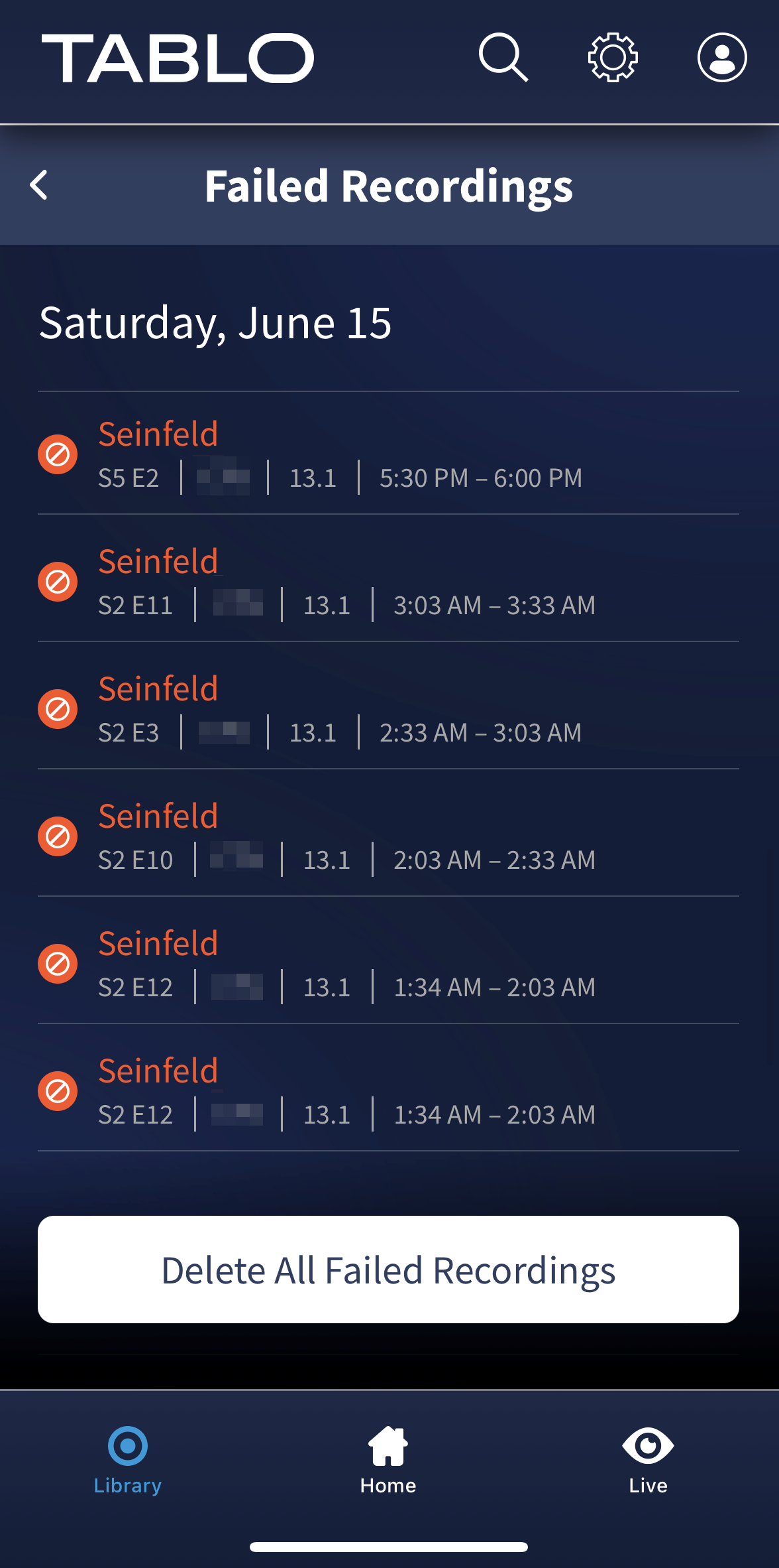

Sometimes, video is corrupted so much that the entire recording is ruined, and the Tablo is unable to record at all. These are shown under Failed Recordings like in the image below:
