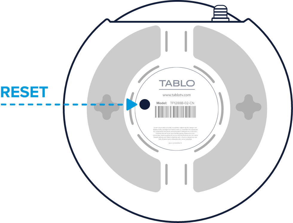

  • To reboot a 4th Generation Tablo DVR, press and quickly release the reset button on the bottom of the unit. DO NOT HOLD THE BUTTON DOWN.

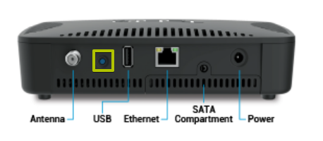

  • To reboot a legacy network-connected Tablo DVR, press and quickly release its reset button, which is blue and is located on the rear of the unit. DO NOT HOLD THE BUTTON DOWN.

On either model, the blue LED on the front of the Tablo will begin to flash rapidly for a few seconds, indicating that a reboot process has started. Once the LED has turned solid, your Tablo is online and ready for use.
Do Not Hold Down the Reset Button
Holding down the reset button for 10 seconds or more will cause your Tablo (legacy or 4th Generation) to perform a factory reset. This will erase everything on the Tablo, schedules and recordings included, and set it back to its factory default. Only your installed firmware will remain.

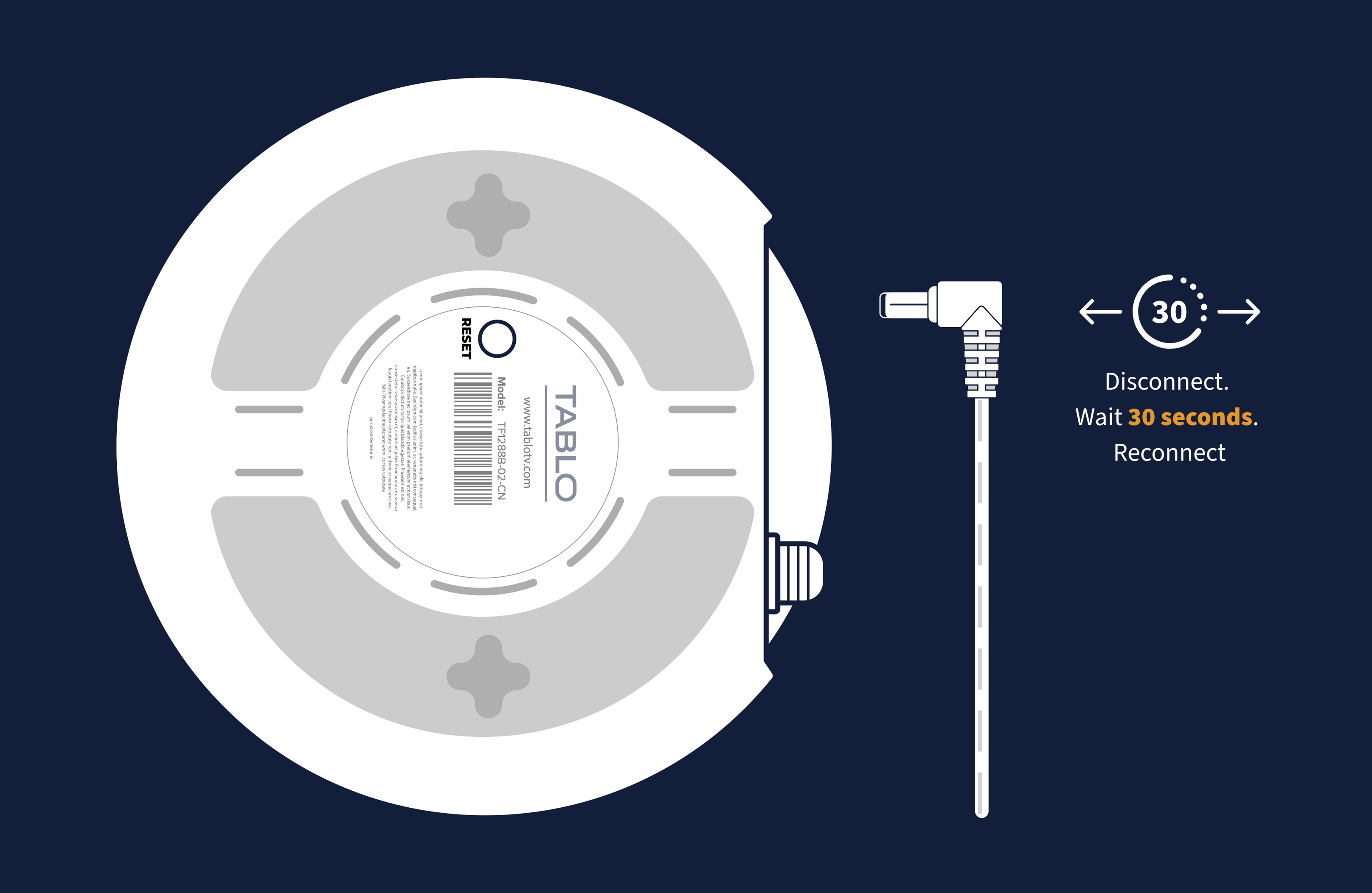

If you're still unable to connect to your Tablo after a reboot or your Tablo is offline (blinking LED vs. solid), power cycling your device might help.
Temporarily removing power from your Tablo device resets several internal processes without impacting your saved recordings, schedules or settings.

The steps for power cycling your Tablo are the same for all models.
  1. Disconnect the power adapter from the rear of your Tablo device.
  2. Wait for 30 seconds.
  3. Reconnect the power adapter.
Like when you reboot your Tablo, you'll see the LED rapidly flash and then turn solid, indicating the power cycle is complete and your Tablo is online and ready for use.
