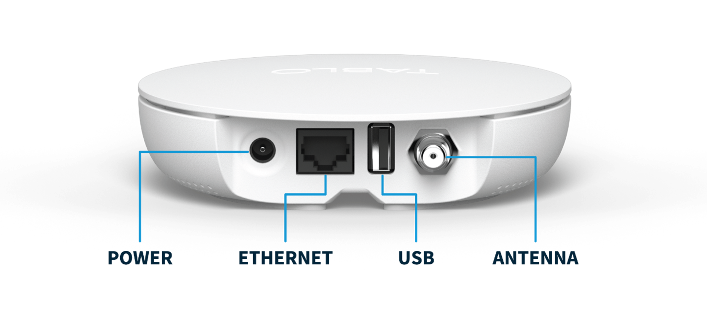

4th Generation Tablo
These models are white and round with a slightly domed top.

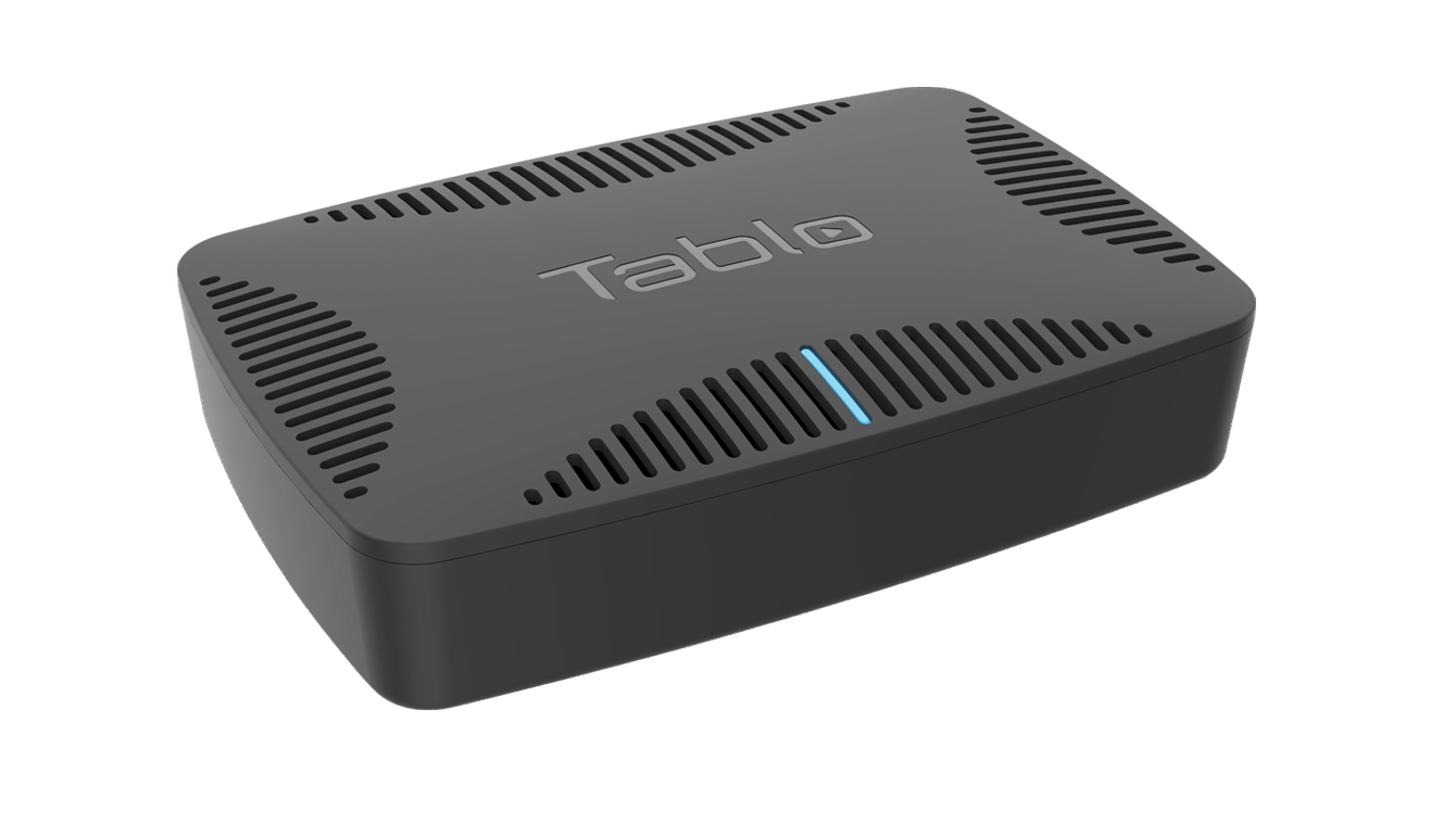

Tablo DUAL LITE or Tablo DUAL 64GB or Tablo DUAL 128GB
These models are square with rounded corners and air vents on the slightly domed top.

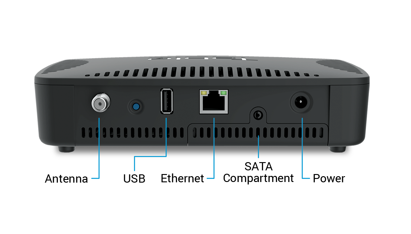

Tablo QUAD or Tablo QUAD 1TB
These models are rectangular with rounded corners and air vents on the slightly domed top.

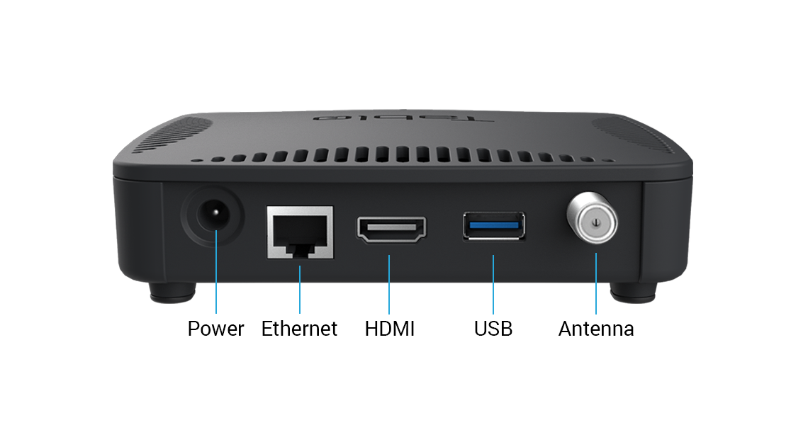

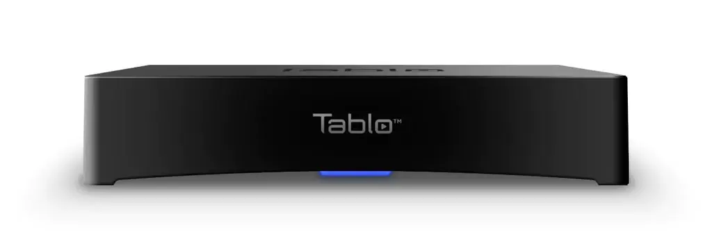

Tablo DUAL HDMI or Tablo QUAD HDMI
These models are square with rounded corners, air vents on the slightly domed top, with a shiny half-moon section (the IR remote sensor) and a Tablo logo screen printed on the front. They come with a Tablo-branded remote.
The 4th Generation Tablo, like legacy network-connected units, only have ports for the antenna, USB, Ethernet and the power supply. The order of the ports is reversed from legacy model Tablo devices and the Ethernet port does not have LEDs.
Tablo DUAL LITE or TABLO DUAL 128GB
The Tablo DUAL LITE and Tablo DUAL 128GB are network-connected units and will only have ports for the antenna, USB, Ethernet and power supply.
Tablo QUAD or TABLO QUAD 1TB
The Tablo QUAD and Tablo QUAD 1TB are network-connected units and will have ports for the antenna, USB, Ethernet and power as well as a SATA compartment for an internal hard drive.
The Tablo DUAL HDMI and Tablo QUAD HDMI are TV-connected units and will have ports for power, Ethernet, HDMI, USB and antenna.
