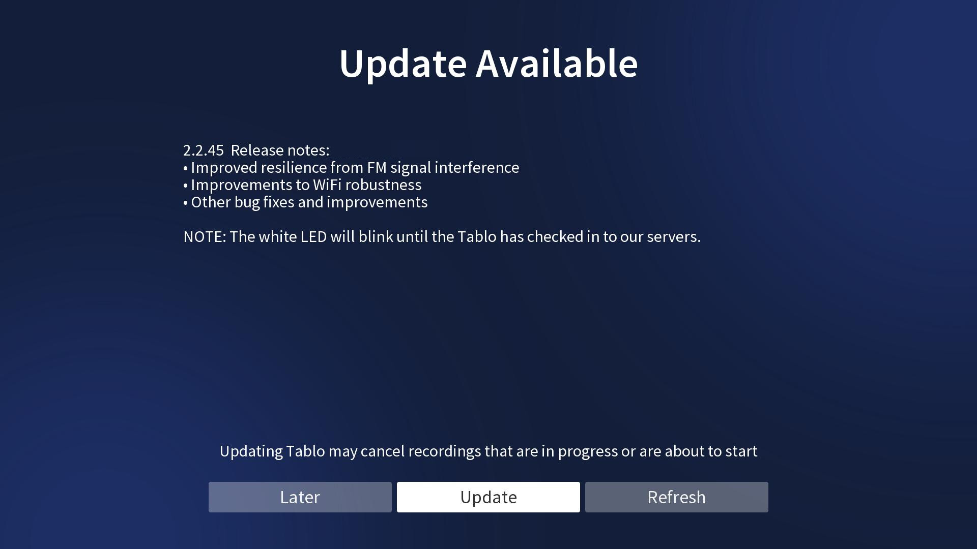

 To Download Periodic Firmware Updates
When Tablo OTA (over-the-air) DVRs are manufactured, they come pre-loaded with operating software called firmware. New firmware updates are issued regularly to boost performance, add features and correct any problems that may arise. Without the internet, your Tablo won’t receive the notification that an update is available and won’t be able to download it from our servers.
The data required to download Tablo firmware updates is also minimal, on average, approximately 24 MB per update.
