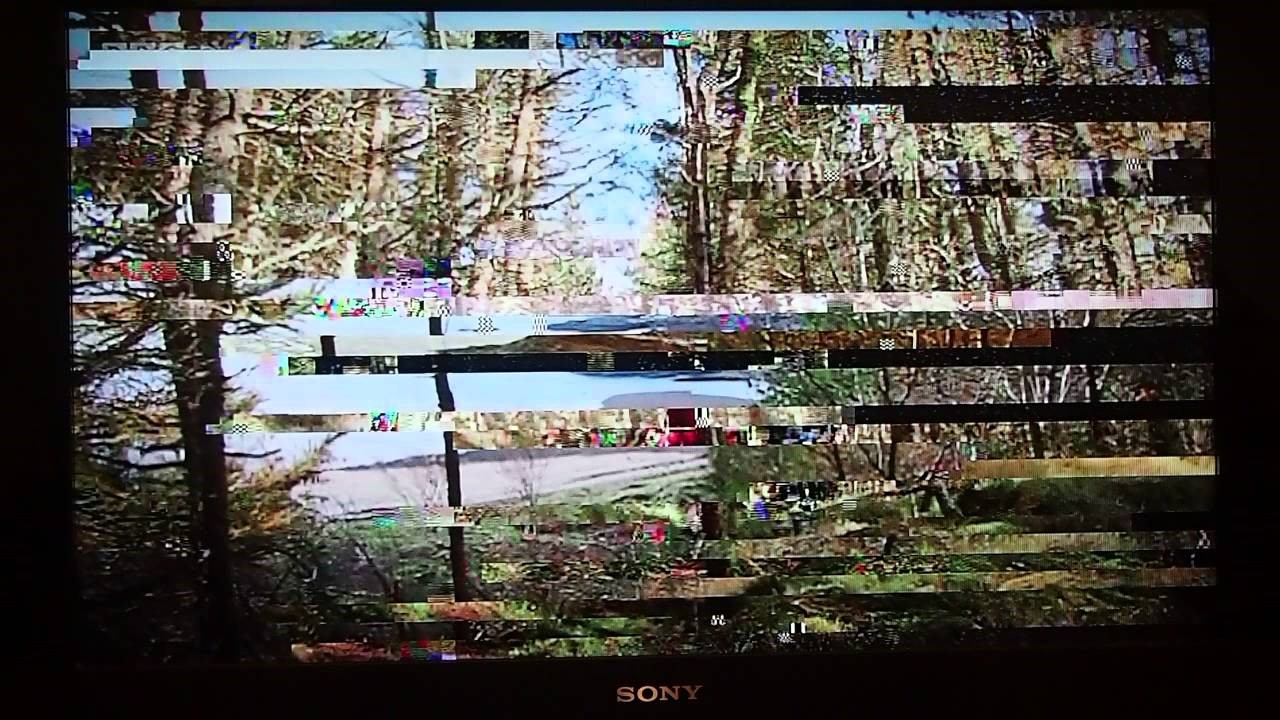

  • Occasional or frequent pixelation, glitching, breakup or patterning of the video during playback.
  • Brief buzzing or brief loss of sound.
… then the issue is related to the signal strength or quality coming from your over-the-air antenna to your Tablo.
To resolve this, try improving your over-the-air antenna setup and then run a fresh channel scan on your Tablo DVR.

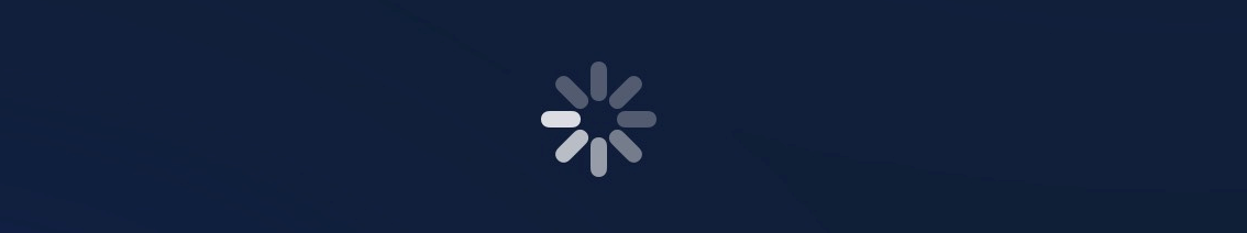

If you’re experiencing clean video during playback (no pixelation) but:
  • Occasional or frequent stops and starts, stutters or freezing.
  • A spinning circle or loading… please wait message.
… then the problem source is most likely a poor Wi-Fi signal on your home network, either from your router to your viewing device (Roku, Fire TV, Apple TV, tablet, etc.) or from Tablo to your router.
Because Tablo relies on your internal home network (LAN) this can happen even if the external internet speeds (WAN) you get from your Internet Service Provider (ISP) are fast.
This is one of the reasons why you may not experience buffering when streaming video from online sources like Netflix.
