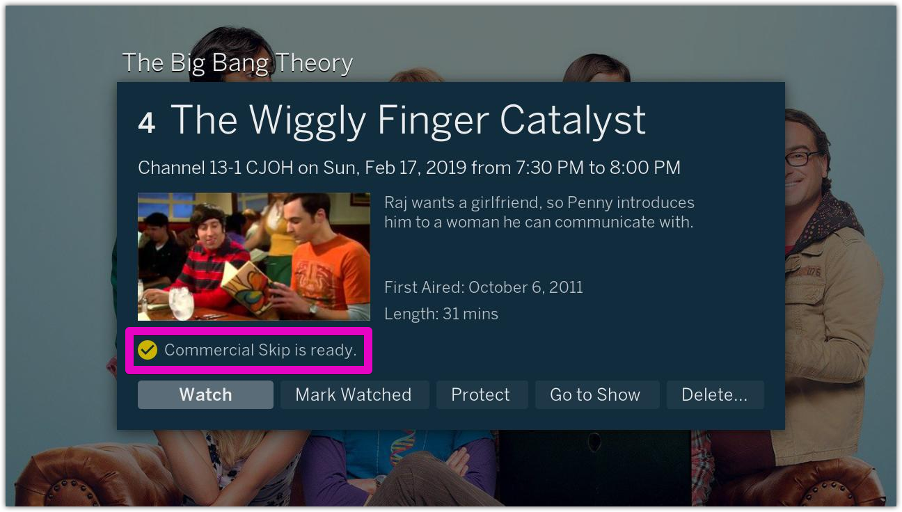

If enabled in your Tablo's settings screen, most compatible Tablo apps (Roku, Amazon Fire TV, Android TV, Apple TV) will display commercial skip success or failure messages next to completed recordings.
The iOS & Android mobile and web apps are compatible with the feature but will NOT show success/failure messages.
These messages are as follows:
| REASON | MESSAGE |
| SUCCESS | Commercial Skip is ready. |
| NETWORK | Commercial Skip upload failed. |
| UNSUITABLE | Recording does not meet criteria for Commercial Skip. |
| FILTERED | Program ineligible for Commercial Skip. |
| RECEPTION | Commercial Skip detection failed due to poor reception. |
| OTHER FAILURE | Commercial Skip detection failed. |
Commercial Skip is Ready
This message indicates that the commercial skip process is complete and your recording is ready to enjoy without commercials.
