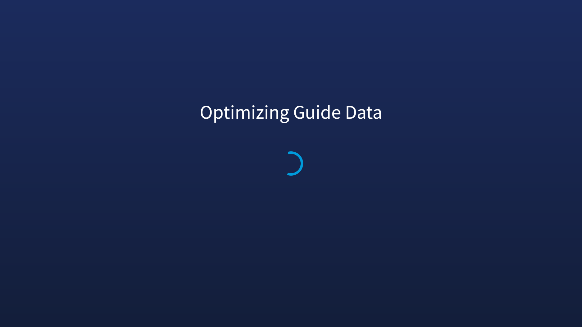

If you go to the Live TV Grid during maintenance, you'll see the following screen. It will only last for about five seconds before returning access to your Live View.
