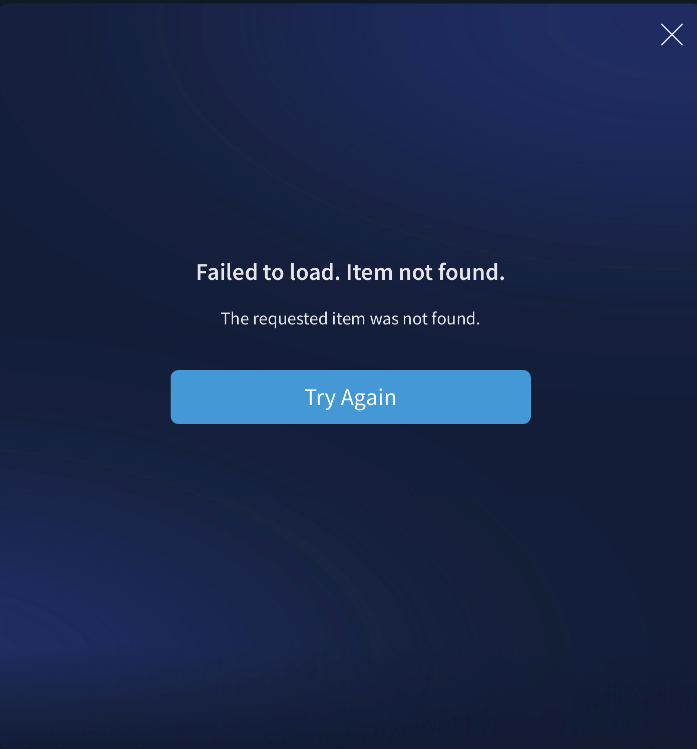

Rarely, navigating the Tablo app, you may encounter a Failed to Load error.
The error will usually display:
Failed to load. Item not found.
The requested item was not found.
Failed to schedule.
If TRY AGAIN fails, this is because something changed on the broadcaster's end that caused your guide to be out of sync. This should happen rarely and will happen more rarely in the future.
