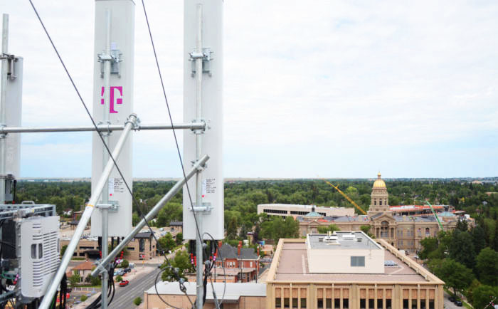

LTE Cell Towers
Traffic from nearby LTE cellular towers can also create invisible interference. Good quality TV tuners (like the ones in Tablo DVRs) and some antennas can have some built-in LTE filtering, but the addition of LTE filter antenna accessories can also help mitigate this.
