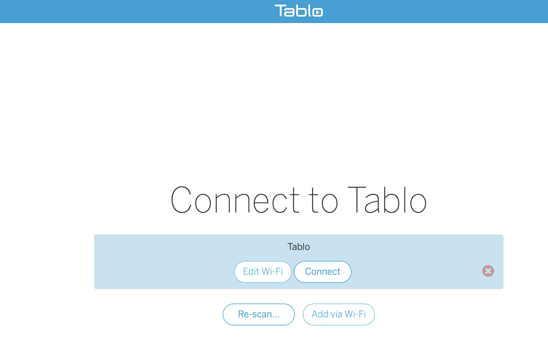

NOTE: The screenshots below are from the Tablo iOS app, for iPhones and iPads. However, you can also perform these steps using the Tablo web app at http://my.tablotv.com/ or the Tablo Android mobile app, by using the EDIT WI-FI button shown below.

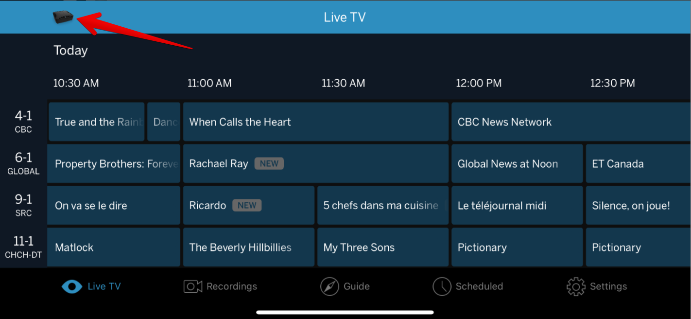

To edit your Tablo's W-Fi network, you first need to select the Tablo image in the top left corner.

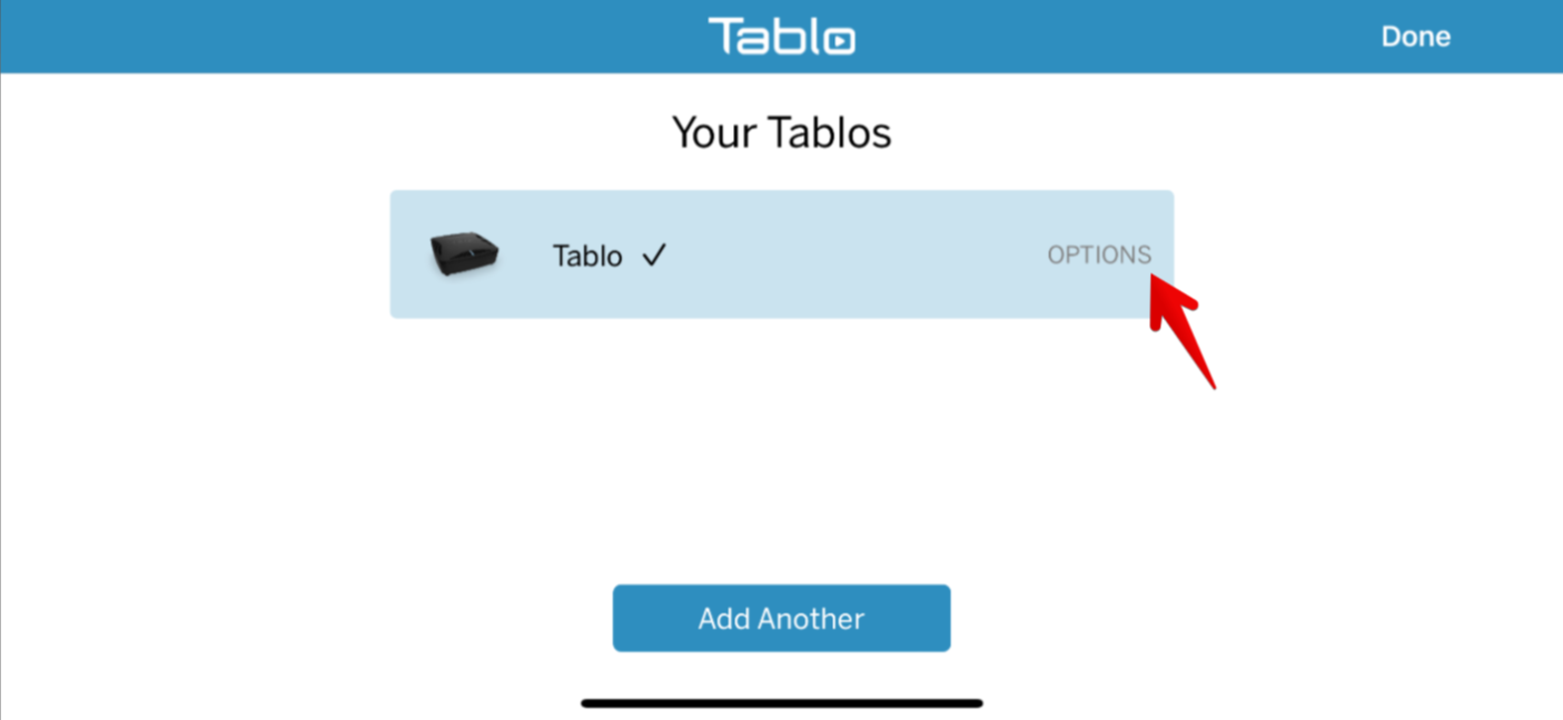

You'll be taken to a screen displaying your Tablo DVR(s). Select the OPTIONS button beside your Tablo's name. (This will say Tablo if you haven't opted to re-name your Tablo.)

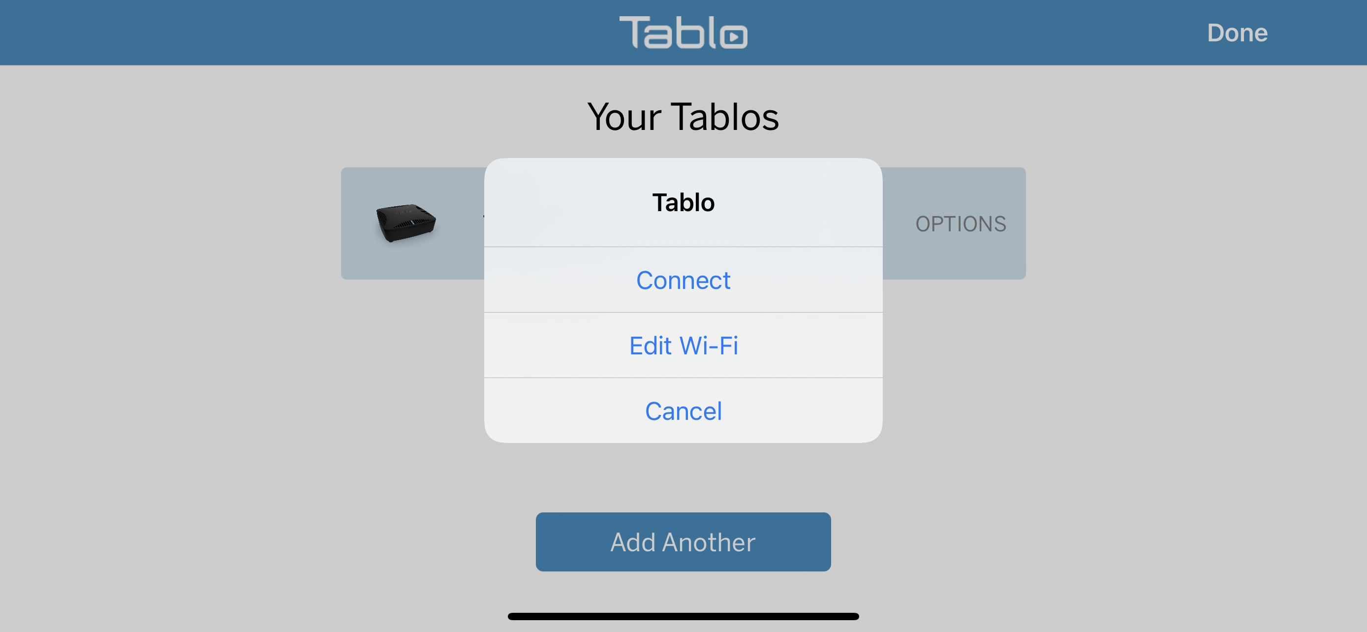

Select EDIT WI-FI from the options menu.

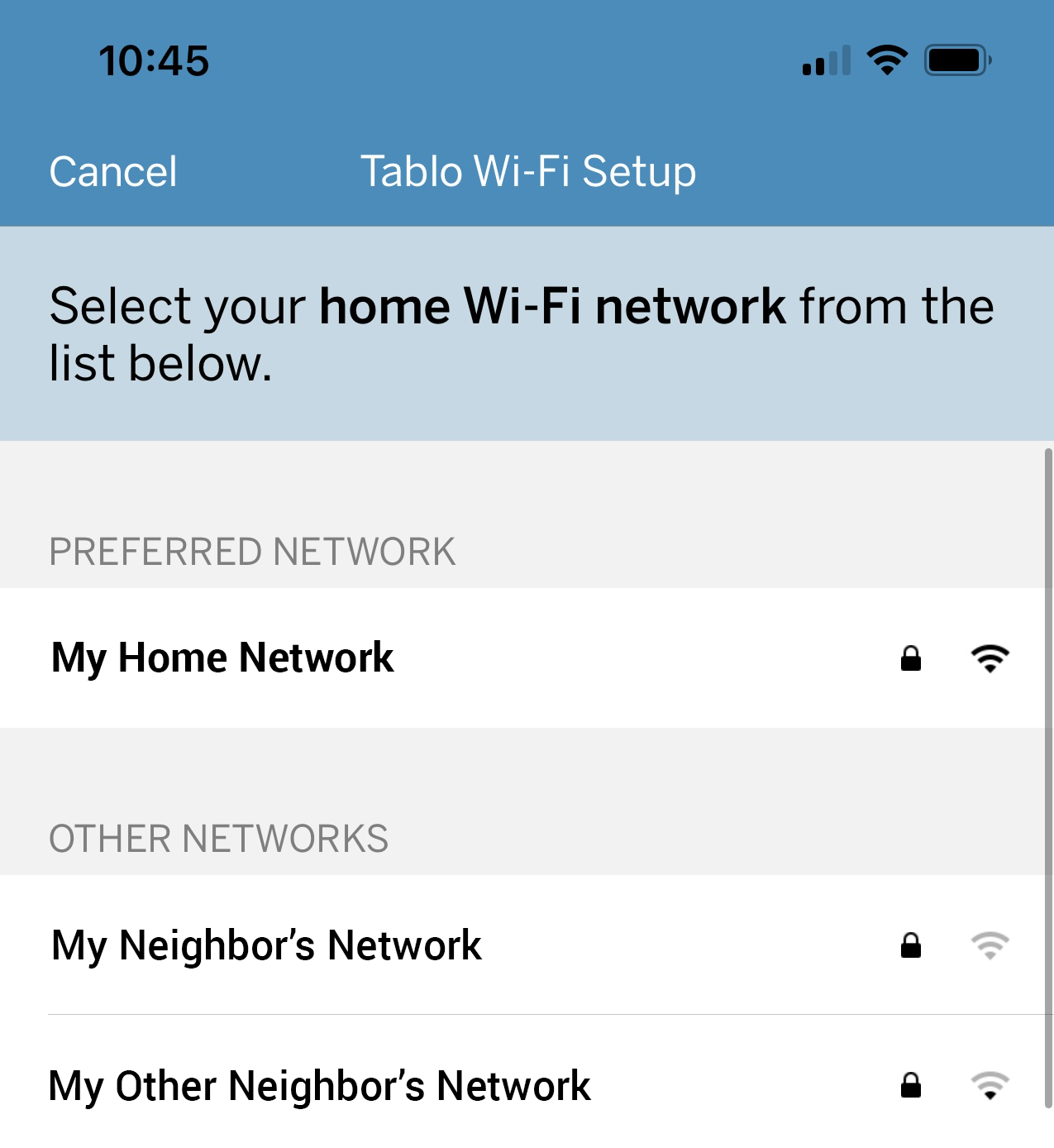

The Tablo app will search and display a list of available networks, here you can select your preferred network for the Tablo.

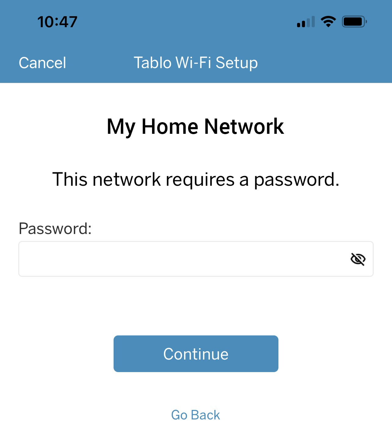

Once you select your preferred network, the app will prompt you to enter your Wi-Fi password.
STEP 6

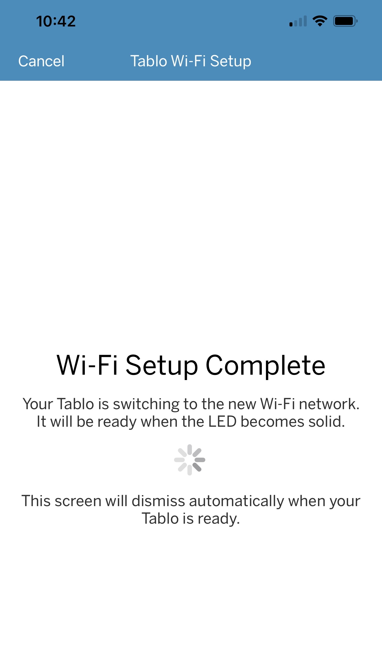

Once you have entered your password, the Tablo app will verify the Wi-Fi information. Once the setup is complete your Tablo's blue LED light will become solid.
Your Tablo will now be connected to its new home network.
