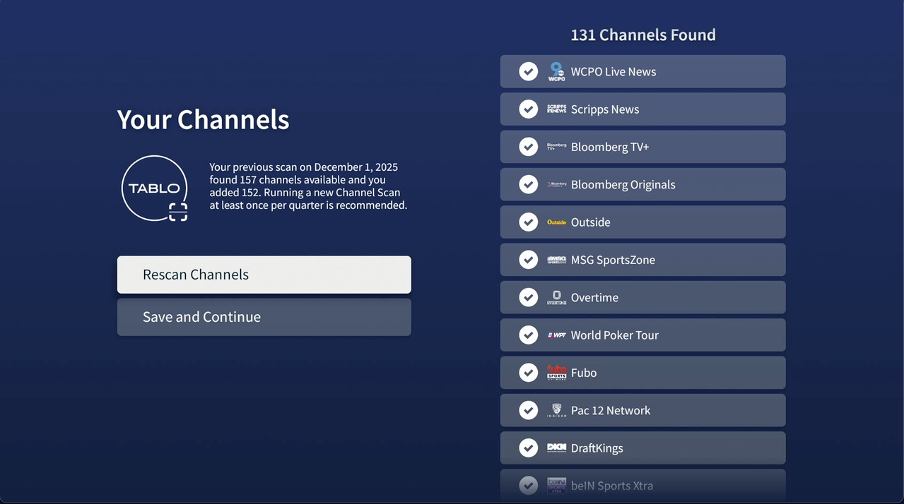

The example above shows a channel scan where only streaming channels have been found. Any over-the-air channels discovered during the scan would show at the top of the channel list and their assigned channel number (i.e.,11.1 CW) would be indicated.
During the setup of a Tablo DVR, you’ll be prompted to run a channel scan. This tells the Tablo to look for local broadcast channels available to your over-the-air TV antenna, as well as the free internet-based streaming channels included with the 4th Generation device.
