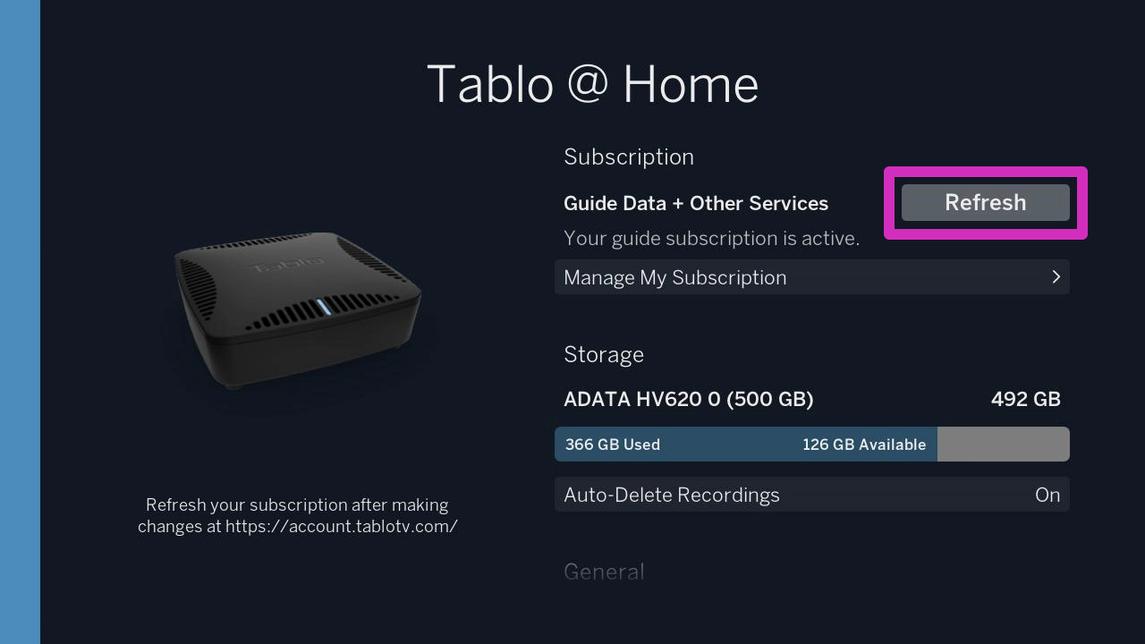

To immediately associate your active TV Guide Data Service with your Tablo, go to SETTINGS > SUBSCRIPTIONS > REFRESH in your Tablo menu. This will force your Tablo to check in with our servers and update its subscription status.

You can confirm this by navigating to SETTINGS > SUBSCRIPTION in your Tablo menu.
