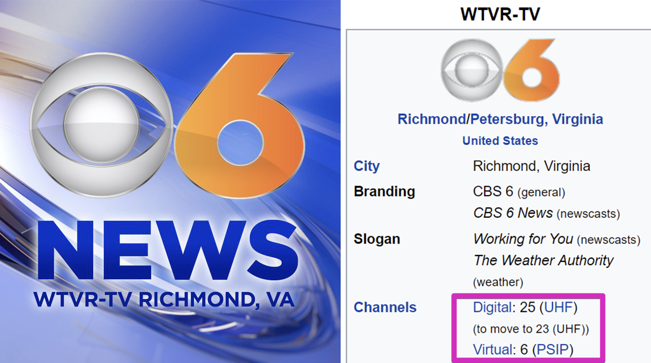

For example, channel 6 in Richmond, VA has a virtual channel (i.e., channel number) of 6 on your TV or Tablo DVR but is broadcast on a transmit channel of 25.

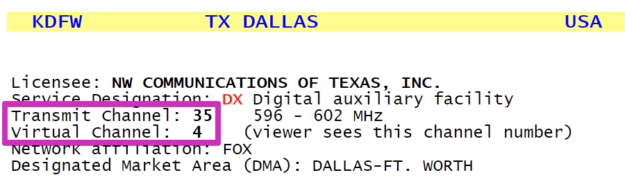

As you can see, FOX affiliate KDFW’s virtual channel is 4, but its transmit channel is 35, so you won’t need a VHF-capable TV antenna to receive it.

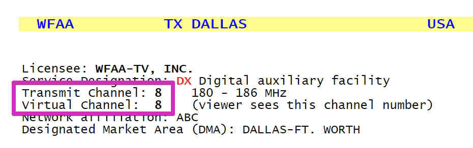

However, ABC affiliate WFAA has both a virtual and a transmit channel of 8, which is indeed on the VHF band, so you would need a VHF-capable TV antenna to receive it.

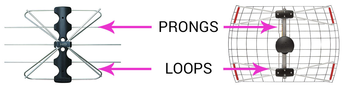

If there’s already a TV antenna mounted on your roof and you’re not sure what brand or style it is, antennas with VHF capability generally have long prongs and are quite large, whereas UHF-only antennas are slightly smaller and have shorter prongs or loops.
Most outdoor antennas will have both long and short prongs, or prongs and loops, and therefore will support both frequencies. However, TV fans with channels in the VHF low spectrum (2-6) may need an even more specialized antenna with very long prongs to receive those stations.
