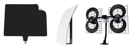

Today’s TV antennas range in cost from $20 to $200+ and come in several different form factors:
  • Flat Antennas: Are indoor antennas designed to be mounted in a window or on a wall
  • Table-Top Antennas: Can be as small as a paperback book, designed to be placed indoors on a flat surface near a window
  • Outdoor Antennas: Come in various styles and are typically mounted on your home’s roof, in your attic or on another structure like a pole or tower
