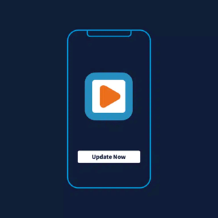

STEP 1 - Update Firmware
Using a legacy Tablo app, update the firmware on your legacy Tablo device to version 2.2.60
Users running firmware versions older than 2.2.58 will need to contact support for assistance.

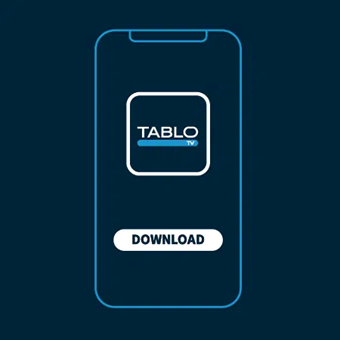

STEP 2 - Download the 4th Gen App
Download the 4th Generation Tablo app (dark blue) on your smartphone or tablet.
The next steps of the process are not available via legacy Tablo apps.

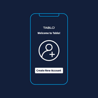

STEP 3 - Create Account
Create a NEW account using the 4th Generation Tablo app by selecting I'M NEW TO TABLO. You can reuse the same username and password from your legacy Tablo subscription account, but your credentials won’t be recognized automatically.
