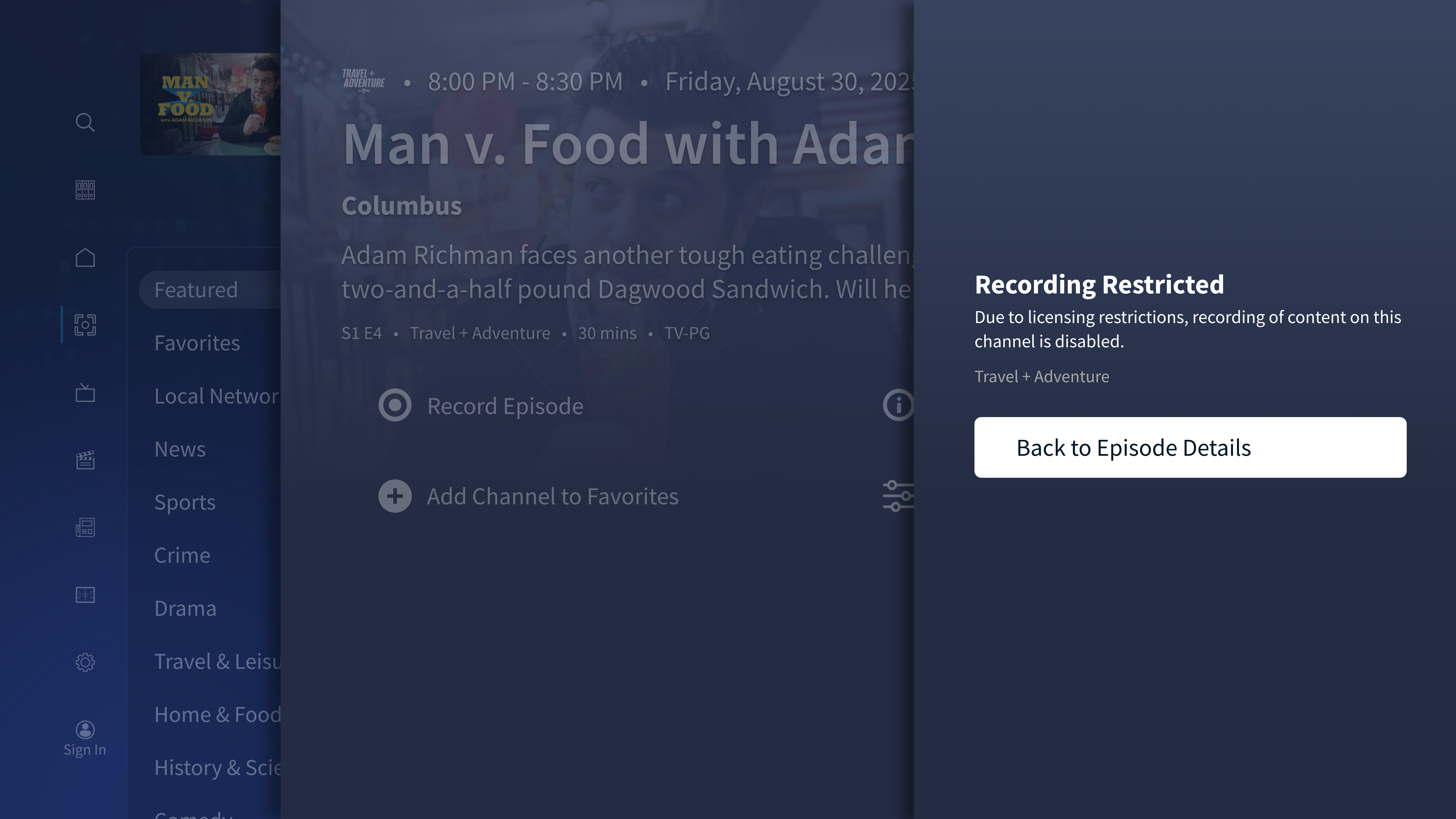

When you attempt to schedule a program on a recording-restricted channel, you’ll see the following message:
Recording Restricted
Due to licensing restrictions, the recording of content on this channel is disabled.

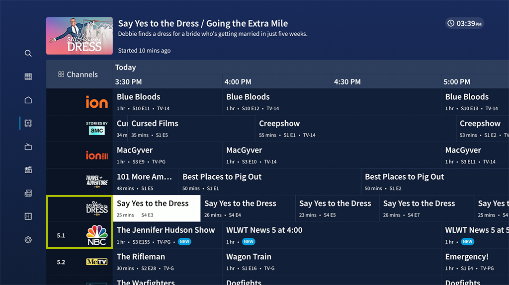

  • Channels with numbers in Tablo’s live TV grid (like NBC) are pulled in over-the-air from your TV antenna. There are no restrictions on recording OTA TV programs or channels with Tablo.
  • Channels not numbered in Tablo’s live TV grid (like Say Yes to the Dress) are internet-based free streaming channels. Only those that are restricted will display an error message when you try to set a recording.
