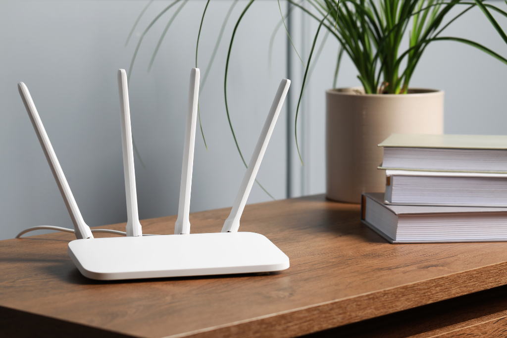

When it comes to internal home network (LAN) speeds, a home Wi-Fi router with a minimum throughput of 100 Mbps is required.
Thankfully, Wi-Fi router technology has improved dramatically many affordable Wi-Fi routers support well over 100 Mbps and modern 5 GHz or 6 GHz Wi-Fi can often handle significantly higher throughput.
If you haven't updated your router in the past 5-7 years, switching to a newer model can dramatically improve your experience with all of your internet-connected devices, including Tablo.
When you purchase a router, take a close look at both Ethernet and wireless speed. Both should match or exceed the bandwidth of your external internet service.
