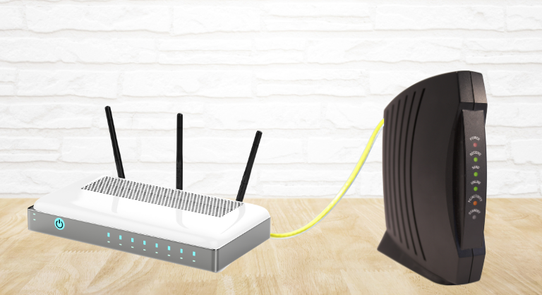

Use Your Own Router
If you rent your router from your internet service provider, the technology is likely older and slower. Devices that combine routers and modems also offer poor Wi-Fi coverage, often leaving 'dead zones' where an adequate Wi-Fi signal doesn't reach.
Additionally, with rental fees averaging $10-$15 per month, it's often more cost-effective to buy your router. Make sure to check with your ISP before choosing a new router, as they may specify which ones are compatible.
Your router's throughput speed should match or exceed the internet speed you pay for from your ISP. For example, if your internet service has a maximum download speed of 300 Mbps, you should purchase a router at least that fast.
If your ISP requires you use one of their routers, but you still want more control over your home network, you can sometimes enable a wireless bridge mode between the two devices.

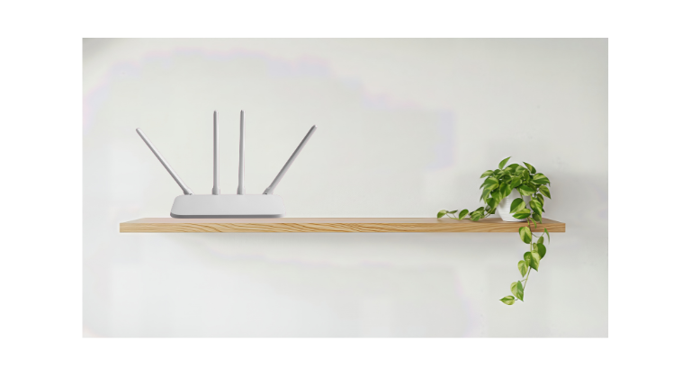

Find the Best Place for Your Router
While most Wi-Fi routers won’t win any awards for being beautiful, you should resist the urge to hide it away. To get the best performance from your router, it should be as high as possible in a central location in your house, away from obstructions.
Proper placement should help ensure that there are no locations in your home where the Wi-Fi signal is too weak or doesn't reach at all.

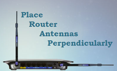

Adjust the Antennas
If you think all of your router’s antennas should be pointing up for the best reception, think again. According to those in the know, it’s actually best to have one pointing up and the other pointing horizontally as the Wi-Fi antennas on your devices, like your smartphone or streaming stick, can have differing orientations.

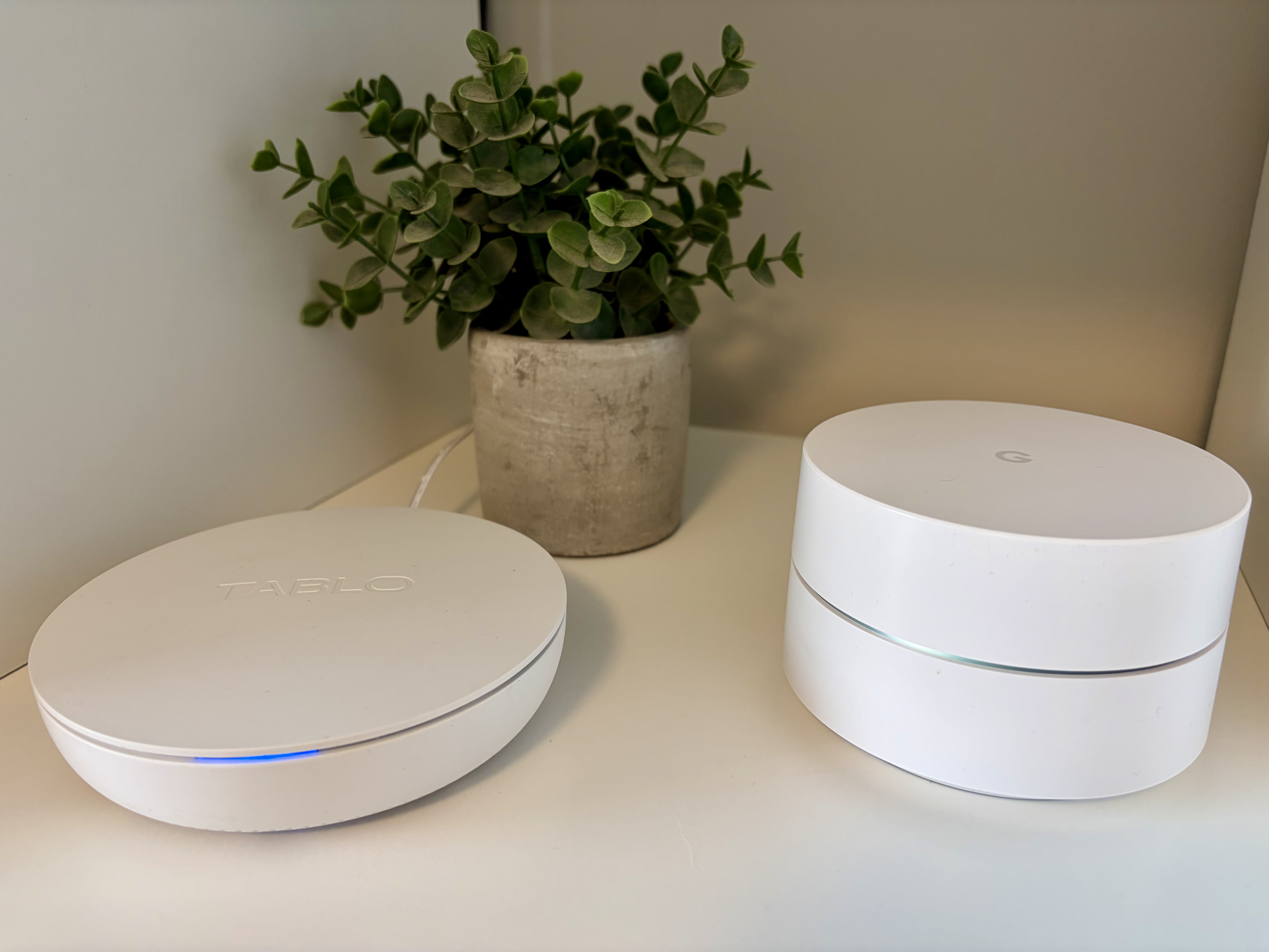

About Mesh Networks
Mesh network routers have multiple wireless hubs that share the same SSID, aka network name. This allows your internet-connected devices to seamlessly jump between access points if the Wi-Fi signal degrades or as the device moves through your home.
While this ability is great for surfing the web on your tablet as you wander between your kitchen and your bedroom, if your streaming TV device is frequently hopping between hubs, it can cause video streams to pause and buffer.
To reduce this risk, connect your Tablo, smart TV, or streaming device directly to one of the mesh network's hubs via Ethernet. If a direct connection isn't possible, place the Tablo and/or streaming device about a foot away from the nearest hub. Placing a gadget any closer to a wireless access point or router risks creating interference between the devices.
