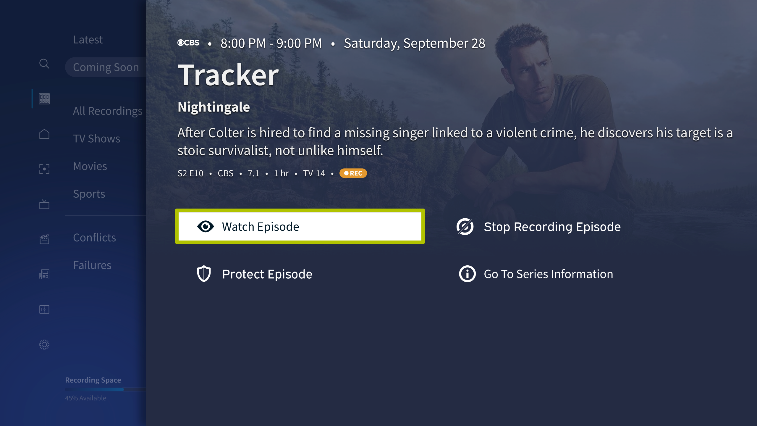

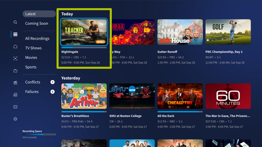

Within seconds of the start of a recording, you can begin playback of an in-progress recording from the LIBRARY screen.
When you select the recording, select WATCH EPISODE.
Playback will begin at the start of the recording via Tablo apps on Roku, Amazon Fire TV, Android TV, Samsung smart TVs and LG smart TVs.
