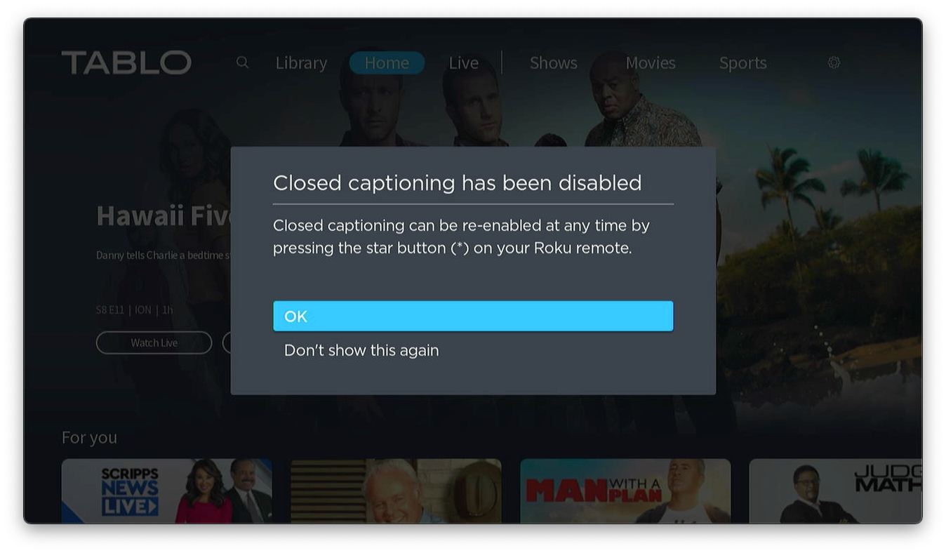

Once you have updated the 4th Generation Tablo app on your Roku to version # 0.8.500, a new dialog box will appear on your screen after this type of memory-related crash has been detected.
The dialogue will ask if you'd like to disable closed captioning to avoid crashes on your Roku.
If you select YES, this will prevent the closed captioning track from reaching your Roku player software, which will eliminate the source of the memory-related crash.
Closed captioning can be re-enabled at any time by pressing the star (*) button on your Roku remote; however, this will likely result in the return of the memory-related crash until Roku can provide a fix.
