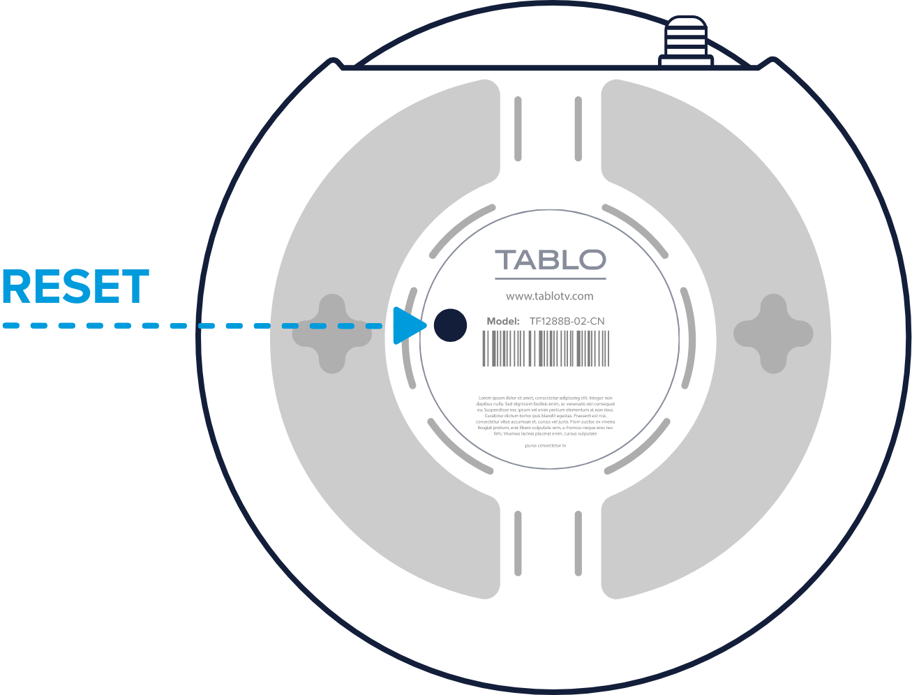

  2. Make sure your Tablo's blue LED is solid. Hold down the white reset button on the bottom of the unit for 7+ seconds. The blue LED on the front of the Tablo DVR will begin to flash faster and faster. Once it again turns solid, the Tablo will begin to factory reset. At this point, you can release the white reset button.
