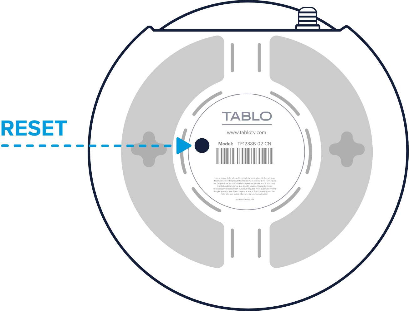

  1.  Reboot your Tablo DVR by tapping and immediately releasing the white reset button on the bottom of your device. Let the Tablo boot up for ~1 minute. The reboot is complete once the blue LED stops flashing.
  2. Remove the USB hard drive from the back of the Tablo DVR. Do not reattach your hard drive until after you have completed Step 7 of this walkthrough.
  3. Reboot the Tablo DVR again by tapping and immediately releasing the white reset button on the bottom of the unit. Again, wait ~1 minute for the Tablo to boot up. Wait for the blue LED to stop flashing.
  4. Open the mobile Tablo app on your iOS or Android device. Select the USER PREFERENCES button on the top right of the application and then select the SIGN OUT button below your profile. If you are not able to access this screen on the Tablo mobile app, uninstall and then reinstall the app.
  5. Make sure your Tablo's blue LED is solid. Hold down the white reset button on the bottom of the unit for 7+ seconds. The blue LED on the front of the Tablo DVR will begin to flash faster and faster. Once it again turns solid, the Tablo will begin to factory reset. At this point, you can release the white reset button.
