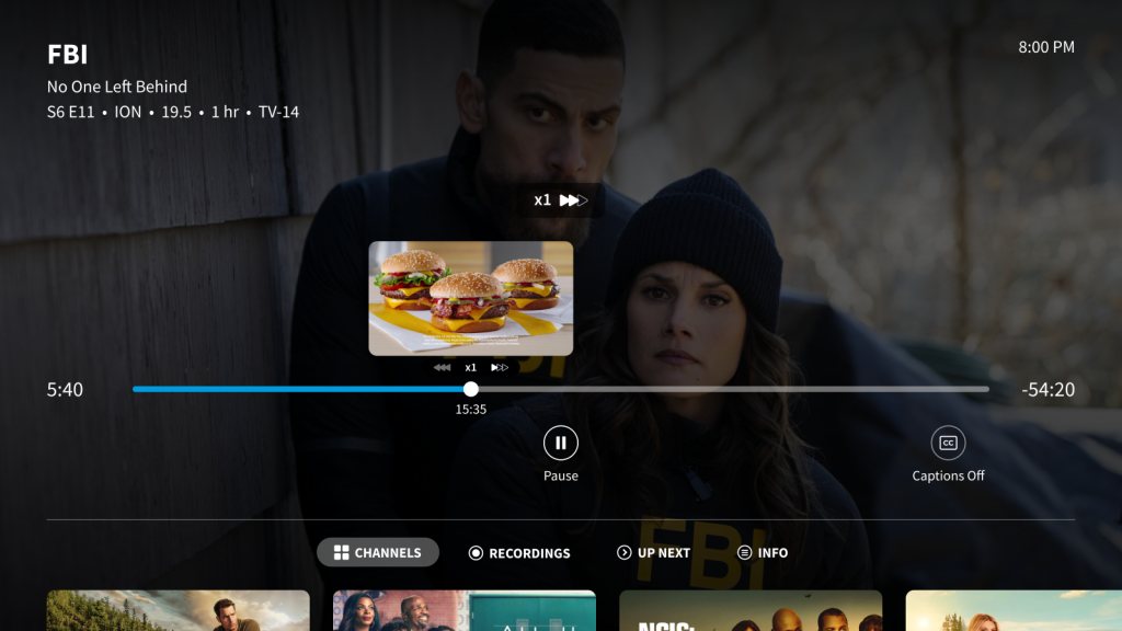

Fast-Forward Preview thumbnails are supported by all Tablo applications except iOS devices (iPhones and iPads).
Thumbnail images are created after the recording is completed. On legacy Tablo devices, this is done by re-processing the recording using one of Tablo’s available tuners. That function is done in the background on 4th Generation Tablo devices without requiring a tuner.
Either way, this additional processing means Live TV and in-progress recordings will not have any Fast-Forward Previews.
An hour-long recording should show Fast-Forward Previews approximately four minutes after the recording has finished. Longer recordings will require additional time for processing.
If multiple recordings finish at the same time, these will be processed sequentially, and it may take longer for Fast-Forward Previews to appear.
Legacy Tablo users could see additional delays while the device waits for an available tuner.
